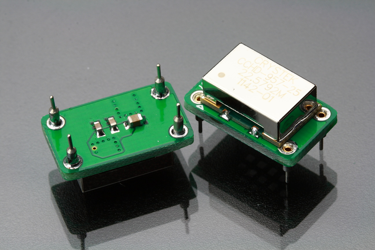

With Ians SMD adapter boards there are 3 bypass caps on the underside of the board, where do these go if the XO is fitted direct to the FIFO board ?
It was said that the decoupling caps underneath the mainboard would be sufficient if the clock gets soldered right to the board.
I think the idea behind the decoupling on the adapter boards is to address
the potentially negative impact of the socket/adapter combo.

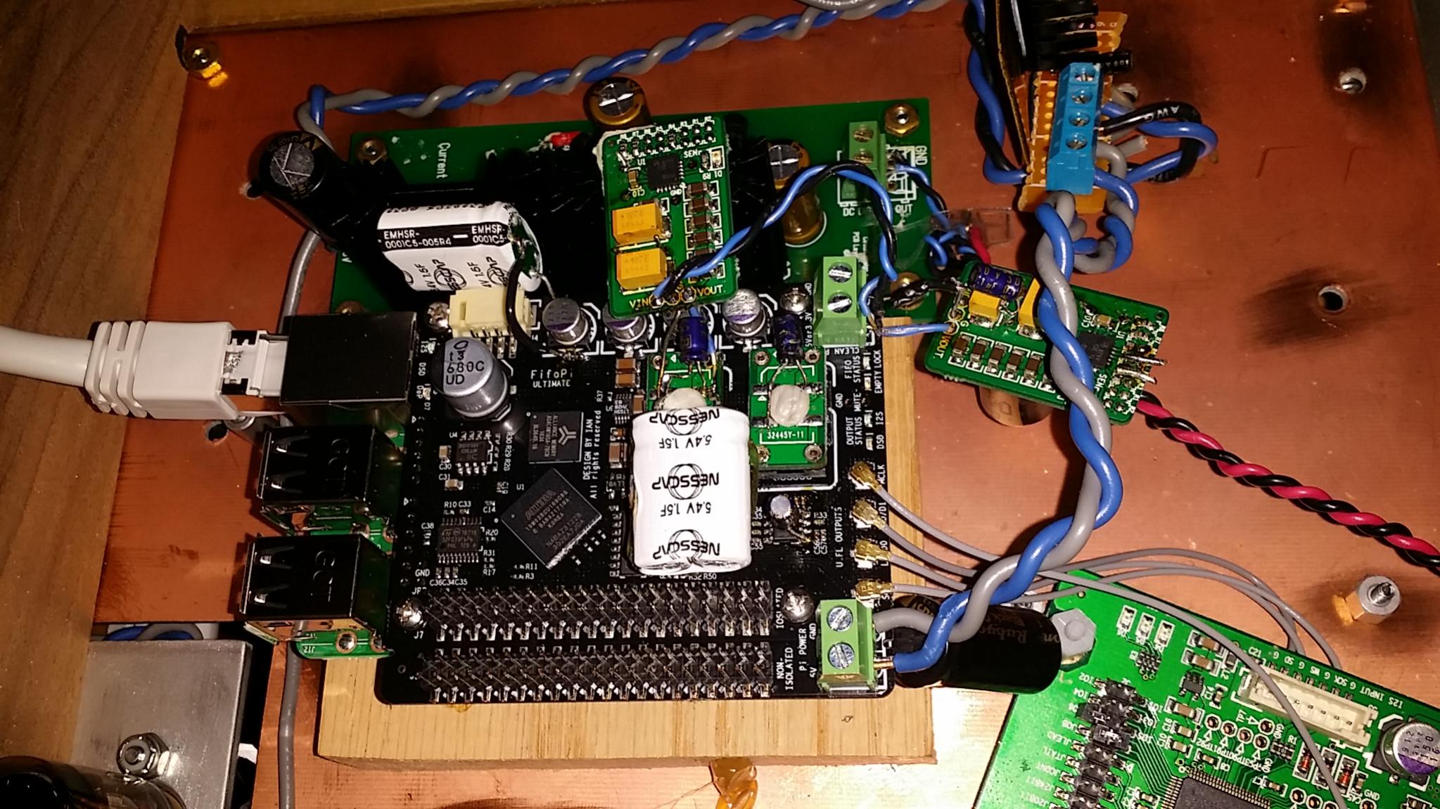

cap and supercap roundup
Since I have advocated a few cap options, I thought it useful to sum up where I landed and what are my impressions wrt cap additions to the FIFO Pi.
Per pic below, I am running with the following cap adds. I am not an engineer and do not have the patience to try every permutation and combination, so likely there is a more optimal set, but this is what works for me.
1. 1.5F 5.4v Nesscap supercap - 69mOhm on the FIFOPi cap rail. I believe that this rail is on the supply side of the onboard reg. It added all the audiophool adjectives well summarized on the UptoneAudio LP1 site. In summary a big increase in detail and dynamic punch across the freq band.
2. 1.5F cap directly on the power pin of the 45mHz clock. It has its own PS. This one is debatable. When I installed it, it added more of the same I saw in #1. But now, if I play a 192k tune, and then a 45k copy of the same (converted with Dbpower) it is not dramatically better. I prefer the version played on the 45mHz clock, but not by a lot. I guess that is significant that I do prefer the 45k version given it is lower resolution, and has been resampled, but it is not a big difference. It means I will one day be happy with just one 45m clock installed, and play everything at redbook speed.
3. I have 2 cap changes on each of the clock adapters. I replaced the 3 ceramic caps with one .68uF FCA cap, and added a .47uF BG HiQ cap. To my ear this is a minor but important change to eliminate some harsh sounds in the upper notes.
4. I added a 25F supercap to an already well sorted linear supply to the dirty side of FIFO. After 3 days of burn in torcher, the sound was improved and excellent. BUT, I ultimately removed it as it caused too much trouble to reboot the Pi when necessary.
5. I replaced the Pi supply supercap with a 100u BG F cap. It brought back some of the sound quality without the reboot issues and will stay. It just verifies in my mind that the Pi power is almost as important to other supplies.
5. I added a 1.5F supercap to the power rails of Ian's I2stoPCM board, bypassed with a BG HiQ .47u cap. This brought a surprising increase in dynamic slam, and clarity in the upper registers. Even after burnin the cymbals were well defined but still lacking in perfect realism.
6. Final add was a nice bit of magic. In this case I added another BG HiQ .47uF cap to pins 1 & 4 (VCC and Grnd) of the 533 output buffer. I believe that this IC creates Mclk signal. It really cleaned up final smearing of sound and made cymbals sound like the real deal.
In all cases that I refer to BG caps, I think that your digital PS cap of choice would be fine. I simply have a supply of these things and like the impact they have particularly around digital circuits. So I use them.
So that is it. Again, my focus is in and around the FIFO, because in my case it feeds an R2R dac that is as sorted as I can make it. I feel that the I2S signal is THE source. Everything downstream needs to be good (everything matters), but I am amazed at how much more impact the source signal has to other downstream elements. It may be that in my case the downstream elements had years of tuning and were ready to sing if only given a better source.
Hope this gives some ideas to others on this journey.
Again very grateful to Ian. My system has never been this good, and it seems pretty bullet proof.

So you used two 0.1u (100n) and one 1u caps behind the adapter board?I decided to use the adapter boards with the 3 caps underneath for my NDK SDA, immediate improvement, sounds great.
The components came with the adapter boards, I just soldered them on. Just tried to measure one but it is now lost forever, all 3 are the same value though.
This is an early picture of Ians.
The new black adapter board for the Crystek XO's has 2 caps on the top and 7 under the board, different values top and bottom.
