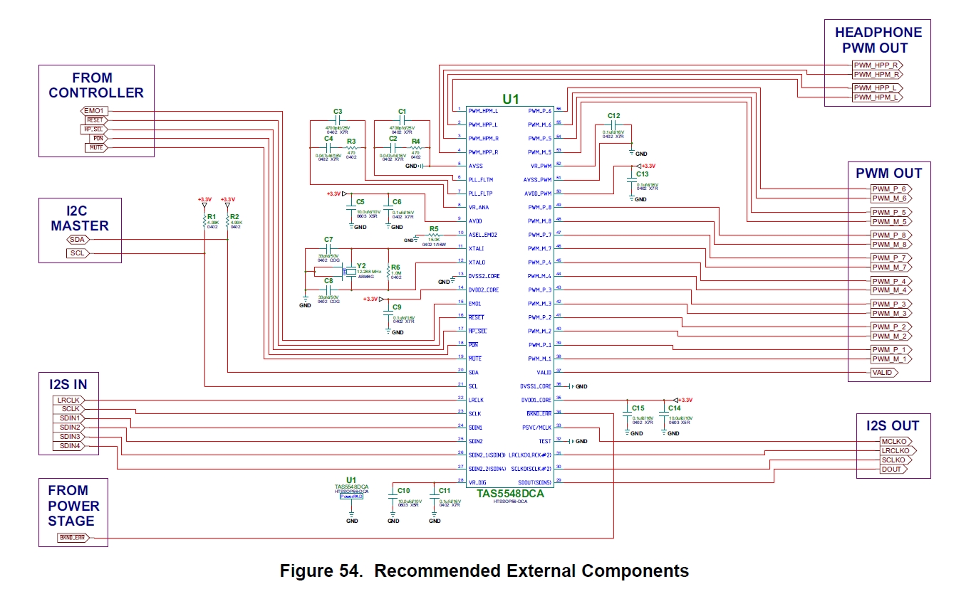

If I use Ians FIFO-project (need 8 channels input and output), use his LVDS , then there is the XO from the FIFO and a clock at the end of the line: DAC or DigitalAmp like I-AM-D.
Could someone please show me or link me to the way how to arrange a "one clock" soloution for this?
There could be a DAC - which? - (I would use 2x4 channels) or better something like the TI-Amp (above). Is there a Ian-DAC, timing with his FIFO-LVDS-project? Or how could this be down with an TI-Amp?

I.e. the I-AM-D with TI TAS5548 should be able to use another clock: "I2S Master Mode When Used With External Crystal" from this spec .
Could this work (4 stereo amps) with Ians FIFO?

Yes. Thank you. Could you please tell me, where to go in - using McFIFO and McDualXO (master)?
Attached the TI spec for TAS5548, page 107.
From the TAS 5548 spec: "The external crystal used must be 12.288 MHz"
From Ian's McDualXOmanual.pdf: 12.288 only supported up to 96 KHz.
So this is not usable ... 🙁

If you won't be using DSD you can connect 4 stereo DACs to the McDualXO outputs and any DAC that can do synchronous mode (meaning accept external MCLK instead of using on-board XO) will work.

Install 24.576M XO on FIFO and use any kind of clock divider to get 12.288Mhz out of it. A simple flip-flop will do the job. Perhaps you need to convert everything to 48K/96K/192K so that you can keep 12.288Mhz output all the time.

...but it will increase jitter.
True, but I don't think it matters. The 12Mhz input clock is merely for internal logics. After all, the DAC relies on PLL for clock recovery. In other words, you get less benefit from Ian's FIFO.
