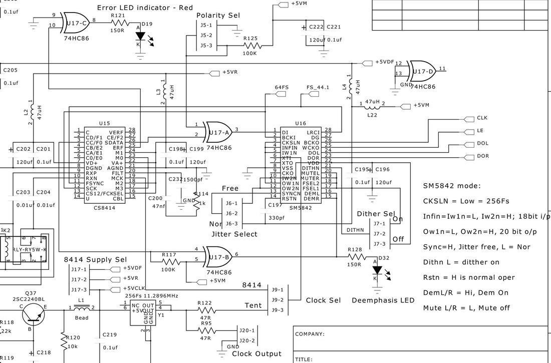

@samoloke
You can,
And you can also add a re-clock flip-flops stage between SM5842 and your PCM63 / PCM1702 / PCM1704 by FIFO MCLK for better performance.
You can use stereo I2S FIFO for your application.
Ian
Ian
thank you for reply
attached Is dac I use with exception of receiver which Is CS8412 and that DF Is SM5841APT
would you please advise optimal setup to purchase from you
do I need to order other than stereo FIFO I2S like other receiver part, XO, etc
here Is CS8412 description http://phonoclone.com/pdf/cs8411.pdf
BTW Is stereo FIFO I2S other hardware than first version but with updated firmware
