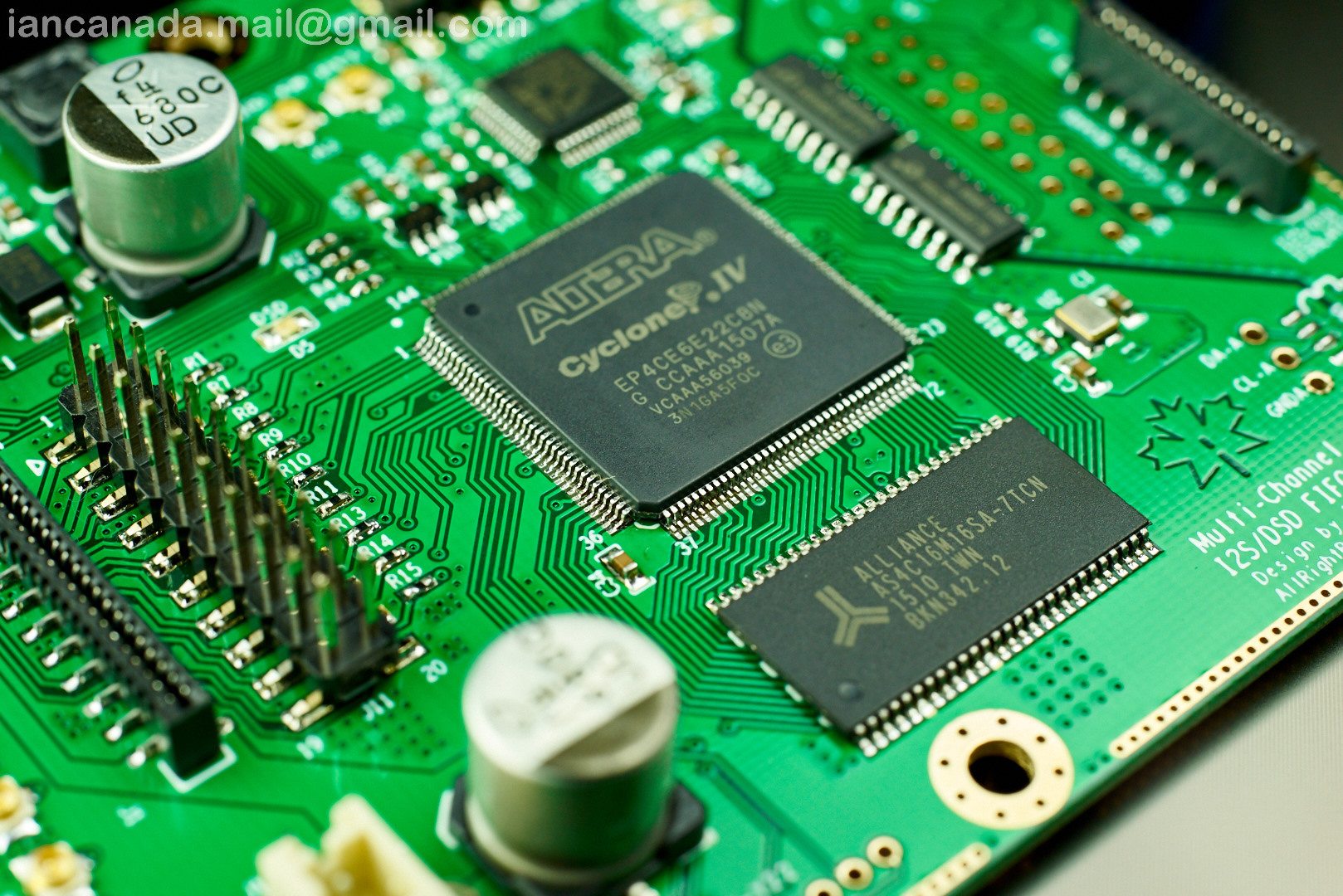

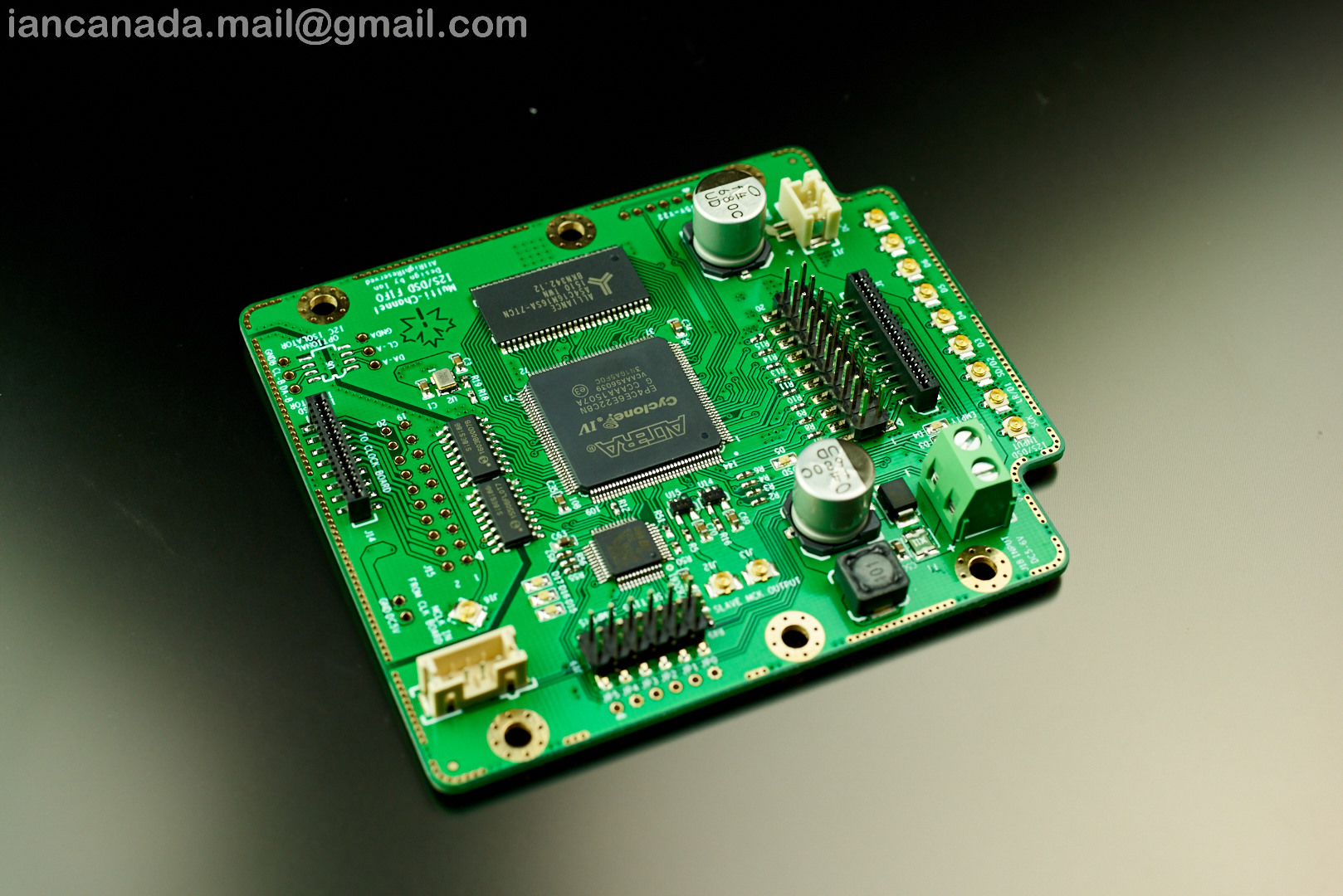

Multi-channel I2S/DSD FIFO KIT is coming
Please see pictures for more details.
More updates will be posted soon.
Ian

Question about placement of MC FIFO in signal chain. With it being multi channel, the FIFO could be placed between a DSP and its serial output to DAC/DACs. Would this be most beneficial? Or would it be better of between a multichannel i2s source and the multichannel serial inputs to the DSP?
Another question about the MC XO. How many MCLK outputs will be available or supported? Say for example wanting the same high quality external MCLK for a DIR/ASRC, DSP, and up to four two channel DACs. Being able to have the same MCLK would be best correct. Any suggestions?
Colin
Yes, for multi-channel I2S/DSD FIFO, we can no longer use two channels clock board.
New multi-channel clock board will be introduced very soon.
Ian
