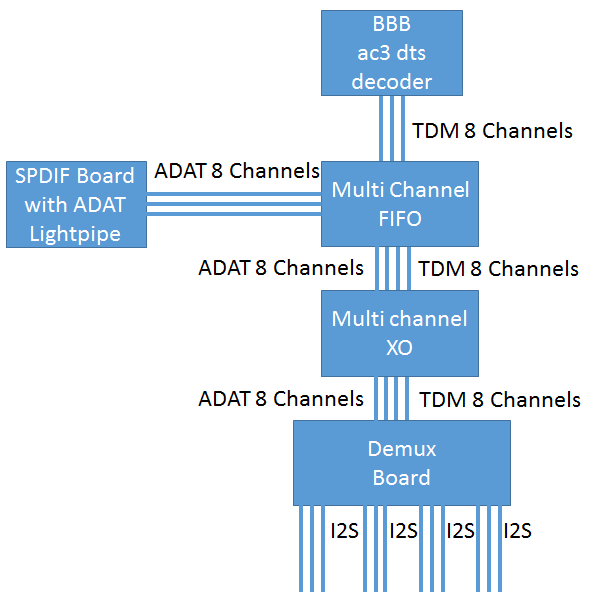

TDM ADAT multi channel demux
After sleeping over the idea I think some kind of demux board would be necessary. Here is the idea.
This hackaday project https://hackaday.io/project/9634-linux-based-low-latency-multichannel-audio-system extends Beaglebone sound drivers to support 8 channels TDM multiplexed output. Here is some more info on the TDM format https://e2e.ti.com/support/arm/sitara_arm/f/791/t/307825 See last comment. It would not take long for other SBCs to support TDM output. XMOS chip has I2S_MODE_TDM support as well.
Now the idea is to use ac3/dts decoder on BBB to decode ac3/dts to 6 PCM channels, then send them TDM-multiplexed to FIFO and then have them demuxed by a demux board to separate I2S channels. Another use case is a multi room application having 4 stereo channels from BBB or xmos USB->TDM board.
I2S outputs from demux board can be used to connect to BIII, or even multiple I2S2PCM boards to drive legacy stereo DACs.
Another use case could be to demux ADAT Lightpipe 8 channels optical input to I2S outputs. This requires an update to SPDIF board or a separate TOSLINK board with ADAT Lightpipe support.
It sounds like re-mapping function. Can you give me some more details about this requirement?
Ian
