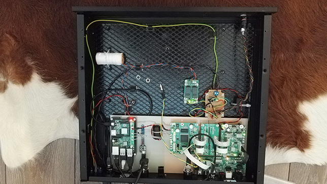

Result... im not the best at drilling big holes in steel. But the sound is great 🙂
🙂 Cool !
WHat was finally the problem you debugged ?
You did good job. Congratulations!
Ian

🙂 Cool !
Cheers 🙂
The issue was one of the initial clocks (that drives most of the audio on my NAS) was broken. It was that simple 🙂 but hard to debug. It was by accident that I upsampled everything with Volumio, that it started working (using the other clock).
Ian
Thanks! The result is awesome, thanks to your awesome work 🙂
