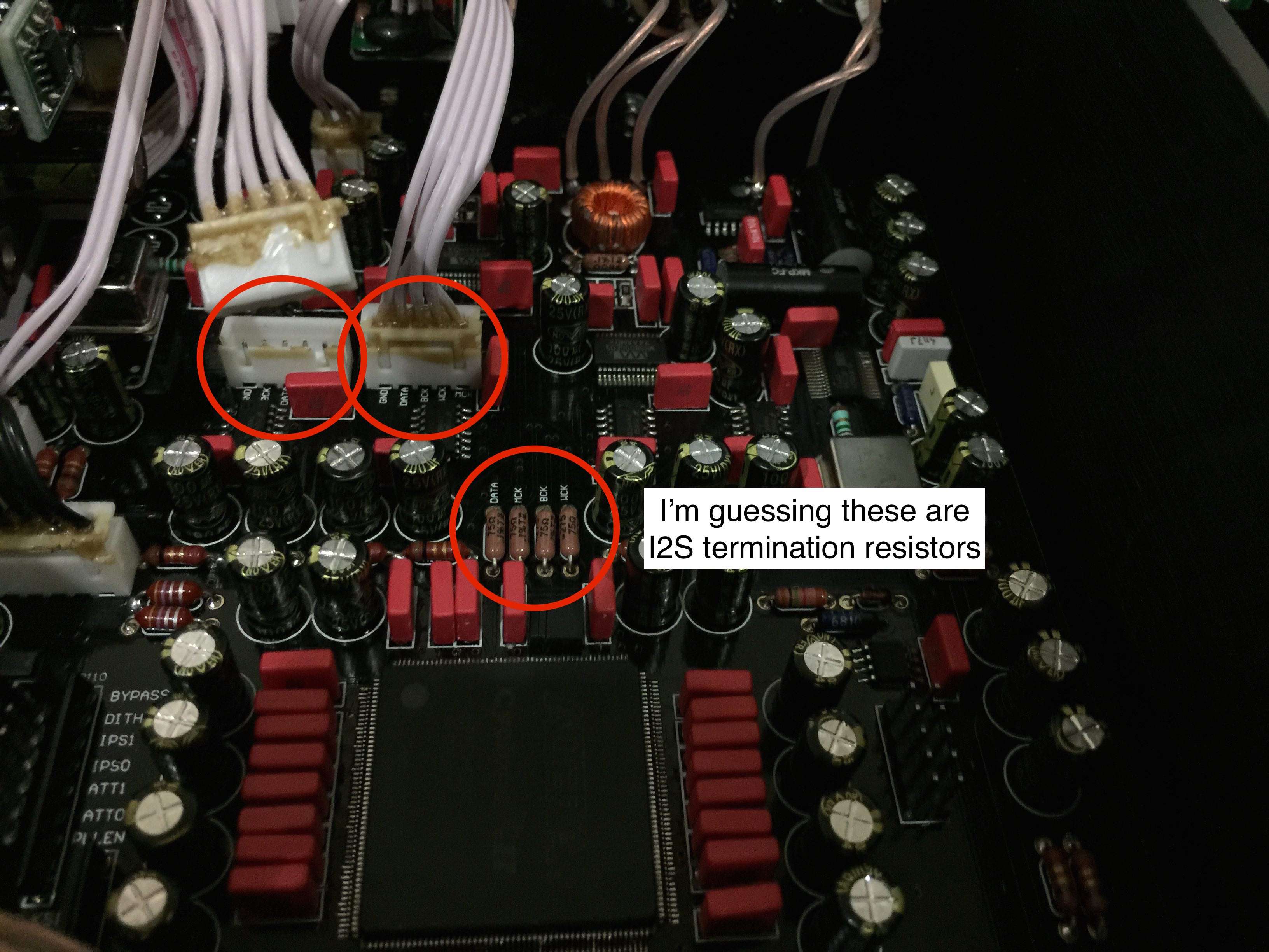

Hey Ian, I think I'll receive the FIFO early next week (very excited!) but I have a couple of quick questions - Do I need to worry about termination resistors at my DAC for the I2S signal terminations?
My DAC has 2 x I2S inputs on its main board, via 5-pin JST connectors. I think only one of these connectors has 75 ohm termination resistors and the other does not. Photo below.
Also, I'll need to terminate the MCLK signal into the connector at the DAC - Do you see any issues with me cutting the 6" U.FL coaxial cable coax to the same length as the 4” double-ended PH 2.0 mm 7-pin I2S bridge cable and terminating it with a JST crimp lug?

Hi aive,
All signals from Ian FIFO KIT are already 50ohm source terminated. You don't need any termination resistor at your DAC input. Even for the MCLK signal. Please no worry at all.
After reviewing your picture, I don't think those 75ohm resistors have business with any of your I2S inputs.
Please keep in mind, don't share same signal with more than one input. Dual XO II has two groups of output. You should have enough to use.
Good weekend.
Ian
