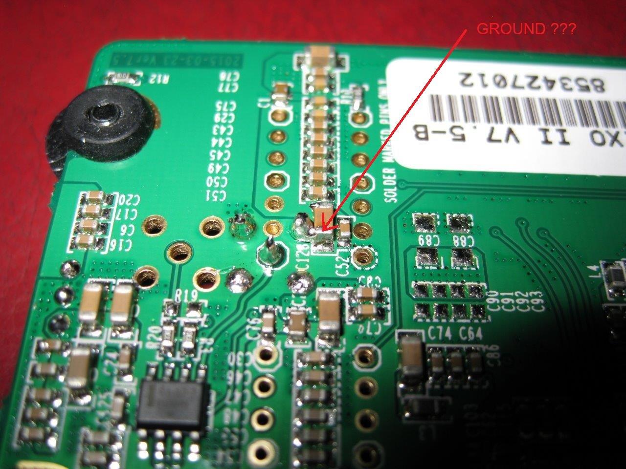

Dual clock board II
Would someone be so kind to check if capacitor connection shown at attachment is tied to ground? I installed a SMA connector and one leg soldered with near capacitor...
It looks to be ground, so I'd prefer not to remove tin, but I need to be 100% sure!
