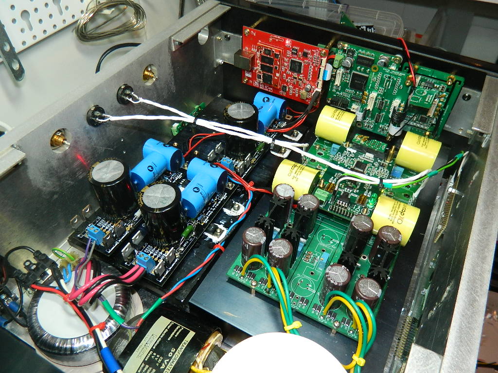

I need help 🙂 I understand how to select the frequency 98xxx and 90xxx XO570. But how do I select 2048Fs, 1024Fs, 512Fs, 256Fs? To me it is always lit LED 512Fs.

The Si570 guide that Ian wrote has the instructions 🙂
The *Fs will change depending on the input data rate. See the group definitions for what to expect. If you have 512Fs you will have 176.x and 192kHz ...

hochopeper gave perfect answer.
Yes, *Fs is decide by the selected MCLK and the the Fs of your music. *Fs is not a selectable setting.
For example, if you select 98.304Mhz as MCLK, and you are playing 96KHz music, so the *Fs is determined to be 98.304Mhz/96KHz =1024*Fs.
