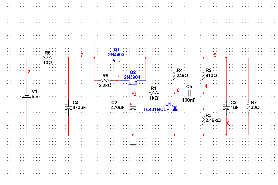

Simulating Demian’s regulator
Demian posted a low noise regulator here: http://www.diyaudio.com/forums/digital-line-level/192465-asynchronous-i2s-fifo-project-ultimate-weapon-fight-jitter-11.html, which was specialized for powering the oscillators.

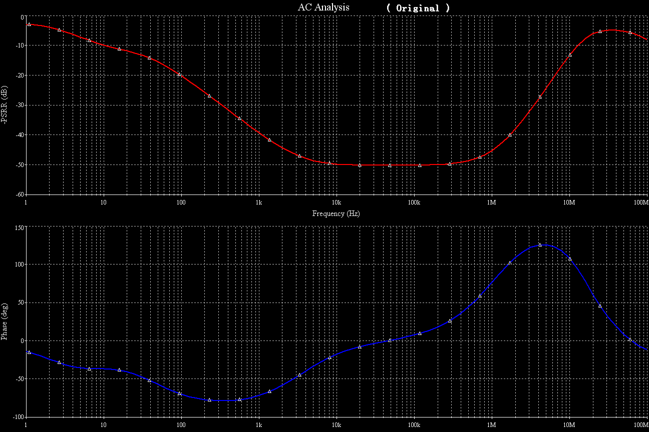

I did some quick simulation yesterday. I was mainly focused on PSRR simulation. I don’t expect the load response performance because of the LPF on the feedback pass.
1. The first simulation shows the PSRR was 1dB at 1Hz and 10dB at 10Hz. The voltage drops on Q1 was too low and Sziklai pair didn’t run at optimized range.

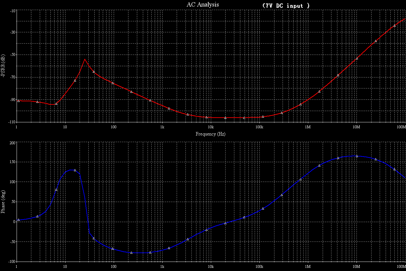

2. I raised the DC input to 7V, see the second simulation, the PSRR went 90dB at 1Hz, very good low range. However, it dropped to 52dB around 12Hz. There might be a pole.
3. I remove C5, see the third simulation. We got perfect PSRR, greater than 80dB throughout 1Hz to 1.1 MHz.

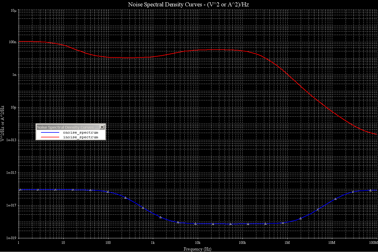

4. I got the noise simulation spectrums, yes, it’s very low.

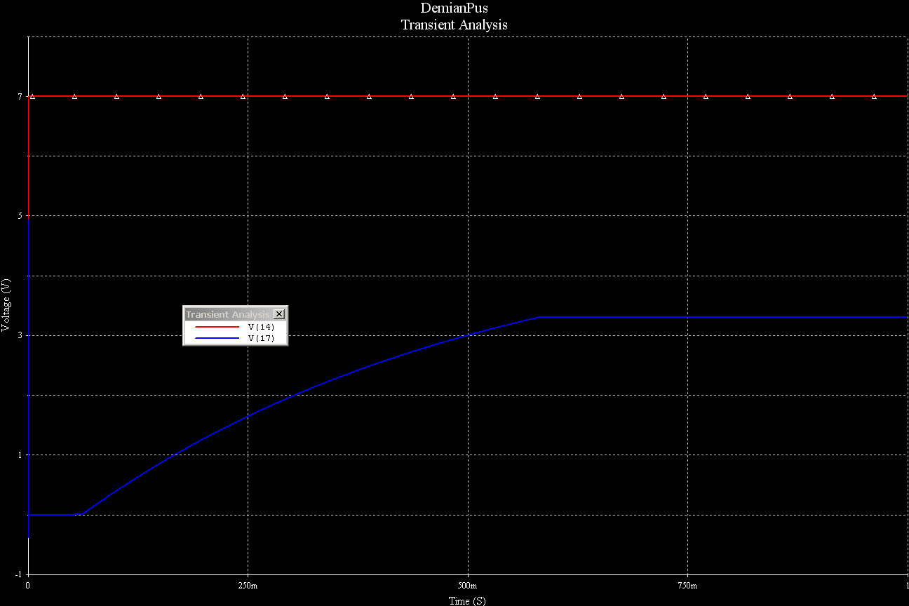

5. The power up time was 600ms, any way, we need making some compromise.

1. The main noise contribution would be the input, especially for the high frequency noise, because the PSRR start dropping below 60dB from 6 MHz.
2. Only suitable for static load (resistor load). The LPF corner frequency is too low.
3. Be careful the low frequency (below LPF) 1/f noise from voltage reference, I don't think it was included in the SPICE model.

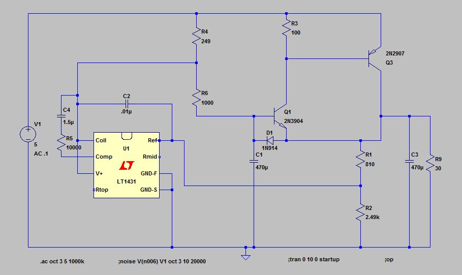

The model for the TL431 will oscillate at low frequencies if C5 is less than 20 uF if present. The actual part in this application shows no signs of oscillation. The model is not fully representative of the part. It might be better to think of the TL431 as a servo steering the output voltage to the target. The circuit works fine with a resistor divider for the reference voltage, but won't compensate for line, load and thermal effects.
It does work well with a 5V input. I'm surprised you are getting different results. It may be the TL431 model. I can assure you it works pretty well when built with the parts as shown. I'll play with the sym some more and also try to get a working regulator to misbehave.
Updated circuit model
I have updated the circuit adding the stabilization necessary for the LT1431 model to get it to work. I'll check the real circuit later today to see if there is evidence of the instability. In this form the isolation is quite good up to 1 MHz. Above that the capacitance across the active devices shunts any isolation. Small inductors or ferrite beads would be the appropriate enhancement.
Changing R3 from 100 Ohms to 2200 Ohms doesn't degrade the performance and reduced the extra current significantly (-8 mA). The output impedance goes up but that isn't important for powering a crystal oscillator.
I don't know if the file is compatible with your simulator but the changes should be pretty easy to map across.

Thanks Demian. The simulation result didn't mean it not work with 5V input. It dose work! The only thing is with 5V input, the line regualtion performance is not that excellent. But if we increase the voltage a little bit, says 7V (actuall 6V is already OK), the line regulation is gonna be much much better(PSRR above 80dB from 0-1.1MHz). I use Multisim, the model might be a bit different from LTspice, but won't be too much. I like the idea, reducing the noise by LPF the voltage reference which was suspected to be the biggest noise source. But all the SPICE noise analysing is based on the noise model of transistors and resisters. It would be very hard to get accurate noise simulation reslut if TL431 model is not based on the real internal components and circuits. Ian
