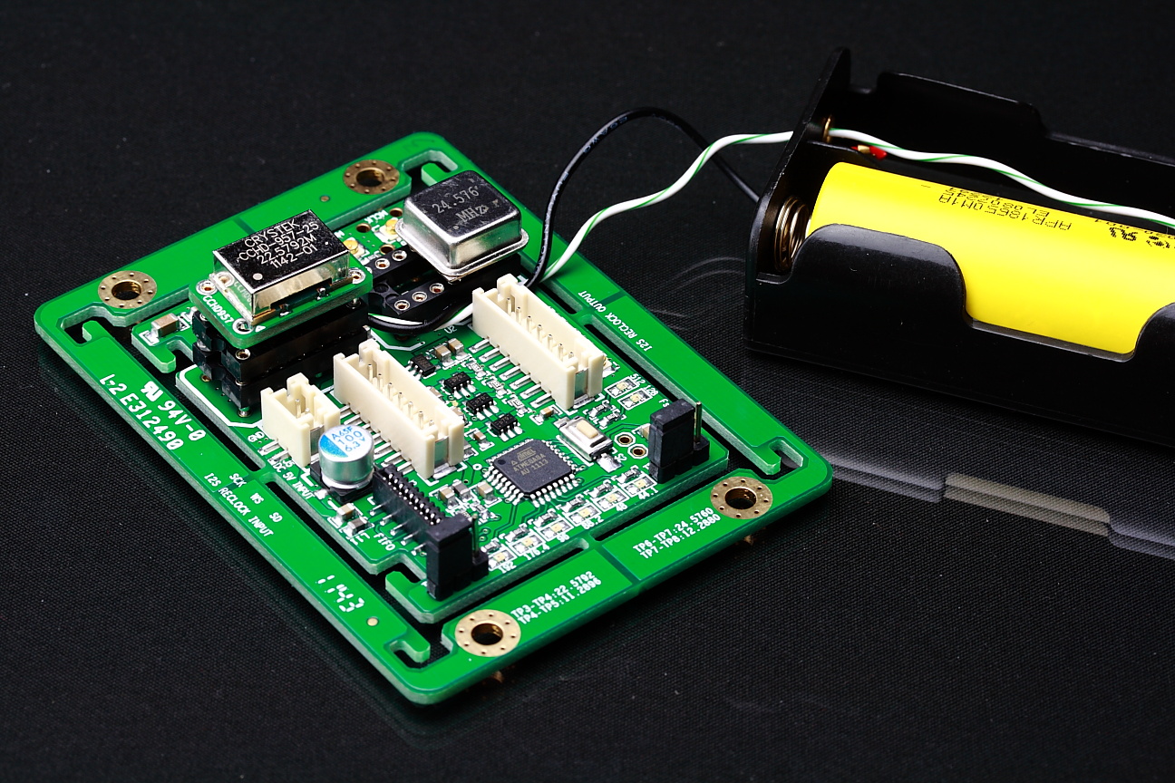

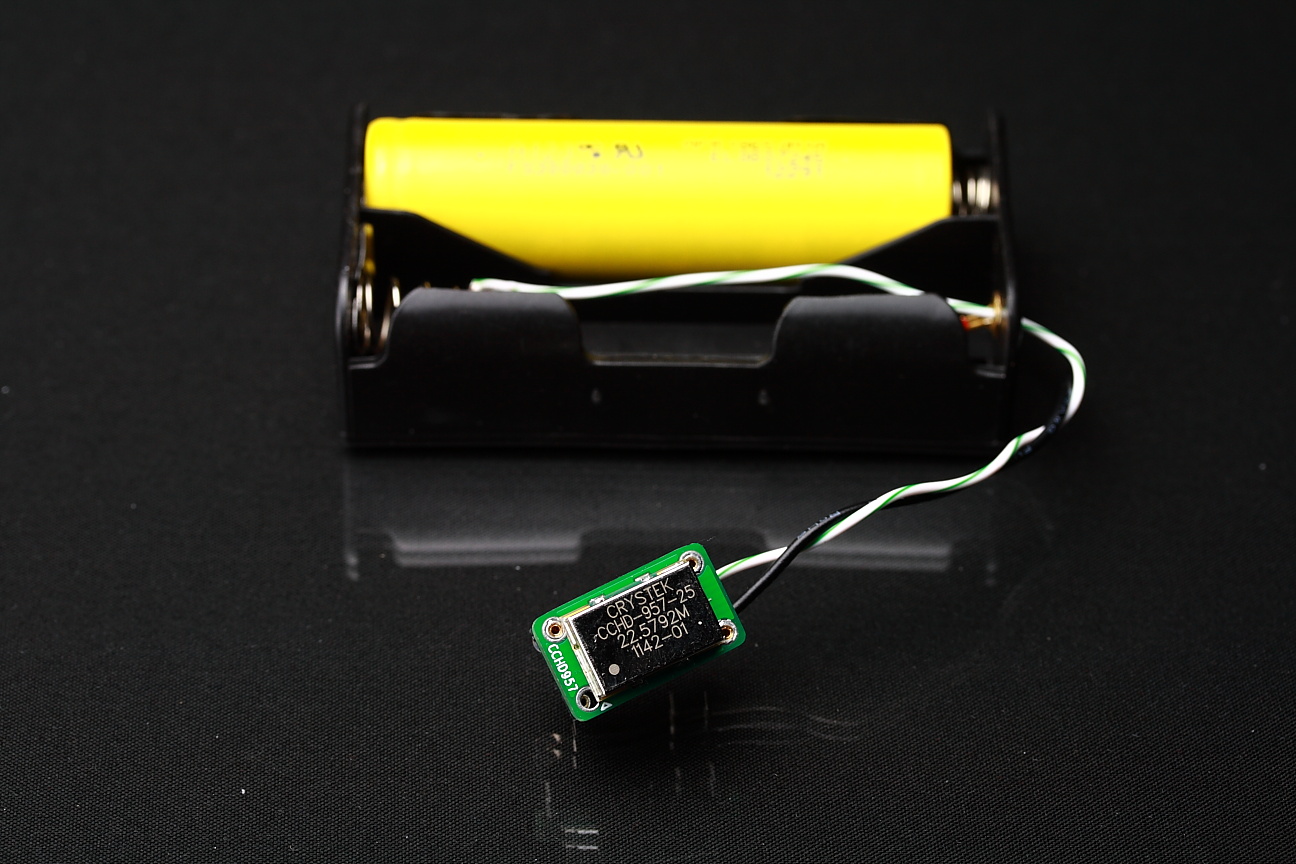

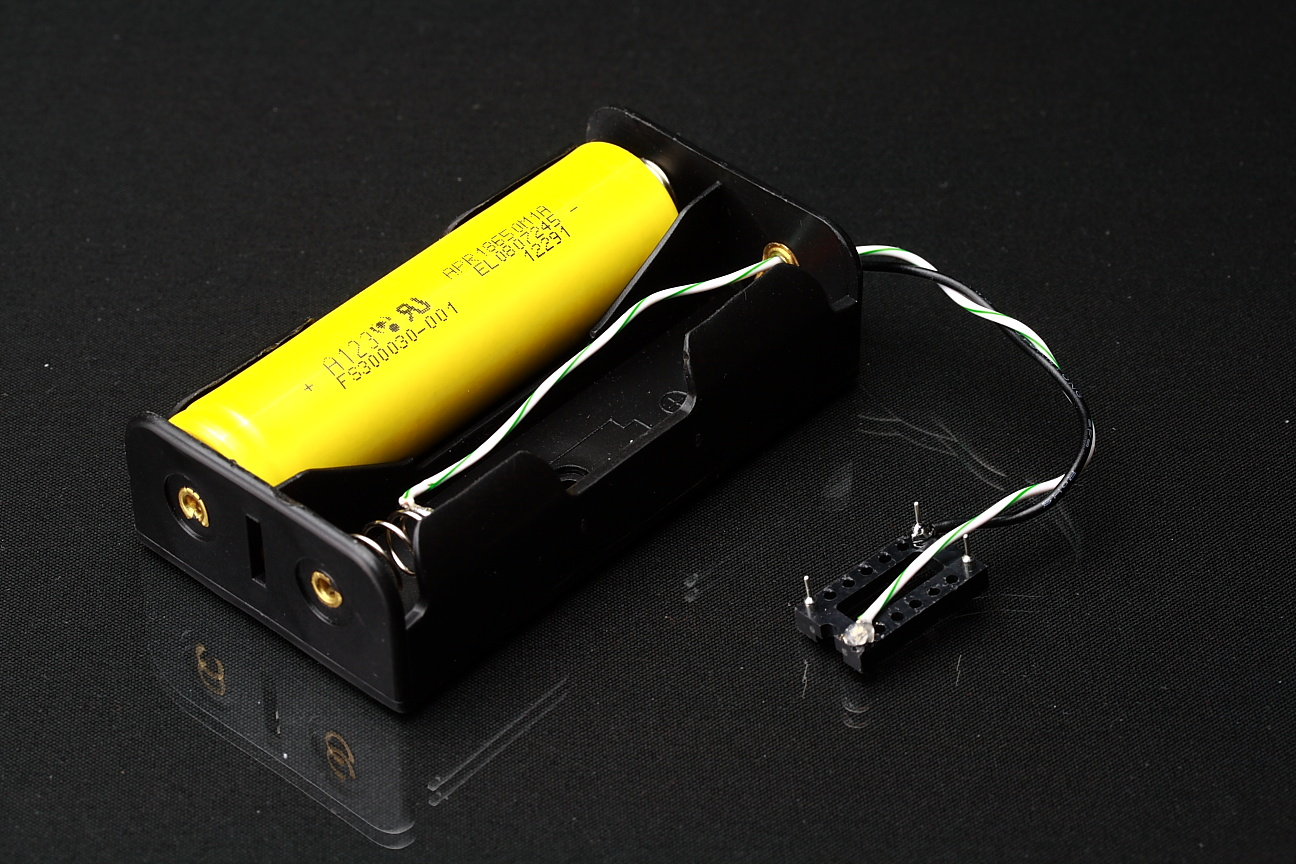

My little toy, A LiFeP04 battery based reference XO power supply
I did a little toy. I connected an A123 LiFeP04 battery to a 14pin IC socket. This configuration works as an adapter bypassing the power of the PCB. So the battery could power the XO oscillator directly from the socket as a reference without changing any other function. The output voltage of LiFeP04 is just around 3.3V. This little toy is really working.
I’m looking for power supply which comes with equal or closing low noise performance than a batter. But I’m not lucky so far. It’s really hard to measure if the PUS output noise is low, especially within wide bandwidth. However, by compare with the battery reference, it’s very easy to tell which one is better. I did some research by making use of this reference, the result was very interesting.
It’s also available that replacing the battery with other PSU to be evaluated.
