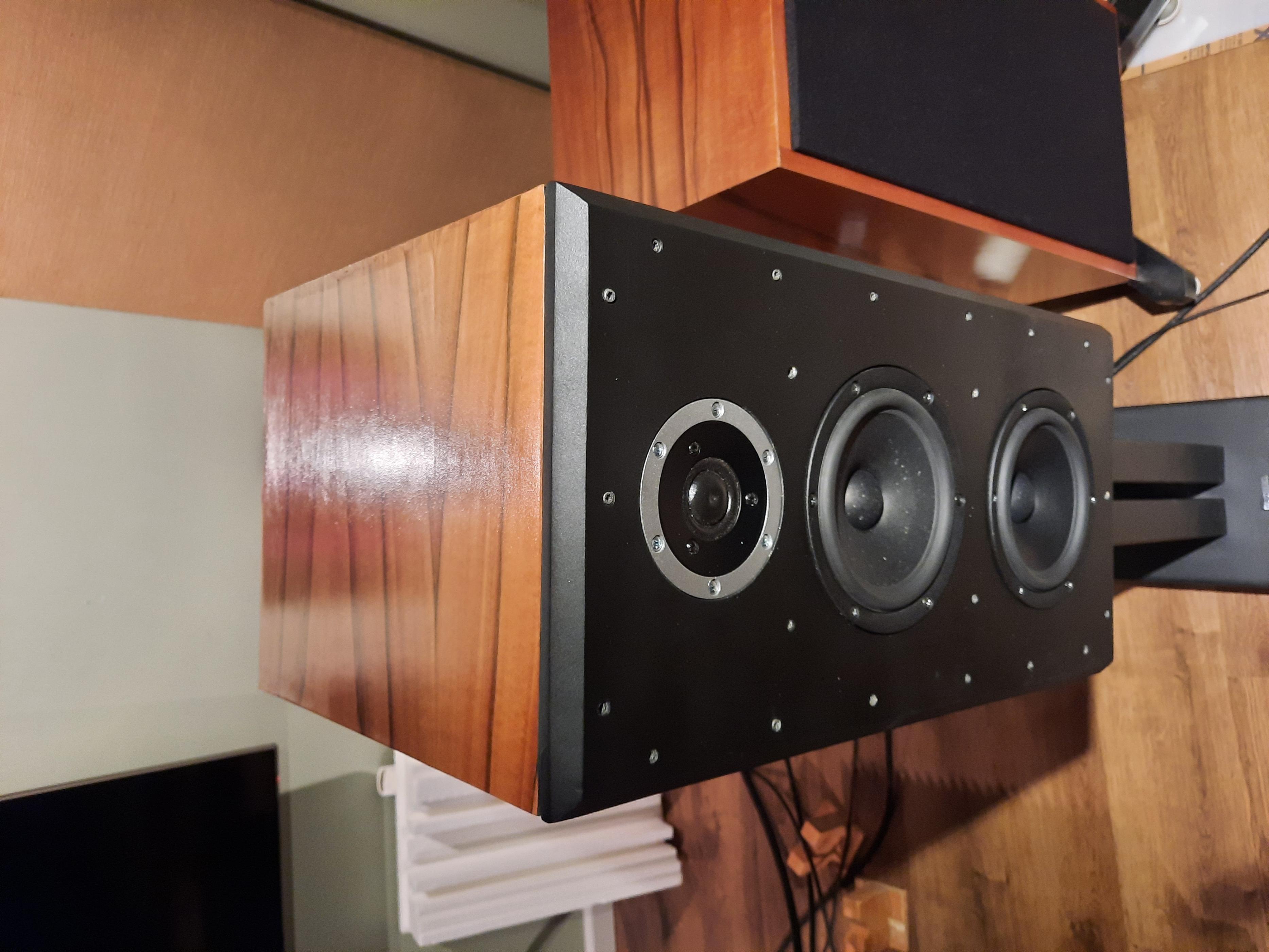

I am resurrecting this thread and my effort to improve a speaker I built. It is an MMT using two Satori MW16P-08 and a 29R tweeter. Crossover and dxt file attached. I have been told multiple times that my XO is the problem. I contacted Madisound and they said that PHYSICAL configuration is not supported by my two-way XO. They said it should either be an MTM or a 2 ½ way.
Other considerations are that I do not have baffle step compensation (Wb = 11.5 inches, Fb=350 hz)
Box dimensions are 11.5x15x22 inches.
I took a stab at a 2 ½ way XO Sim and I am sure I am way off lol. Feel free to offer suggestions to improve it and correct any errors that I have. Your suggestions are appreciated.

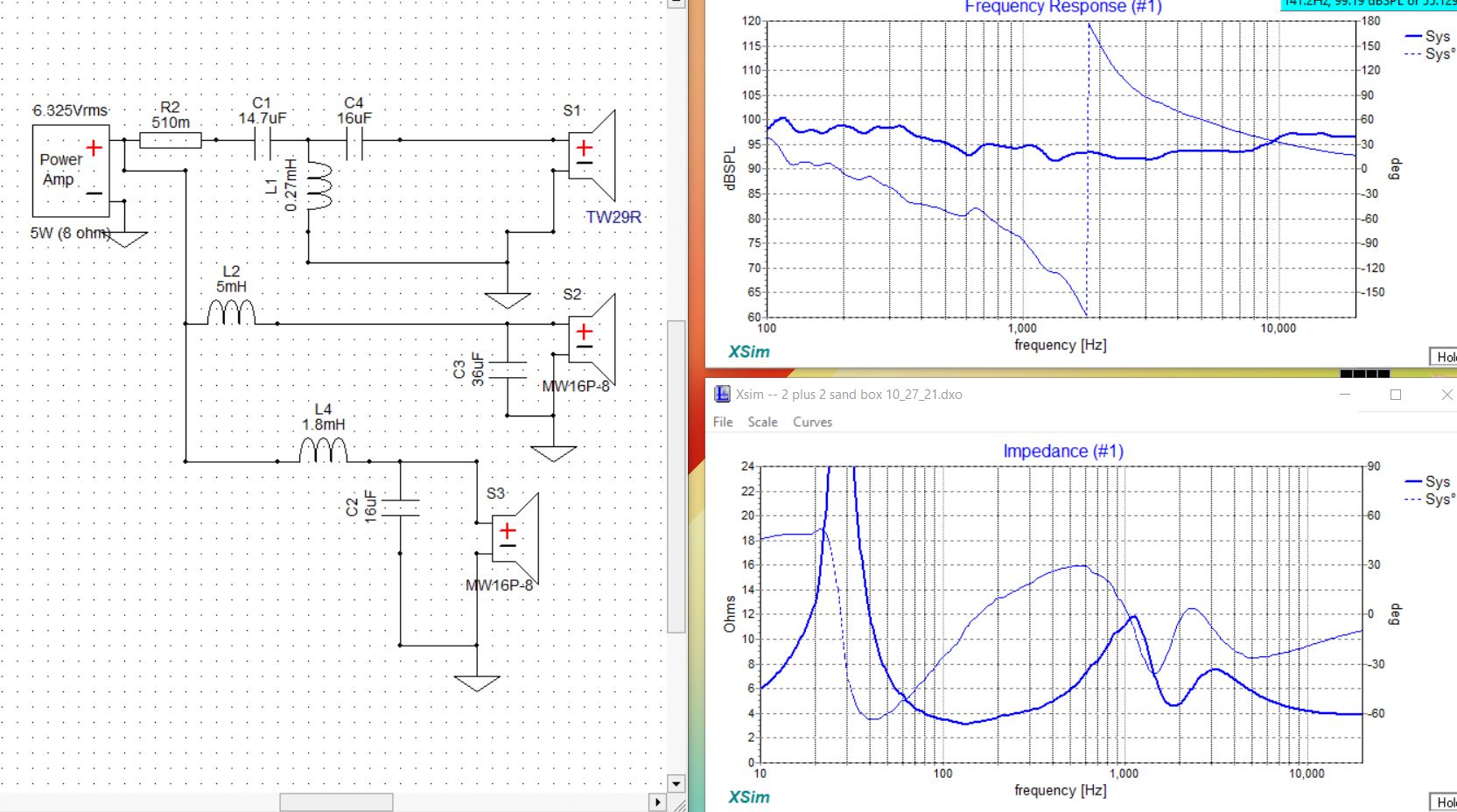

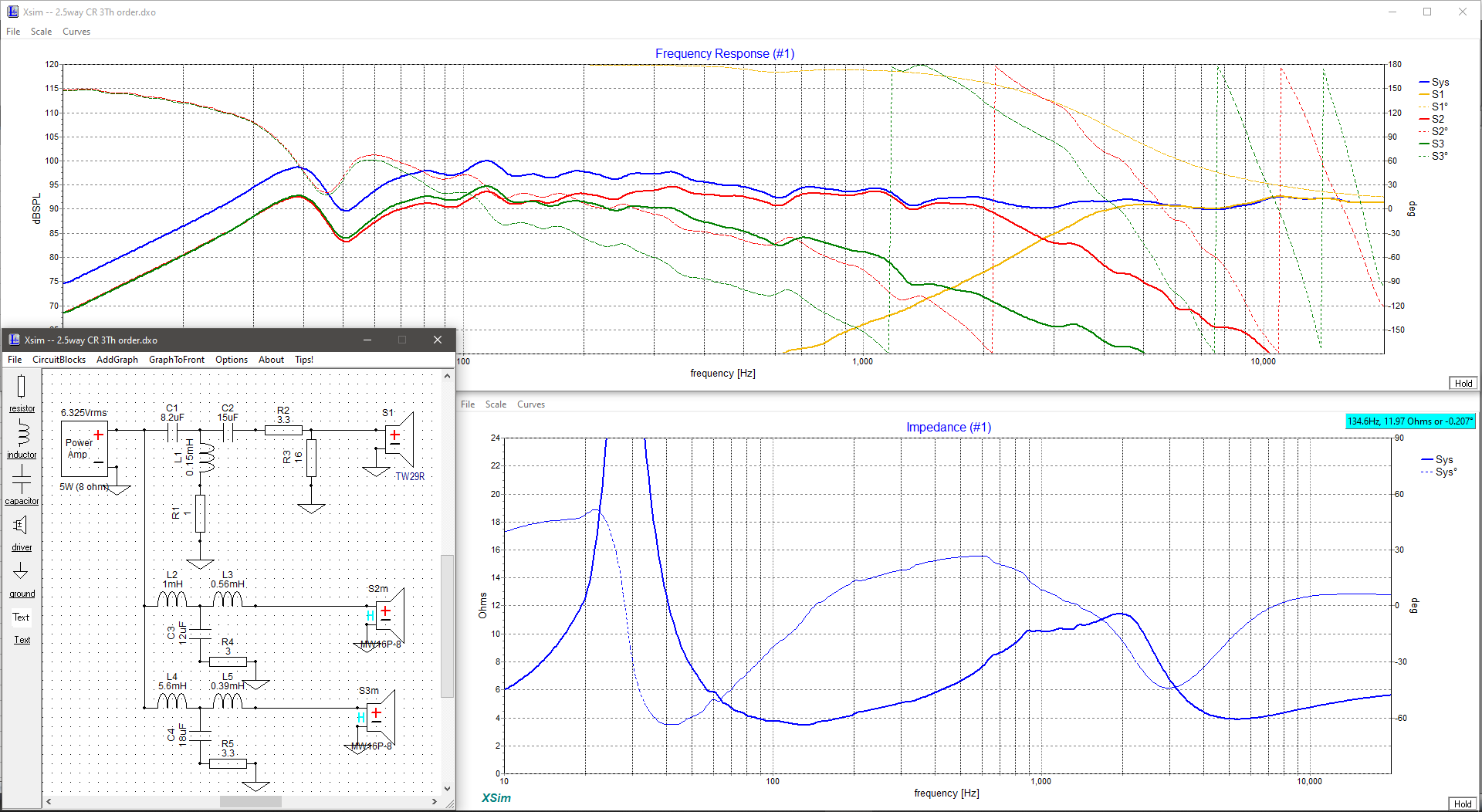

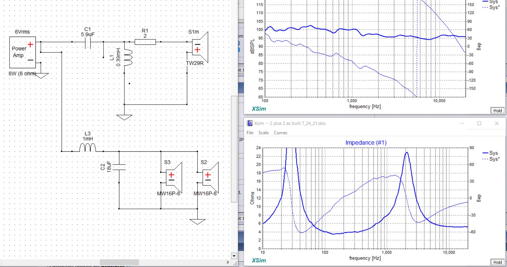

Above are 2 XO. The one on the left is the current 2 way "as built" crossover. The one on the right is proposed 2 1/2 way.
The first question to be answered: is a 2 way for this physical configuration right or wrong?
If it is better with a 2 1/2 way is the proposed even close to what is needed.
That question may be OBE since the SB crossover was published in this thread and I should compare and build the one provided to me. But this is also a learning exercise so I dont repeat my errors. Thanks
what i see in your xsim is that there is no compensation for the alignment. That can make a big difference. Are those responses measured in the speaker from the same point? or is it based on factory graphs?
That is a model in XSim. My actuals show a shallow slope down from 400hz to 50 hz. I assume that is an indication of baffle step loss. No?

Very, very wrong. Two drivers at differing distances from the ear will need individual delay compensation in the crossover. You can look at an alternative topology that uses compound rolloff, aka Zaph ZRT 2.5 way. I find that usually works a lot better for the 'lower' woofer.
If you're set on the Rinjani that's OK. R2 controls the 'knee' of the crossover and is usually not included unless the designer felt it necessary (it usually is).
When you publish or evaluate the crossover, make sure to look at individual driver responses. This gives you (and us) a lot of info about phase behaviour of each driver. The on-axis predicted sum is not the most useful diagnostic tool, as it can also be the result of destructive cancellations, resonance etc.
Note that if you're building the crossover in #64 you have to exactly duplicate the baffle. The baffle is an integral part of the crossover and cannot be altered for a given driver set and crossover.

If you don't do it straight (but slanted like the Rijnjani) there is no way to do a crossover right than measuring. Straight you can get close with calculating the delay needed for the driver layout so all drivers are aligned. I did it with the formula in the attached zip, based on the frontplate of the Rinjani, and came to this 2.5 way config (only an example, no guarantee on success as it's on traced response, not measured).
