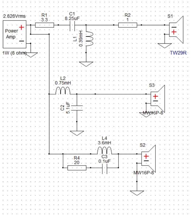

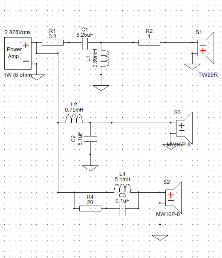

So I redid the sim. Values are recalculated. Does this seem reasonable? I replaced the 5mh with a 3.6mh
Agree R4,C3 is a tank to reduce the MW19 breakup at around 8khz, the MW16 has a smoother roll and so not really needed.
