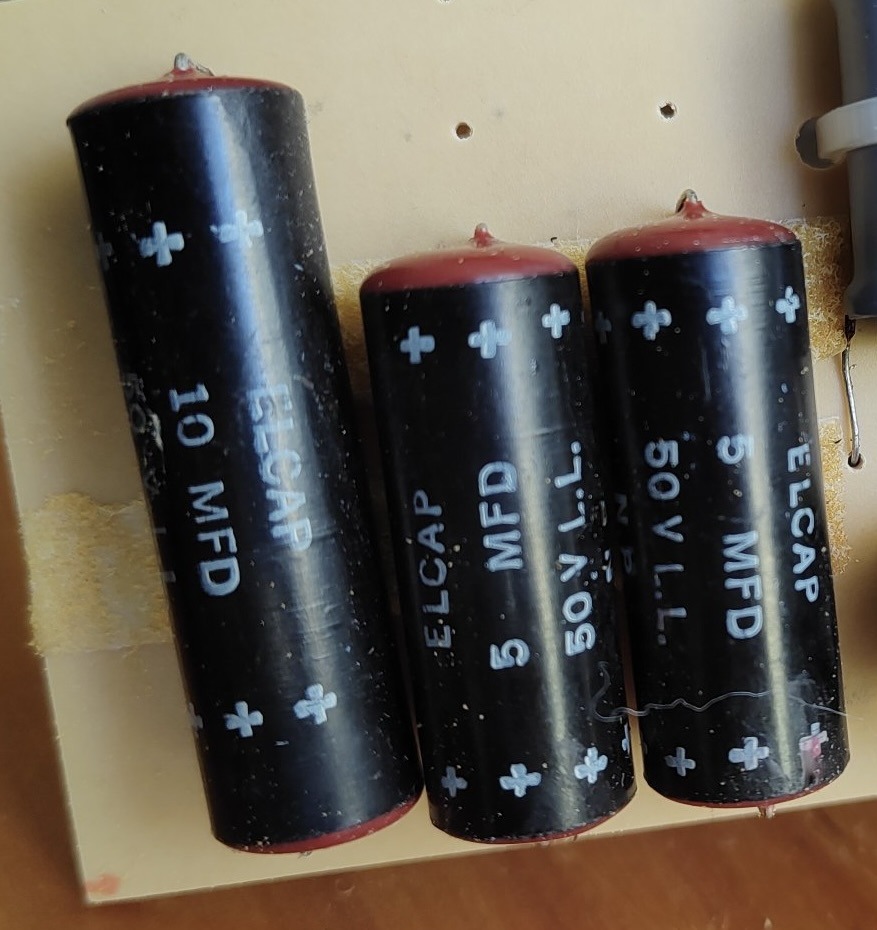

To return as close as possible to the original vintage sound, I would advocate fresh quality electrolytic capacitors.
They will keep the speaker on song for the next 40 years of its life!

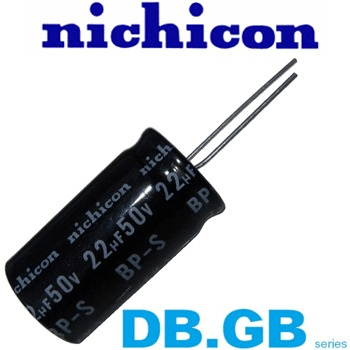

There are many good brands out there. Take for example the Nichicon DB series, or something from Panasonic.
Thanks Allen.
Any economical Oz sources for the Nichicon DB series, or Panasonics?
I've gleaned Chinese Nichicon sources from the internet.
To be frank, in general terms, I find product from China is of very poor quality.
Then there is "copy" product rife.
I mean, a Chinese EBayer located in Shen Zhen lists his Nichicon Caps as being "Origin Japan".
How believable is that?
Also is BP-P the same as DB series?

BP-S stands for 'bi-polarized series'.
Within that blanket description we have the DB series and the superior GB series - see PDF below.
https://www.hificollective.co.uk/sites/default/files/nich_db_gb_0.pdf

I would regard these capacitors as electrically equivalent to the ELCAP capacitors originally fitted to the vintage crossovers.

I was thinking: : " Grab 2 of the 10uF ELCAP's & 4 x 4.7 uF Cornell Dubilier's".
Any issue with mixing brands?
Would the 10uF cap be filtering the tweeter in the MS's?
It being +-5% and a small probability it will do a better job over the Cornell Dubelier??!!
Good thinking, but you mean two 10 uF Mundorfs.
Not in my book!

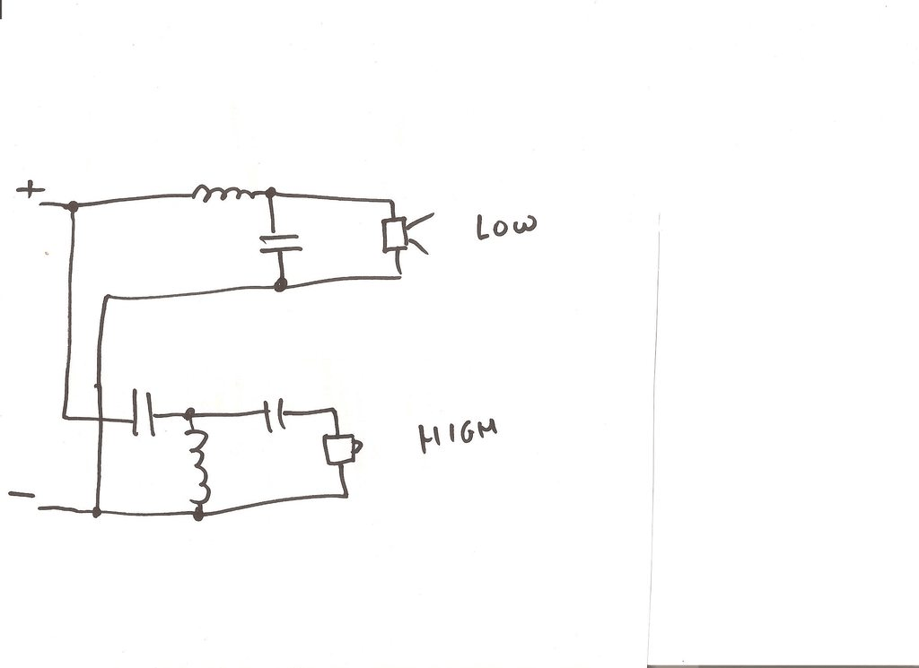

The basic crossover circuit will be as follows:
@AllenB may confirm the position of the 10 uF cap, but I think it is probably on the woofer.
However, I wouldn't worry about the positioning. The proof will be in the pudding!
EDITED!
Perhaps it's the second tweeter capacitor.. only guessing at this stage.@Allen B may confirm the position of the 10 uF cap, but I think it is probably on the woofer.
The two caps in the third order high pass filter would normally have different values would they not?
If so, it would be 5 uF followed by 10 uf on the tweeter.
