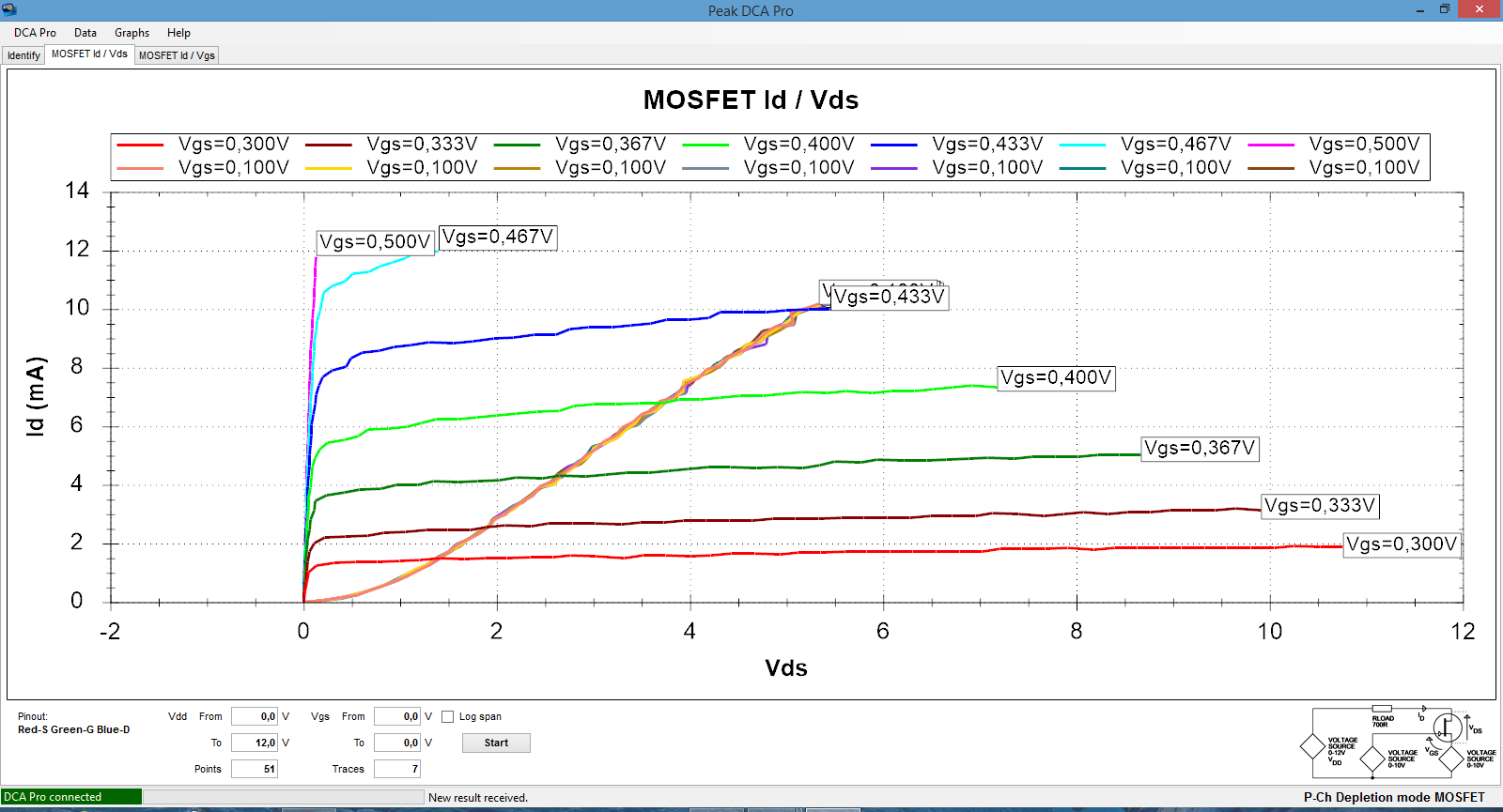

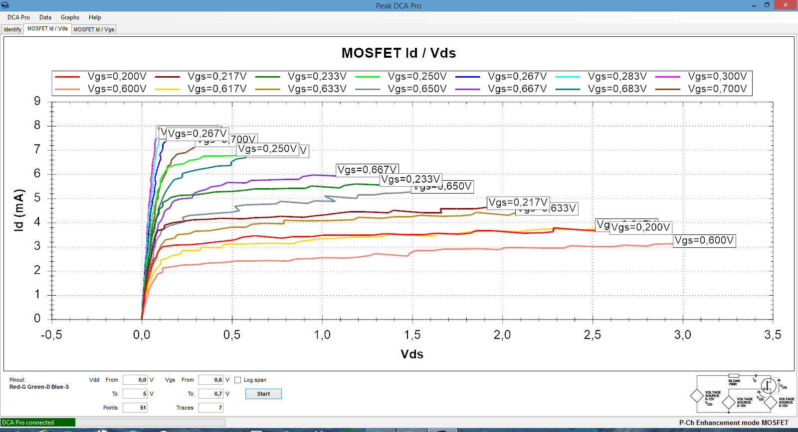

As you can see the P-Channel is trouble.
I checked another P-Channel that looked the same.
I hope i do not have fakes.
I have those Fets since a relative long time and they look genuin.

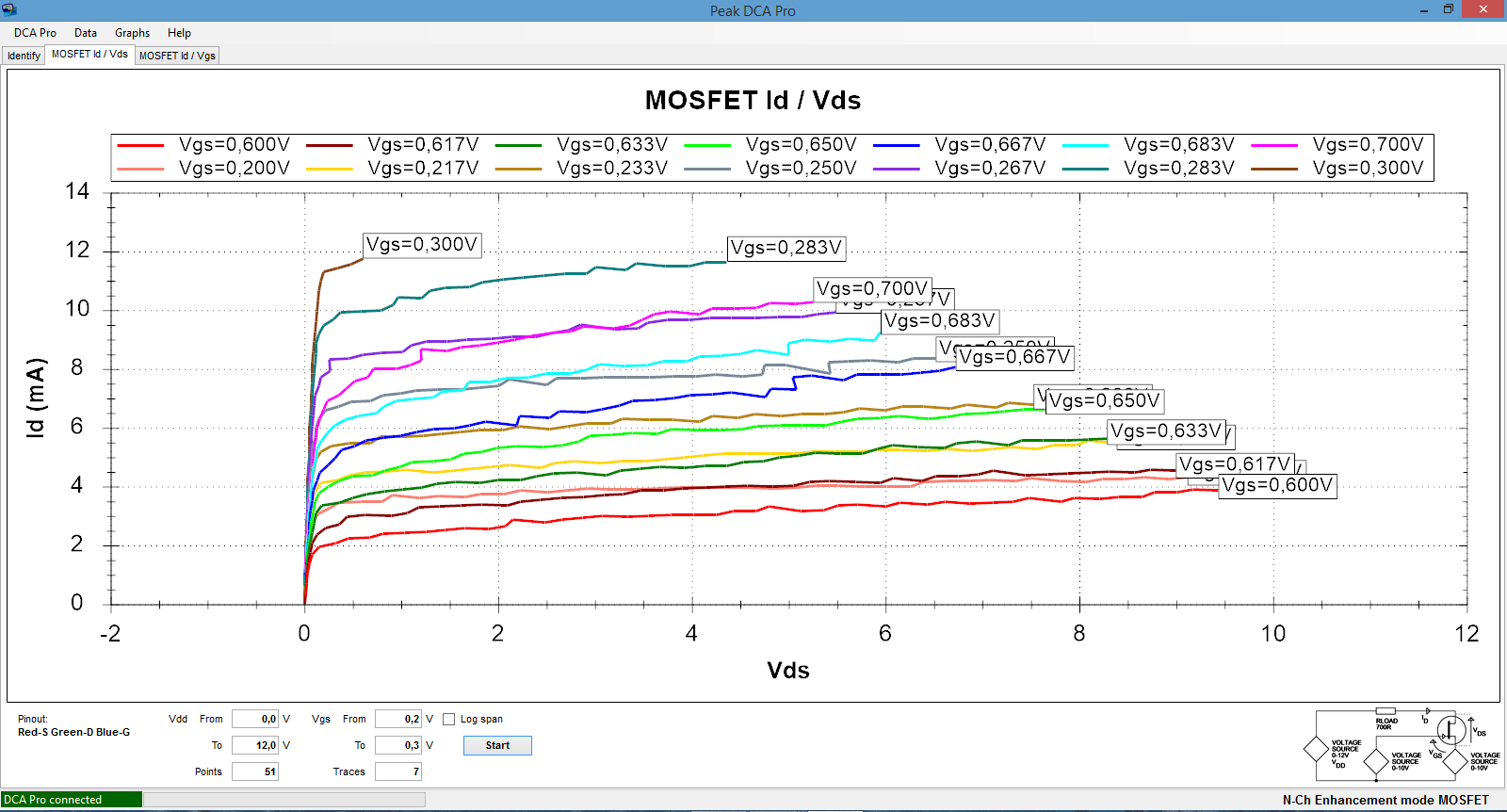

I breafly measured the Exicons and they look much better.
I publish that in the next halve hour.
