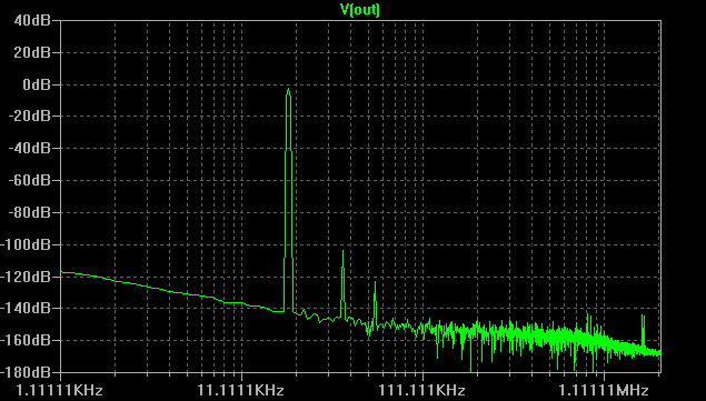

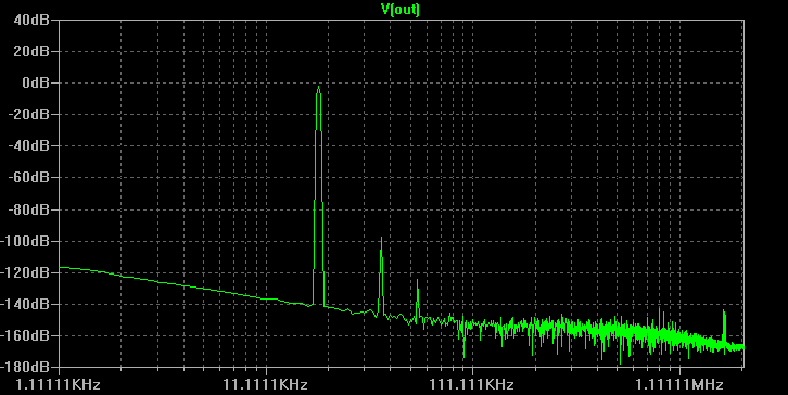

I just checked in the simulator. I found very little affect (slightly positive) from changing between bootstraps to Q7 and/or Q10's emitter. In other amp simulations, I have noted that the harmonic spectrum changes significantly depending on whether you bootstrap to Q10 or Q7's emitter. I think this is worth experimenting with.
Also, the circuit has begun uncontrollably oscillating after I added series inductance to the caps and decreased the timestep. Increasing the miller cap didn't help, so it seems the problem is in the C-multiplier. I get the same oscillation whether or not I use the CFP c-multiplier. Just added some smaller bypass caps...
Okay, now look at this. The new bootstrap reference helps! 3rd harmonic is about 25db below the 2nd, whereas with normal bootstrapping it was 20db (I measured this at 20KHz since it gave a better FFT). (THD itself actually increases, but I prefer this because the spectrum is, by Hugh's logic, more benign). (I added a .four command to the schematic, results of which you can see in the error log)
Attached are old and new FFT's, and the .asc file used.

I like the change in bootstrap, it keeps a bit H2 in there even at lower frequencies. This is something it would be nice to prototype, but my vote is in favour of your change.

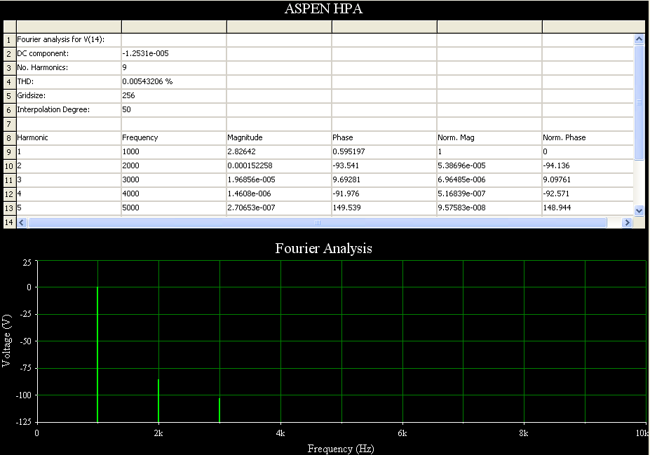

Looks to me like the THD is too low, we don't want this to sound like an opamp do we !? - let's get that H2 up...
A distortion is the alteration of the original shape (or other characteristic) of an object, image, sound, waveform or other form of information or representation. Distortion is usually unwanted.
H2 is higher than H3, higher order are below -125db...this is good!
Sometimes we want distortion in order to cover up the nastiness of the equipment that recorded/mixed the music, or whatever digital processing was made. 2nd harmonics seem to be most pleasant, so "higher H2" might not be so bad.
This circuit doesn't have a problem with H4 and above, so then any further "tweaks" would probably be to improve the ration of H2 to H3.
- keantoken
yes it is looking good, very little distortion. On the other hand, many things in life are more interesting if they aren't too pure...😀
I guess we'd better remember it's for headphones, -100dB is a noticeable signal, whereas for speakers it's already buried in the noise.
