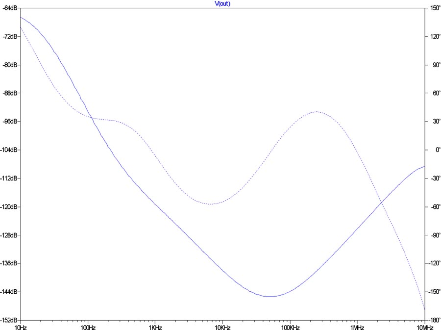

Anyhow, thinking of adding a dual rail capacitance multiplier and looking at the PSRR between the psu input and the amplifier output...I tried a simple simulation. Hope it isn't wrong.
p.s. OK, I am a bit biassed (one of my new DIY projects at home will use a cap multiplier)

Add some series resistance to the 470uF caps, to make it more realistic. How about .006 ohms (I think this is a believable value).
Also, plot the phase as well - this may help.
A Zener across the cap will improve line regulation.
To reveal more of the spectrum, simulate to 100MHz or even 1GHz. Then you will see the actual effect of the 470uF decoupling caps.
- keantoken
Good idea - I should add some ESR to the caps.
The plot already shows phase (dashed line).
I don't like Zener diodes, dirty things.
p.s. I view the 470uF caps as the path taken by the signal, so we should think of them as more than decoupling capacitors.

I don't have enough experience to know what size they should be, generally smaller means lower ESR. The reason I see them as part of the signal circuit is that the a.c. currents flowing through the load will flow through the output devices of the amplifier and then through the psu and I view that the lowest impedance path for the audio signals through the psu will be through these capacitors rather than through the cap. multiplier ????
Zeners are silicon used under duress, it's cruel. Operating in a constant state of breakdown (or tunneling straight through them). They must scream out in protest. Mostly at high frequencies perhaps.
I wonder how the psrr at the collector of Q16 looks like. Also, could you please plot the output impedance of the multiplier? (inserting a current source with small signal AC amplitude equal to one, then plot the voltage between the current source and the 470uF cap).
Here's an extended freq. range and a comparison between zero ESR (blue) and 6mOhm of ESR (green).
Maybe this is good enough ?
Adding to my last post (I posted just a second before you posted), how about also a plot of output impedance (,PSU output voltage / PSU output current).
The roll off after 10MHz is (unless I'm wrong) because of the 470uF "signal decoupling" capacitors. This is why I question their affect at AF.

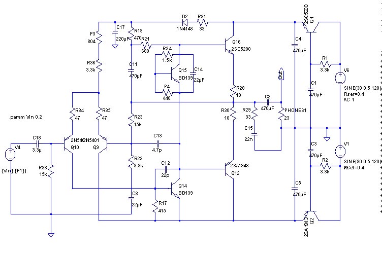

Sorry guys - I don't think I'm doing you a good service with my sims quite yet although I do like doing them.
First off, I have to transfer files back and forth between a PC laptop and my iMac in order to post results, which is a bit of pain.
Secondly, having read a few threads over the past weeks I've seen a level of expertise that makes me look like a medieval knight, whereas people like Keantoken and Andyc are better examples of Merlin 🙂
So here's the file I've been using... please post back if you make improvements and perhaps somebody can update the models to match the devices Hugh has selected ?
[change .txt to .asc to use the file]

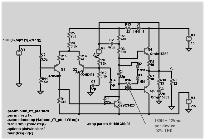

Yukk 🙁 shunting to ground ,I assume. I have seen Zener circuits last 17 years (bass amp I just fixed). They are the same in theory as a BJT or IC reg shunting to the load , but they are noisy. 😱
Everyone is "jumping ahead" , I am still on the amp. Are you all going to use a active or 2 diode Vbe ? run it class A or B ? (lowest = .02% at 125ma class A- MJE's)
To keep it simple , I have gravitated toward the (2)1n914's (on the main HS) + a 500R trimmer w/ 22u decoupling cap. At least in class A , this would do well for thermal stabilization. At 125ma per device @ 1/2 amp total , just a 1 1/2" X 6" angle with the diodes and OP's attached to it would work out good.
BTW , I am keeping it dual supply and using IC regs. (same as the DACS that will be with it). Final prototype (as I will make it) attached.

Technical input is good, otherwise we don't get the fun of debating the design 🙂
And yes, to be honest, I'm not too concerned over the small details in terms of the capacitor esr - BUT some of you guys are and why take the fun out of it by me pouring cold water on it - if you can take the simulation file and explore some avenues I'm not interested in then do so, I may learn something new ! .... the high sensitivity of headphones does scare me though.
I used 5200/1943 because I have spice models for them; I don't have models for the driver devices Hugh uses (yet).
OS
I like the diodes. I simulated the temperature sensitivity. With the Vbe multiplier there's a clear negative thermal feedback and the current through the output emitter resistors drop when the heatsink temperature rises. With the two diodes it's close to neutral, and actually my sims showed a very small increase in output current with a rise in temperature - probably not enough to worry about though. But the ability of the diode's to control the temperature coefficient does depend a little on the value of the resistor - I used 180R as you suggested.
I agree with you, at these relatively low power levels, it would be a crime not to run it ClassA, at least for headphones of 23 Ohms and above, within reasonable listening levels.

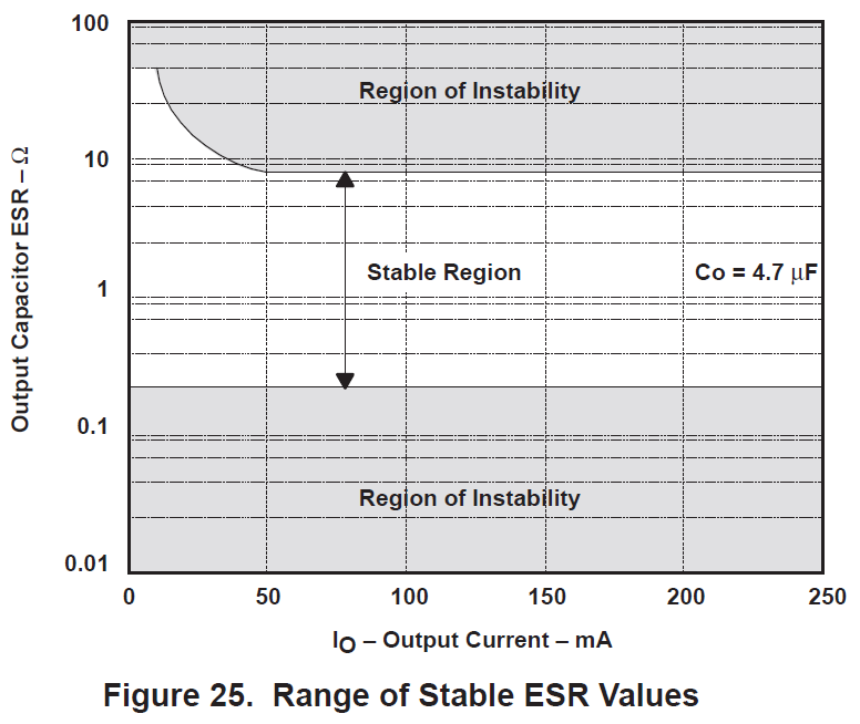

I suggested adding ESR for the sake of simulation - ESR can have a large affect in the simulator and I think this is important to note.
It ain't just the simulator. It's the real world. ESR (and also ESL) is very important for voltage regulator stability for example. See the discussion of the "tunnel of death" as it applies to regulator stability in this TI app note. It's given this name because if the ESR is too big, the regulator will be unstable. Likewise, same deal if the ESR is too small. The graph below shows one particular example.
That's why it's important to scour app notes and data sheets to get the best values you can, as opposed to pulling numbers out of the air.
