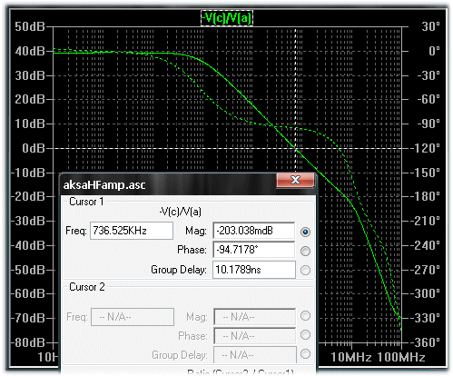

Here's the Bode plot from LTSpice:
Looks like unity gain is at 11.6MHz, 3dB point is at 1.6MHz.
I noticed GK's plot showed a gain of near on 34dB, which is very different to the CLG of 15dB.
I plotted the loop gain and phase. A closed loop bode plot tells very little about a simulated amplifiers stability margins and you consistently apply the wrong technical terms to the wrong things.
Good tip, I rarely look at the amplifier performance open loop, which misses a lot. But still, I like to know how it looks with the loop closed - any signs of instability there would be bad...

by andy c. - and told OS to simultate V(b)/V(a), when it should have been -V(b)/V(a).
And it works soooo goood. No oscillators YET !!
I prepared the .asc (in the aksaHFamp.zip folder) and it works nice , 775khz unity gain with 94db margin (attachment 1), this would be very stable.

Hi
I just used the simple method shown in the LTspice example file; LTspiceIV/examples/Educational/LoopGain.asc.
This just involves putting an AC voltage source (set to '1') in series with the output and then plotting one terminal over the other.
Follow Andy's links above to a more complete explanation.

The trick with loop gain is useful, thanks to GK and Andy_C, very useful way to figure stability.
