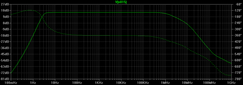

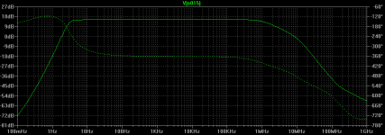

I just extended the AC simulation... It turns out this produces a ringing at 3Hz! This won't be stimulated by normal music, but it would ring for a few mS say, when you plug in the headphones. Hmmm...
EDIT: just found the solution: put a 1.5k resistor in series with C15. I guess this acts as a dampener... But it also seems to acttt as a sharp cutoff filter for frequencies below 5Hz. 😀 Maybe we should move this cutoff to 20Hz, just for conformity. (then again, do we want to be able to hit that "brown note"?)

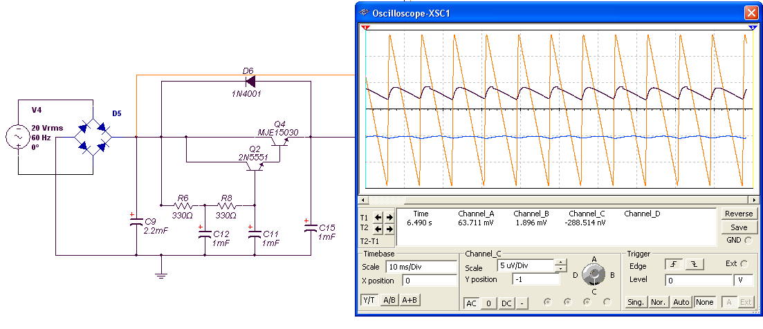

A cap multiplier sim showing ripple reduction:
Orange trace is picked from the bridge rect at the first smoothing cap.
Scale is 50mV
Black trace is output from the cap multiplier.
Scale is 5mV
Blue is output from the amp into load with input shorted.
Scale is 5uV
Performance is quite good for this simple solution and I'm leaning toward this now myself.

A Darlington should be safer than a CFP in this application.
The Darlington will also have the gain needed for the multiplier to be effective.

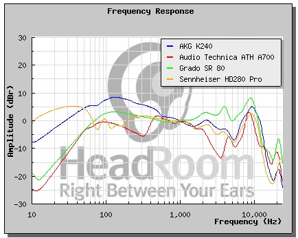

Well I've dug up some frequency response curves for a couple of headphones. It doesn't look as if there's much benefit from extending the frequency response below 20Hz.
Can you weight up the benefits of NFB before vs after the output capacitor in terms of parts count, distortion, phase response ?
My thinking is that some folks like the NFB after the cap, figuring that it helps to reduce any distortion arising from the cap it'self. But I'm not old enough to remember the poor caps from 40 years ago - modern caps are so much better.

With NFB after the output cap, there is no benefit except in bass response. There is an odd ringing that happens at 5Hz which, if too large, might overstress the headphones.
I'm sure it would work much better if we were using a dual supply (but then we wouldn't need it). I don't think it is practical for our application.
