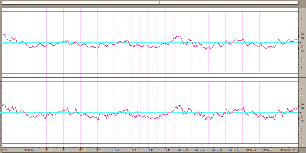

Look at this, left (top) and right (bottom) from both files overlaid.
Now, an interesting thing happened while I was getting that graph together, I noticed that the left channel looked very similar to the right from the other file and vice versa. I slide the overlay up and presto! exact match. That was the final piece of the puzzle - swap channels on sample #2.

Hmmm. John, you are saying, I presume, that Nico has given us the same file from the one amp, inverted it and changed the level, so as to confuse?
And then, of course, perpetrated an artful dupe on all of us?
This is kinda strange. Let's ask Nico.
Nico, is this two files, modded to look different, but from the same amp? Or are they two entirely different amps?
I find it hard to believe you would do this, but this is the net, so anything is possible, so I'm asking now.
If I heard a difference, it would almost certainly be level only, and my comments are trite, and I'm a goose. If Nico did deliver two files from two different amps, then we are all smart fellas. I guess when he answers, we will know for sure!
Nico, over to you.......

I didn't measure anything, I just worked with the data Nico presented and the conclusions are obvious for anyone who has their eyes open to see.

Regarding the files, why, when I do all that I did to put them on an equal level, do I wind up with identical waveforms? If these were identical from the start, it would not be questionable but that's not the case - they looked different and they even sounded different. To recap what I did for those of you who obviously didn't bother to read my earlier posts:
First, I made the files start at exactly the same time and discarded the lead in time to this point. Next I made them the same length - exactly 1 minute. I then inverted the waveforms on sample #2 (the one you said was the SE and "naturally" inverted). I normalized the volume on all 4 channels to the same level. Finally, I switched left for right in sample #2.
Viola! The same! How?

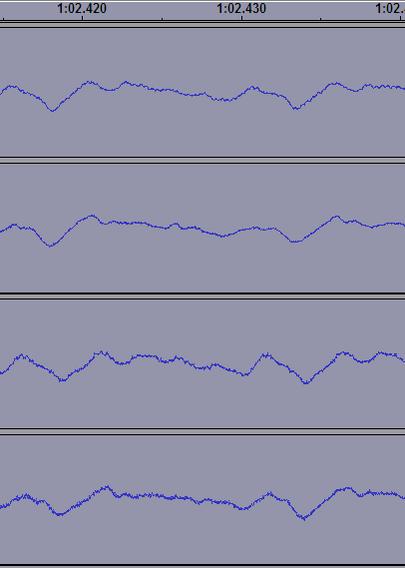

Comparison.
I can see the differences, unless my eyes are also going. These two signals are normalised to 0dB and in time only microseconds out of sync.
But we are talking PC sound cards which are at best suspect, a decent storage scope should show the differences well.
I am not here to prove the one over the other, just to show that there is a marked difference in the graphically representation, there may be less than a difference in what one hears or hope to hear.

I have looked at the two files in Audacity and there are subtle differences between the two. Your comment about the harmonics was interesting, I had not though of that before, a close inspection reveals the differences you talked about. You're right about sound cards being a bit suspect, if I align the tracks at to a given sample at one point they are very slightly out of sync some time after.
The differences are small but I would expect them to be. If the differences were large one of the amps would be rubbish (assuming the other was good) as its output would not be accurate copy of the input. After all the THD is a measurement of the mathematical (in)accuracy of the output compared to the input and it is pretty small for both amps.

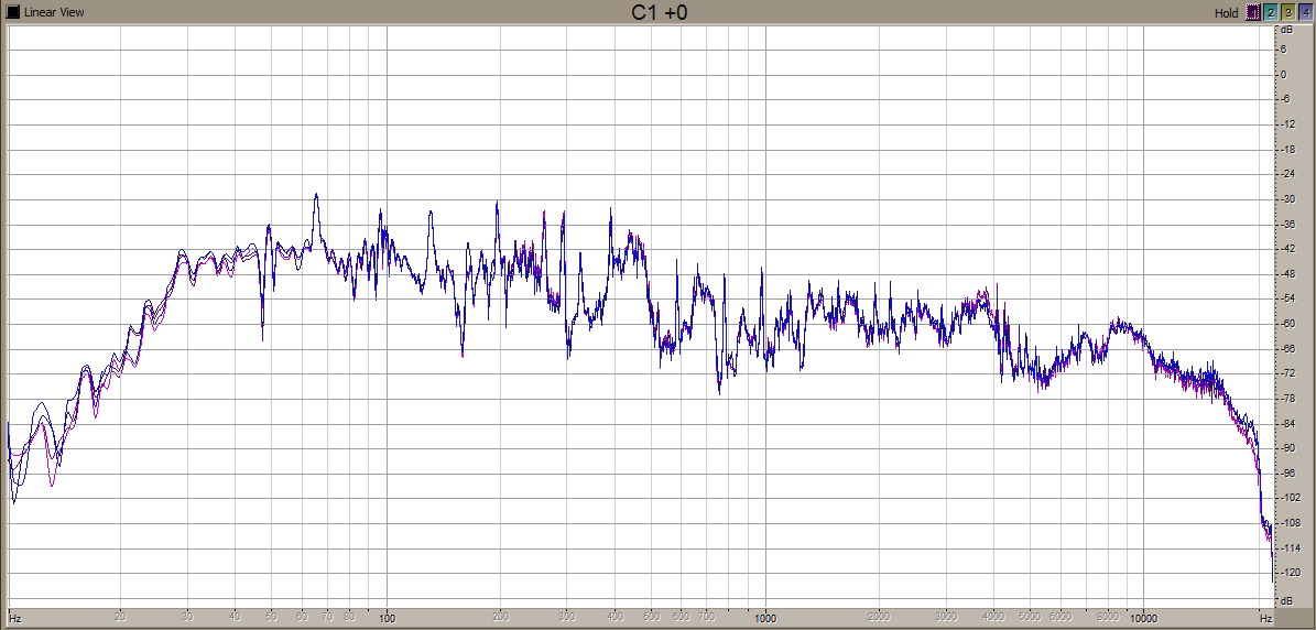

Both files, cleaned up and overlaid. The differences are consistent with two recording session of the same amp.
We are comparing a low distortion, multi-gain stage, push-pull class AB to a high distortion single ended amp............... The differences are consistent with two recording session of the same input signal
