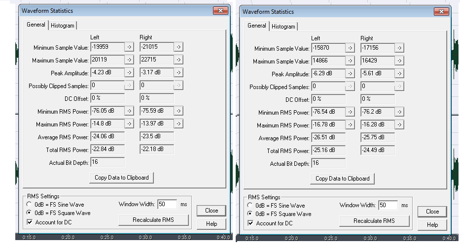

I opened each of the samples with Adobe Audition to take a closer look. The second sample is at a different volume - lower:
(sample 1 left, sample 2 right)

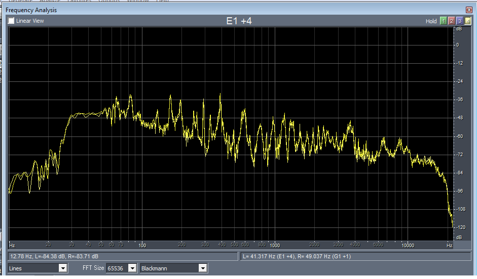

Frequency response is quite a bit different.
Sample one:

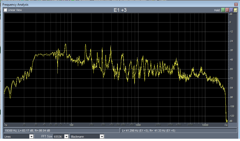

Sample two:
When I compare these to the version I downloaded (for scientific pursuits 🙂 ), sample 2 looks like the more accurate.

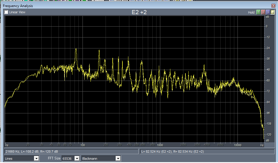

Freq response of the .wma file:

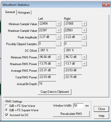

Here`s the statistics for the .wma file:
Notice the difference in max signal to min signal and compare to the ones above.

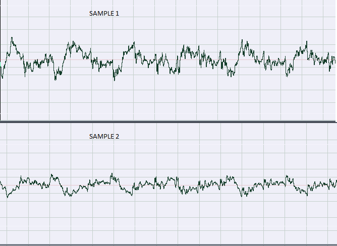

Hi Nico,
Yes, I did and I've been working to do the same here. Results:
They appear to be out of phase also. It took some time to get them synchronized.
