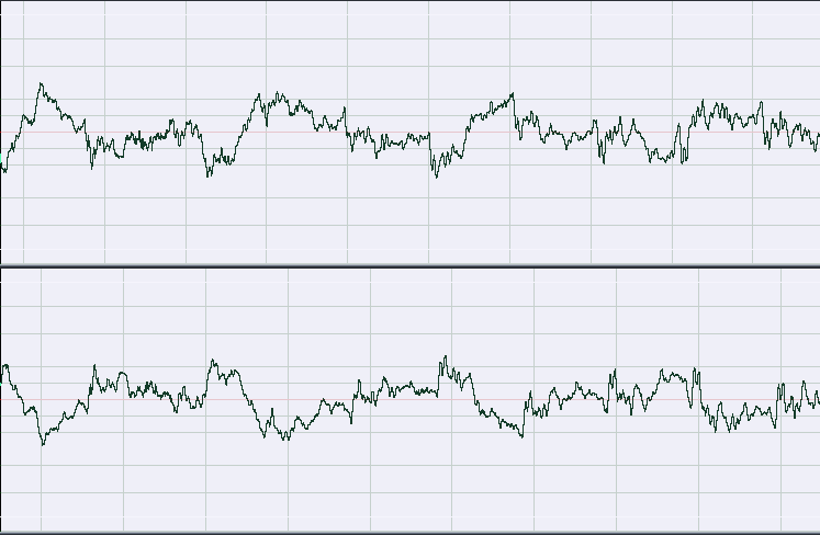

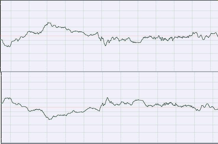

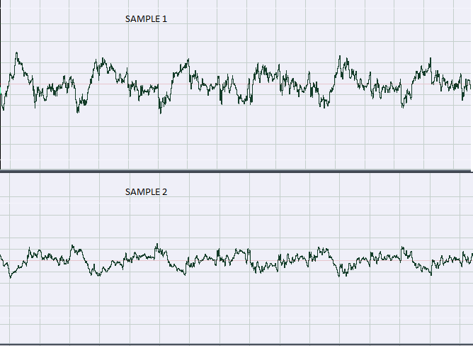

John, have a good look at the two signals and you will actually see some flaws. They were only sampled at 16 bit but even then dynamic range is still 96 dB.
The bit rate was 320kHz and resolution is good. But have a look some peaks and troughs is sharper in one sample than the other. You can increase the volume setting to get the amplitudes the same since you are working with digits it justs adds number to existing numbers, it does not change the shape.
Sheldon you are not imagining anything and although your ears frequency response may be a tad out of spec, you can still tell what you like and what you don't. You may not hear the character of a triangle as a young fellow would, but to you it is still a triangle, it is not a trumpet. Your mother still sounds like your mother, not like your farther.
Remember guys this sample is in the time domain and exactly as you hear it or the way it makes the speaker move. These signals are slightly different. When the amp has some dominant odd order harmonics the peaks will be rounded and even order harmonics dominating the peaks will be squared and the rise time increases, The signal as it appears and I have now proven it to myself looking intensely at the time domain plots the one will sound warmer and the other crisper.

I completely agree with John . Last night I had a quick look in Sound Forge 9 at both tracks. With the later track, both L and R have the highest +VE going peaks at 00.57.025 which seems more likely than the 1st track ,where the peaks are -VE going, and the maximum is at different times in both channels.
i.e 00.57.015 and 00.54.258.
I suspect that the 2nd amplifier is likely to be more accurate. Hey, I could be wrong too !!!

It is impossible to record two songs from two sources starting at the exact same moment and having identical levels set, unless you have some very sophisticated equipment or software.
Took me two hours to time and amplitude align 20 mS of a complex stimulus. Never-the-less I think that it got everyone thinking about it.

Final bit of information and you can draw your conclusion.
1) The first sound clip was from HAKSA and the second from the SE amp - some said they liked the second clip more, which was the SE amp.
2) We looked at the graphical representation of the two clips and it would appear that the second which is from the SE amp could have more detail.
3) I am now providing the THD figures of HAKSA and the SE amp the SE amp has worse distortion than the HAKSA for exactly the same output. The distribution of distortion is a little different as well, but could one conclude that the slightly higher distortion is responsible for the subjective conclusion that it sounds better?

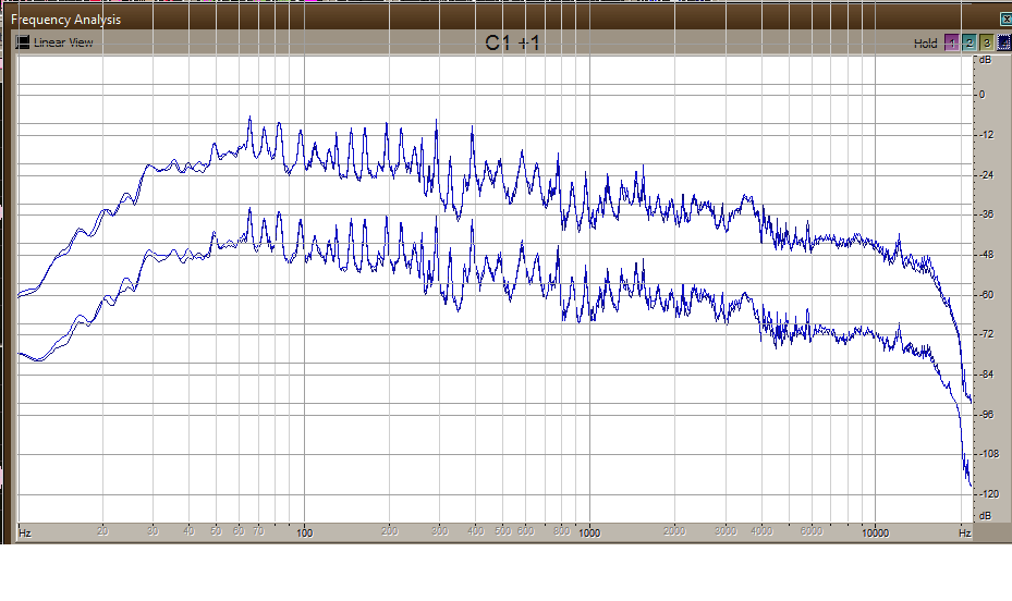

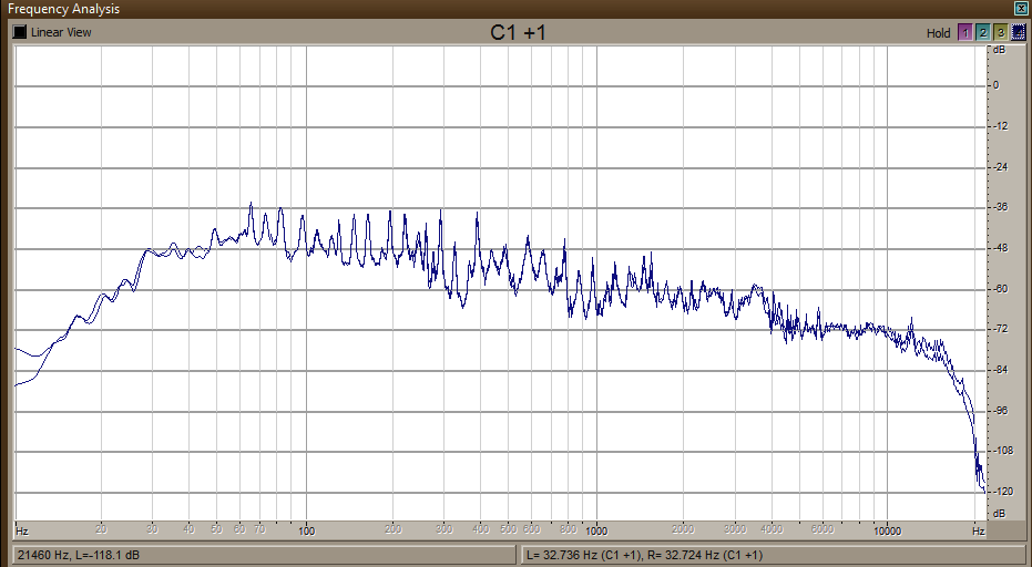

Ok, now I'm sort of getting somewhere. I have done some work of the files: I gave them exactly the same starting point, cut each file to exactly 1 minute long, inverted #2 and normalized the volume on #2 to match #1.
Here's what they really look like:
Sample #2 is the bottom traces. The entire sample was used for each frequency response graph.
