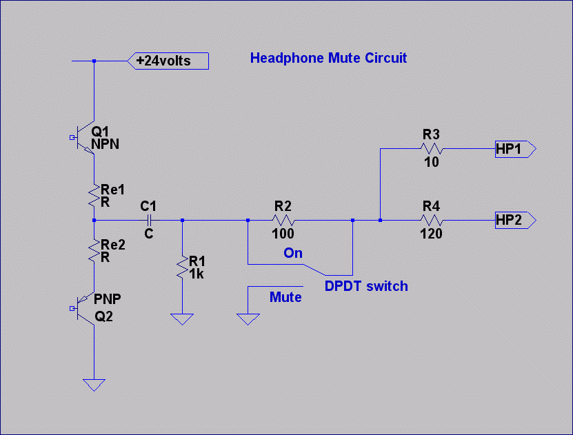

Revised Mute circuit
I have revised my mute cicrcuit of several posts ago. I think a better arrangement is as attached. The changes are:
- Moved the output resistor (ie the 120 ohm) to after the mute circuit, and next to the headphone socket, and
- A second socket with its own (different) resistor.
This would allow for quick checking as to whether 120ohm is best or some other value, and also two headphones could be used provided their impedance is high enough (and the two people could agree on the volume).
Paul Bysouth, Oct 2009

BTW, it seems odd to me that headphones would be designed to have so much series resistance. Why throw away a bunch of the signal?
On the mute switch, why is R2 necessary?

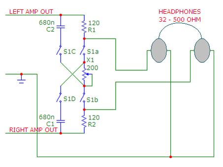

Simple working crossfeed
Attached is a simple crossfeed behind the amp which complies to all the requirements posted. Series resistor of 120 Ohms plus cross feed with varing amount with phase change.
This is a constant volume device and crossfeeding will not alter the perceived volume. You can introduce as much phase change as you want by altering capacitor values.
Headphones of any impedance will work equally well.
It remains simple and I take it everyone can figure out what is cutting here.

Nico, the crossfeed circuit you incorporated gives 120R series feed, phase change as required (and a couple of sockets could be used to mount the cap, so it can be changed). We need only insert the mute circuit proposed by Paul B. The layout looks very logical; I would propose the output devices sit at the rear, between the RCA inputs and the wall wart input (24V, not 14V, I want more headroom) and bolt up to the rear of the diecast case, so the depth of the pcb and how the controls work on the other side is critical.
