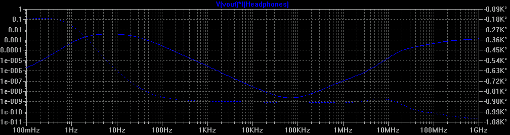

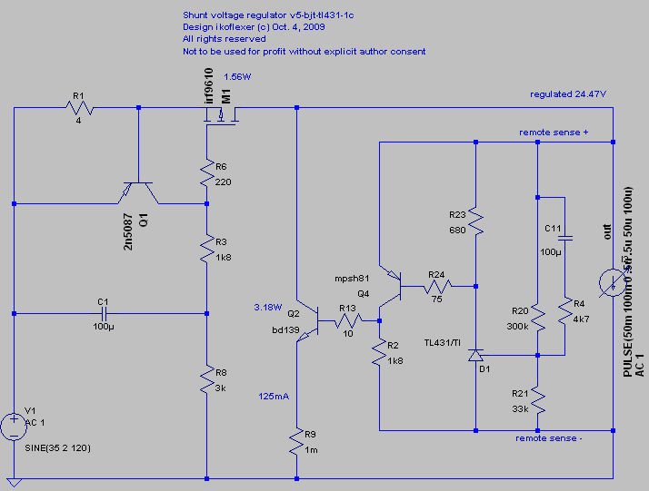

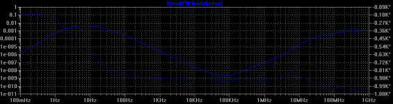

Here is my next version:
1: CCS was replaced with 2Q version. This one is soooo much better than the DQ versions. This change isn't really major.
2: CCS is made of 2N5087 low-noise transistor; same family as the MPSA18.
3: CCS is bootstrapped. This again helps isolate line noise.
4: all the above improvements make no major difference. 😀
5: Pass transistor is cascoded through the LED (so we still geta power light). Line noise disappears COMPLETELY with this addition.
6: Load regulation is still not that great. This can be fixed easily by putting the 431's voltage divider at the emitter of the pass transistor. Then there would be nearly perfect line and load regulation. But this would introduce global NFB; is this something we want to risk?
So this is what I suggest.
1: Keep the CCS in just to be safe (it does improve line regulation insignificantly, not to mention varying current through the LED would cause wandering cascode voltage, possibly ruining the cascode advantage).
2: Cascode the output device. This destroys line noise. Also, we might be able to get away using even a cheaper, faster TO92 device for the pass transistor because it dissipates less than 1W of power.
3: If there is still not enough load regulation (it is actually quite poor by my standards), move the TL431 divider to the output, but put in a healthy amount of HF compensation to avoid HF peaking/BW-related distortion; this isn't a problem if our decoupling caps are good. I feel this is a good compromise for audio.
Good luck,
- keantoken

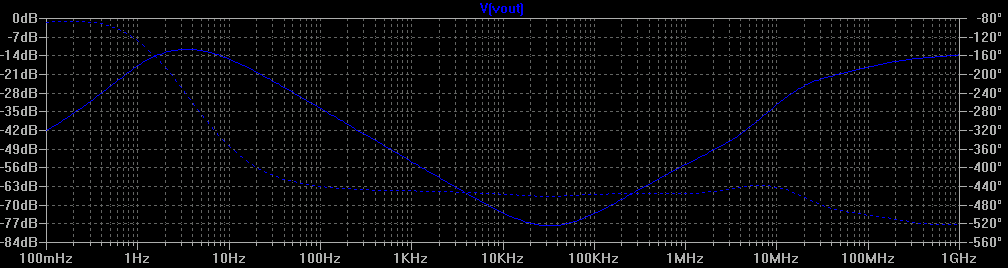

Okay, here is a more useful PSRR plot: watts into 32 ohms. This is exactly how much power goes into the headphones, so for 100db/mW, we really need some sort of regulation.
EDIT: Oh, and Bigun, I drew and use a different inductor symbol, because I absolutely abhor those pathetic quirly loopy-loop scribbles that take up way too much space 🙂faint🙂. So no problem, I'll just readjust the inductor positions. (just a style clash, that's all 🙂)

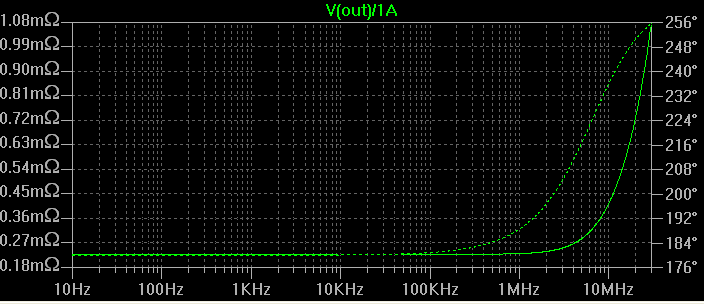

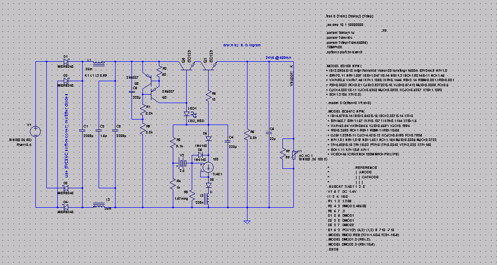

Okay, to summarize:
1: Bigun pointed out that line rejection isn't major, which probably makes the output cascode not so important. (the pass cascode makes line rejection below -105db though!). Nico's tests seem to confirm this.
2: Load rejection really needs help (though we haven't quite decided whether load rejection is really important for this circuit or not).
3: I don't see a problem with using a CFP style output, but others seem to really not like the idea. So the most probable method for increasing load rejection would be to put the TL431 divider at the output, which would give better results than the CFP anyways.
Here are the specs for my version of the regulator:
Line rejection: below -105db across the audio band.
Load rejection: (I'll put this in terms of ESR since the AC simulation won't work right).
.37 ohms of ESR.
With GNFB, the load rejection goes to 1.7mohms of ESR, equivalent to about-55.5db. Attached is the schematic I used. GNFB strips out any chance of capacitance multiplier affect, unless we bypass R3 with a capacitor (which may add odd transients during start-up, but would also increase load rejection). C4 ensures slow start-up, but still adds a little more loading to the TL431 through the 220 ohm resistor (doesn't produce a large difference).
I apologize for not being present during day hours. This is largely because of school, but I also haven't been able to get to the computer so much.
- keantoken
Realistically we're not talking about half an ampere here. Is an extra 125mA too much of a price to pay for outstanding line and load regulation, from a very simple circuit, and parts that are easy to find? Very wide bandwidth too, not that it would be necessary.
Of course, it comes down to personal choice. This would be mine.
