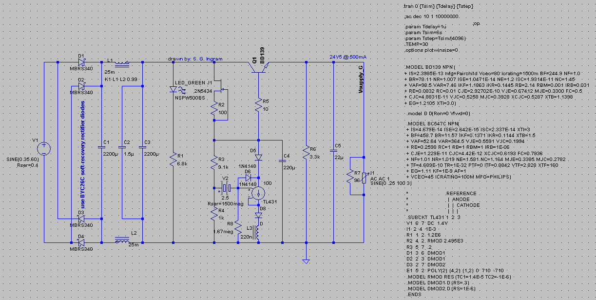

Hugh also sent me the file.
One thing I might be wary of is C4. The TL431 is essentially an amplifier, and all amplifiers need some sort of stability compensation. I used such a capacitor in a schematic once and was told to delete it because it would inject noise into the output (not to mention all capacitors have some ESL).
To be safe, I might put a 10 ohm or even 100 ohm resistor in series with C4, which would keep the TL431 more within it own BW limits, making stability compensation more effective. I don't think this would have a large effect on performance. This is purely theoretical and untested, just a brainfart by me perhaps, and I doubt it is necessary.
I am content with Hugh's schematic.
I am not sure how much DC contamination can be expected on an AC line, but such a capacitor might be expensive as it would have to be non-polar.

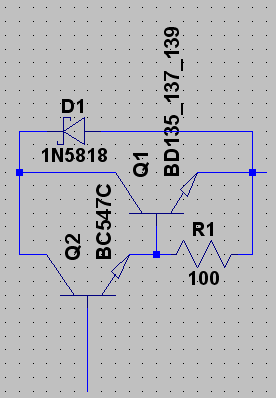

Update.
Hugh said in his Email that a Darlington would be a good change (though I personally don't know that it is necessary, and it would potentially increase output impedance).
So here it is: Reverse bias diode for protection, 100 ohm bias resistor to keep the master transistor well within its current range.

The PSU as it is will have slow turn-on, except that the TL431's output will jump to 2.5V immediately at turn-on, until C4 charges up. I recommend that we delete C4 and instead use a separate capacitor entirely in parallel with the TL431. This way, the TL431 will only turn on when it reaches the nominal voltage, with no thumps. This way the TL431 will also have some form of local decoupling.

My sims showed a rather quick turn-on too, followed by an under-damped movement to the final output voltage. I wasn't too confident on the device models I used but it didn't look good and ripple was above our target.
Stability - I'm trying to figure out if there is an issue. It's worth looking at the data sheet [http://focus.ti.com/lit/ds/symlink/tl431.pdf]. I think C4 was positioned where it is to provide a slower turn-on and using it on the reference input to the regulator potentially gives it more leverage over the output voltage = lower cap value. I'm not sure if affects stability, it couples the +ve input of the 'op-amp' to the equivalent of it's +ve supply rail ?
Hugh says he's tried this circuit with success and that's always a good sign.
HOWEVER....Putting C4 in parallel with the shunt regulator reverts the design to something that's closer to a simple Capacitance multiplier - which I'm much more comfortable with understanding the functionality of. And since he's away for a couple of days we can wreak some havoc 😀
So short answer is yes - I agree, let's move C4 and put it across Z1.
I'm not convinced of the need for a Darlington pass device either.

The more I look at the sims, the less I like it. Ripple is way too high. Oh dear.....
It's the CCS that I don't like. I have stripped it out, left in the LED as a power-on indicator. The voltage divider feeding the shunt regulator reference is fed via a simple resistor and C4 is put across Z1 so that we now have a classic Capacitance Multiplier.
Hugh - we are mutineering !
The simulations look simply wonderful. Turn-on is smooth and slow, the ripple is simply 'gone' !
here's the sim. file.

Taking out the CCS doesn't make much sense to me... What exactly is wrong with it? The CCS very effectively isolates the output from line ripple. Perhaps we're being too purist here...
We could at least use a Jfet CCS. The CCS cuts down loading on the 431, which already has to contend with the transistor's base current.
EDIT: okay, I've looked at the sim, and the TL431 is just dead... totally nonresponsive... I don't think it's working!!! We should get the model working before we do anything else...

Okay. I'm not sure if it was necessary but I put together a model that should work reasonably well for the TL431. ESL was guessed, dynamic impedance is based on the datasheet which says .15 ohms (ESL is determined by the G-source's gain).
Let's look at this. It takes .5 seconds to warm up, so I think we're a go here.
I was too lazy to even look at the model included in the schematic... (and my grandma always say'd, "lazy people work three times harder!") 🙂
I also added reasonable values for ESR to the multiplier cap, so we're not too optimistic.

Sorry, there is an error. V2 should NOT have a series resistance of 1500megaohms! Delete that.

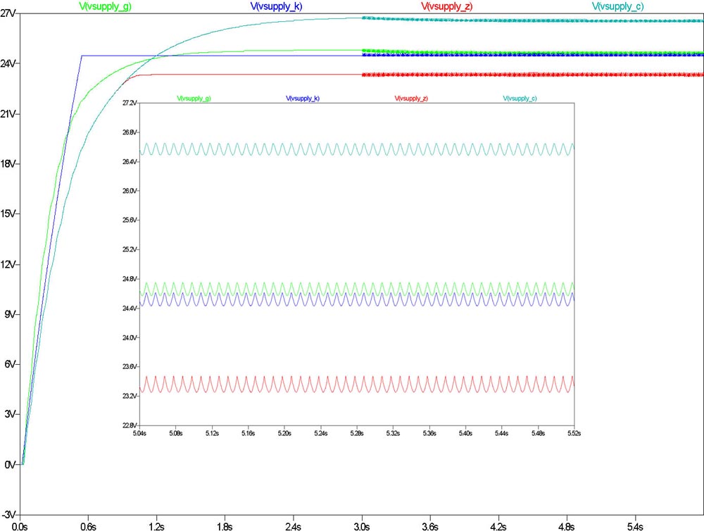

Keantoken,
I ran your simulation (strange, but the inductors were all out of position, some incompatibility between our versions of Spice ?). Your model was nicely done. I like how you added a sinusoidal load, very neat.
I added 3 duplicates of the circuit to my simulation file. The original one I labeled vsupply_K (after you !), the next one as vsupply_G (after me) which replaces the CCS with a simple resistor, then vsupply_Z which replaces the shunt regulator with two simple 12V zener diodes in series and finally vsupply_C which removes the zener diodes for the simplest possible cap multiplier.
The attached plot shows the results. With a CCS (dark blue trace) the rate of flow of charge onto C4 is constant so the voltage ramps up close to linear (as expected). All the other traces ramp up without a CCS so the rate of flow of charge onto C4 depends on the voltage on C4 and is therefore exponential (as expected).
The cut-out in the centre of the attached plot is an enlargement of the supply rail voltages near the end of the simulation when the sinusoidal loads are active.
The basic cap multiplier puts in a good show.

Bigun, load regulation will be the same in any case unless we do one of two things, or both:
1: Put the 431 voltage divider at the output, introducing global NFB.
2: Use a CFP pass transistor configuration.
So what we're worrying about right now is line regulation.
