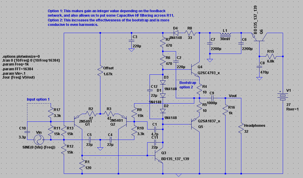

Okay, here it is...
I really feel like I'm forgetting some options...
I think the modified bootstrap is agreed upon, but if anyone has any objections say them now or forever hold your peace... If you want my reasons for the mod, look at ratio of Ic(Q3) to I(R6) with and without the modified bootstrap (you will see that the VAS works much harder without the mod).
The input option would enable us to filter out dangerous RF by placing a small cap across R11. It would also allow us to have an integer value of gain, say exactly 10 if we used a network of 10k over 1k ("yeah, but what is the gain?" "it is, uh... 7.648, I think"). For this to work, R17 must = R10 and R11 must = R9.
I didn't include the crossfeed for lack of schematic.
- keantoken
- keantoken
I want to draw attention to the schottky idea...
Please look at this schematic. Even on transients no transistor turns off, preventing crossover tranients.
It could be modified by putting resistors across the schottkys, or by putting a resistor between the OP emitters.
- keantoken
- keantoken

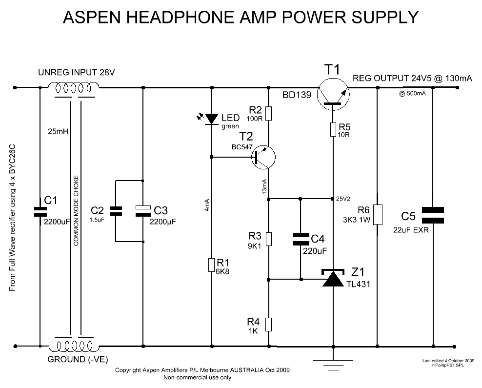

OK, I have received from Hugh his favoured design for the PSU.
Nico has suggested a dc blocking cap on the transformer primary to remove local dc contamination of the AC mains. And also suggests adding a protection diode across Q1 in case it's inadvertently reversed biassed by wandering screwdrivers etc. during 'testing' ... sounds like a good option to me.
Hugh recommends the BYC26E soft-recovery diodes for the rectifier (or UF4001) - I've previously used the BYW 29E units which are equivalent singulated diodes.
The shunt regulator, Z1, should be a TO126 (or better) version with a small heatsink to source the base current required for Q1. The power-on rate is controlled by the current flow into C4.
The 'last capacitor', C5, will flow the bulk of the a.c. signal and should be of high quality (Hugh recommends EXR Hitano, with film bypass if so desired).
I've coded the design into Spice - files attached. I'm not that happy with the results which I feel are not representative of the circuit performance, being constrained by poor device models (embedded into the files). So feel free to improve on the sims.
No doubt this is a much higher performance psu than the simple capacitance multiplier I started with - gotta love how things evolve beyond what you thought was possible.
Keantoken - I like the optional bootstrap take-off point. Have you looked at the impact on FFT harmonics over a range of frequencies and signal levels - does it 'hold up' ?
