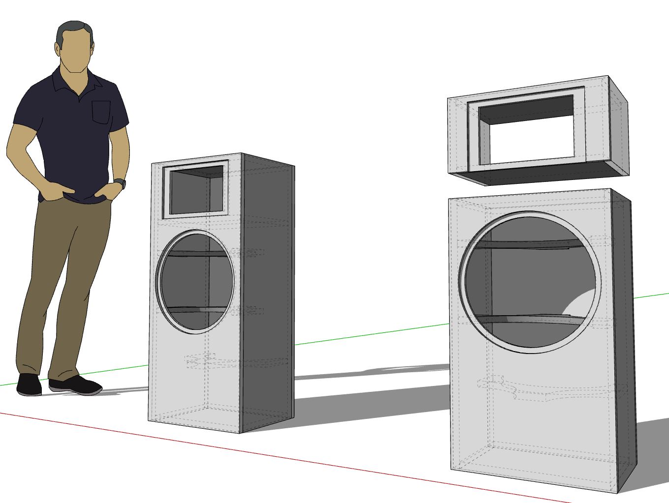

I have JBL le14a ewave with the d220. Is this a similar idea? I used my old l55 cabs which I don't think are the idea cab size. Yours look much better!🙂
As I understand it, the Econowave project began as a HF compression driver and waveguide based solution to any woofer in a box you had... Such as an original Advent etc. Then it snowballed into different versions designed by Zilch (RIP) and the experiences of others.
This lead way to people building off of the concept, tailoring things to different driver combos and whatnot. The idea of a large 2 way speaker goes backs fair ways before the Econowave, but it's safe to say the Econowave was a pretty inspirational project that not only taught, but inspired people who realized a good speaker can be DIY'd with minimal complexity, although it is a complex process.
For the LE14a, I would assume there is an ideal alignment and enclosure size for that driver. I would start there. Great unit to be working with BTW.

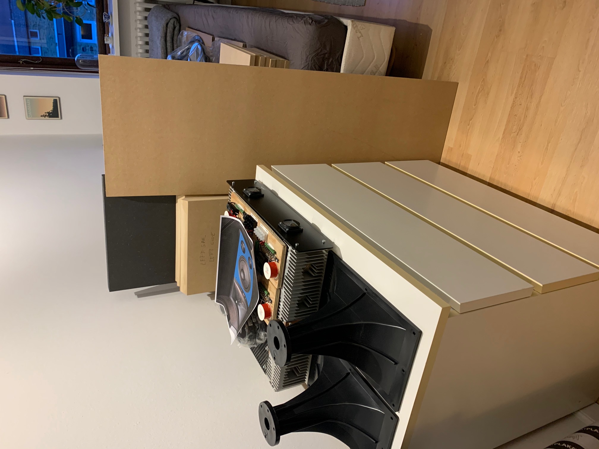

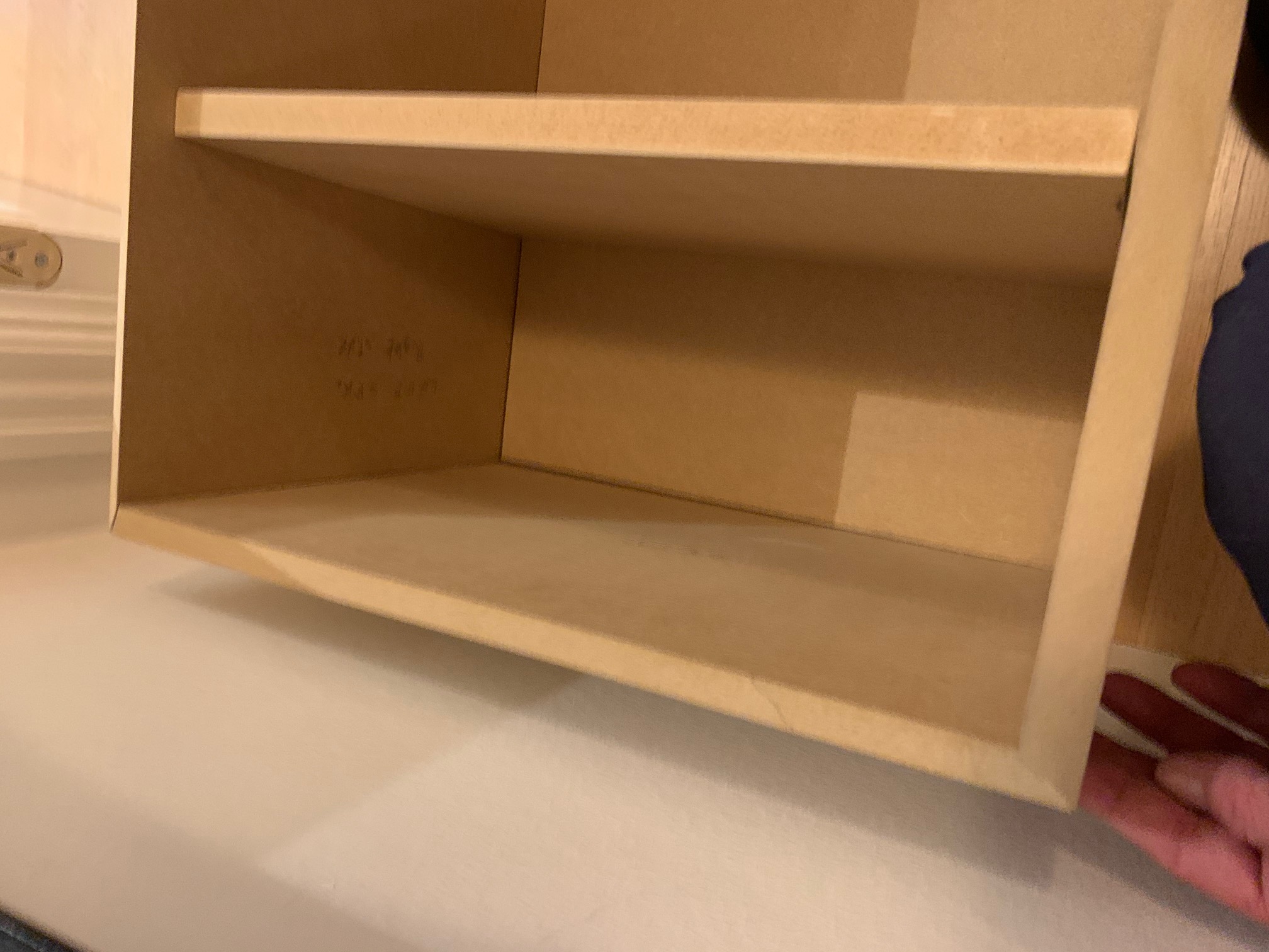

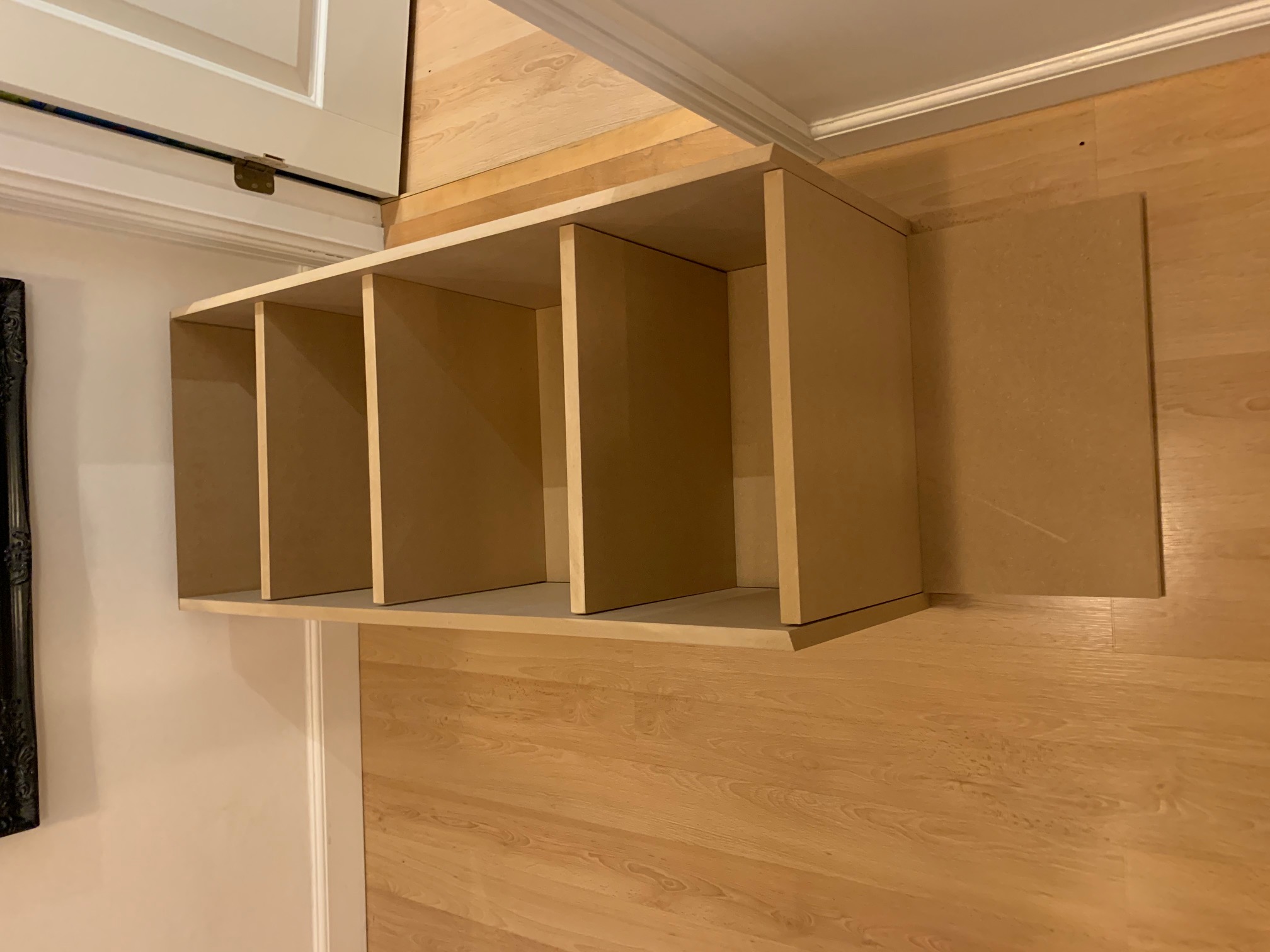

A little progress
Hi here...
I was lucky, the weather was somewhat good and perfect for cutting some sheet's outside last few day's 🙂
I'am actually satisfied with my cut's so far, but i'am for sure not the fastest Carpender around here... I would for sure be starving if this was my everyday work.
I used a lot of time getting the measurement's and marking right, someone here i read suggested using a knife for marking, and this is working way better than with good old pencil's.
Here this afternoon i "tested" my build to see if it would look right, and as i wrote earlier i am satisfied for now.
Jesper.

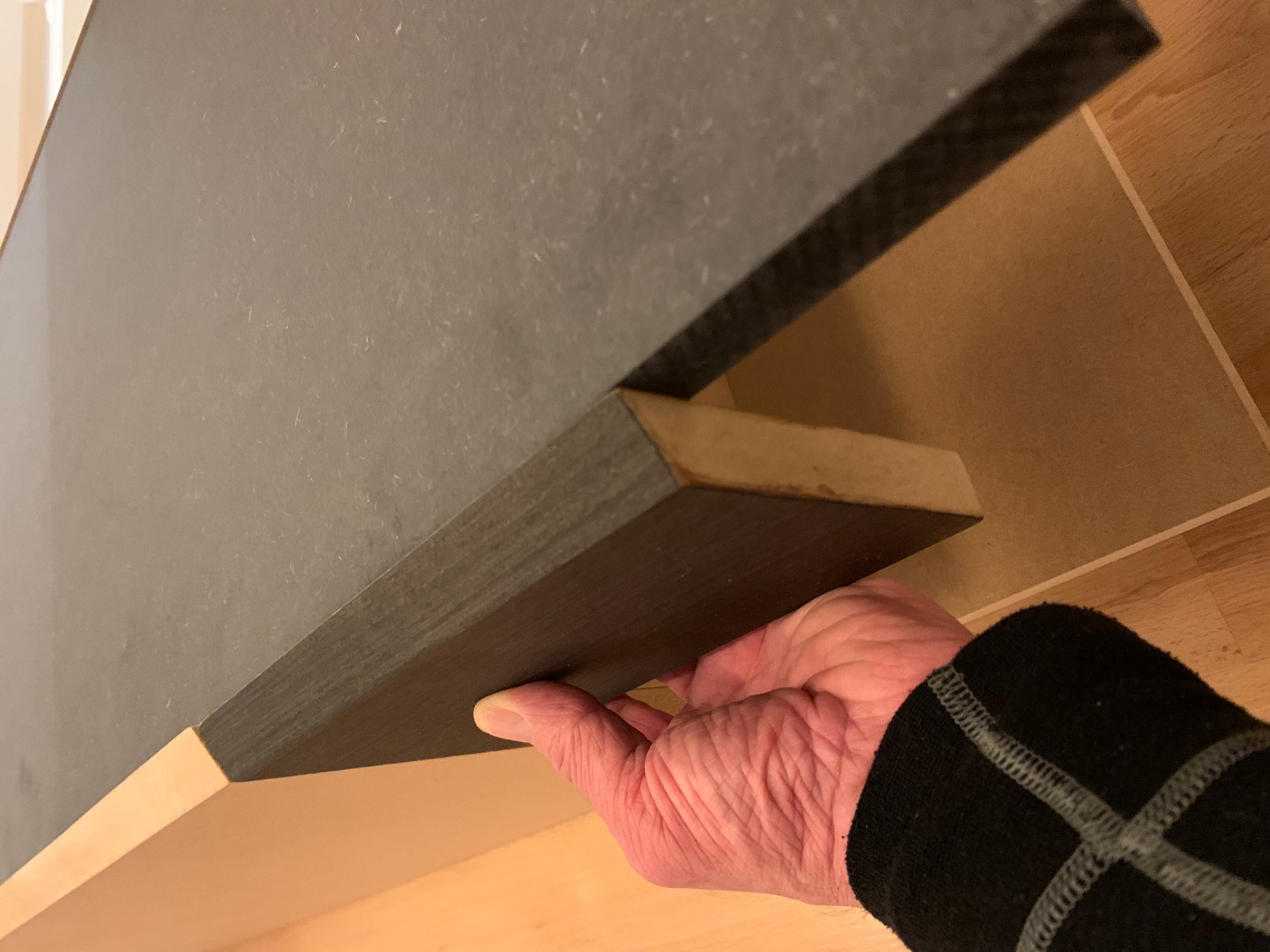

Colored MDF baffle? Valchromat? Wish I could find that locally. Looks nice.
I'm getting a weekend alone in early May. Hoping weather will cooperate for me as well.
ultrachrome ::
Yes black HDF (HighDensityFiberboard)
This is a quote from Troels Gravesen's site
Good luck... Jesper.
Tips and ideas Copyright 2012-14To the best of my knowledge the black MDF is the same as the product sold as Valchromat, having a density around 800 kg/m^3.

Still agonizing over how I want to build the cabinet. I like the idea of having the waveguide in its own box for future proofing but that does increase complexity.
