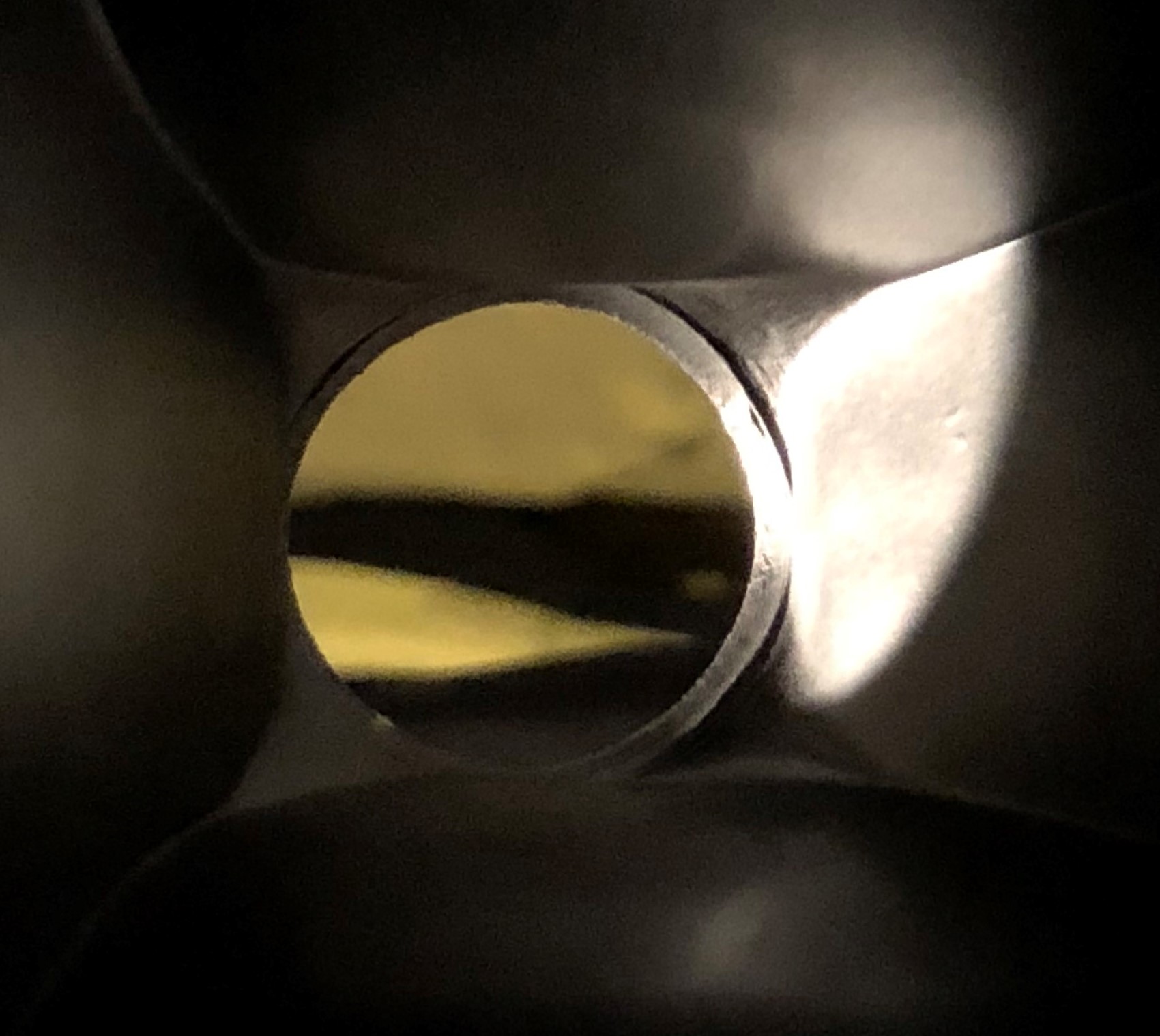

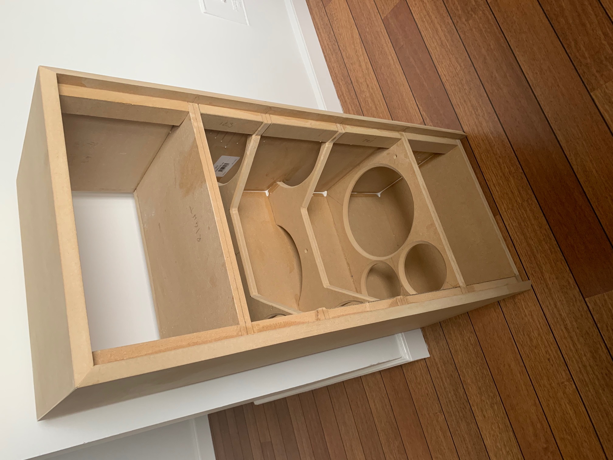

Should I be concerned about the lip where the corners meet in the throat?
What about cabinet treatments? I was going to use 19mm MDF with the prescribed braces. Would any wall treatments like dynamat be advisable? How about for the waveguide
The lip can be an issue. It may sound OK as it is but I would fill it, or file it. There is already a shape compromise there with the corner filling, but there isn't a lot that you can do to make that kind of transition other than like that.
Dynamat, both on the walls and on the back of the horn, is recommended.
I would grind off sharp edges on the throat. You can also fill in the corners, but that is very laborious and does not help much. We compared the Monacor MRH-200 with the Celestion Horn. Both are almost identical, only the Monacor has completely filled corners on the throat. It measures a little better, but makes no difference in practice.

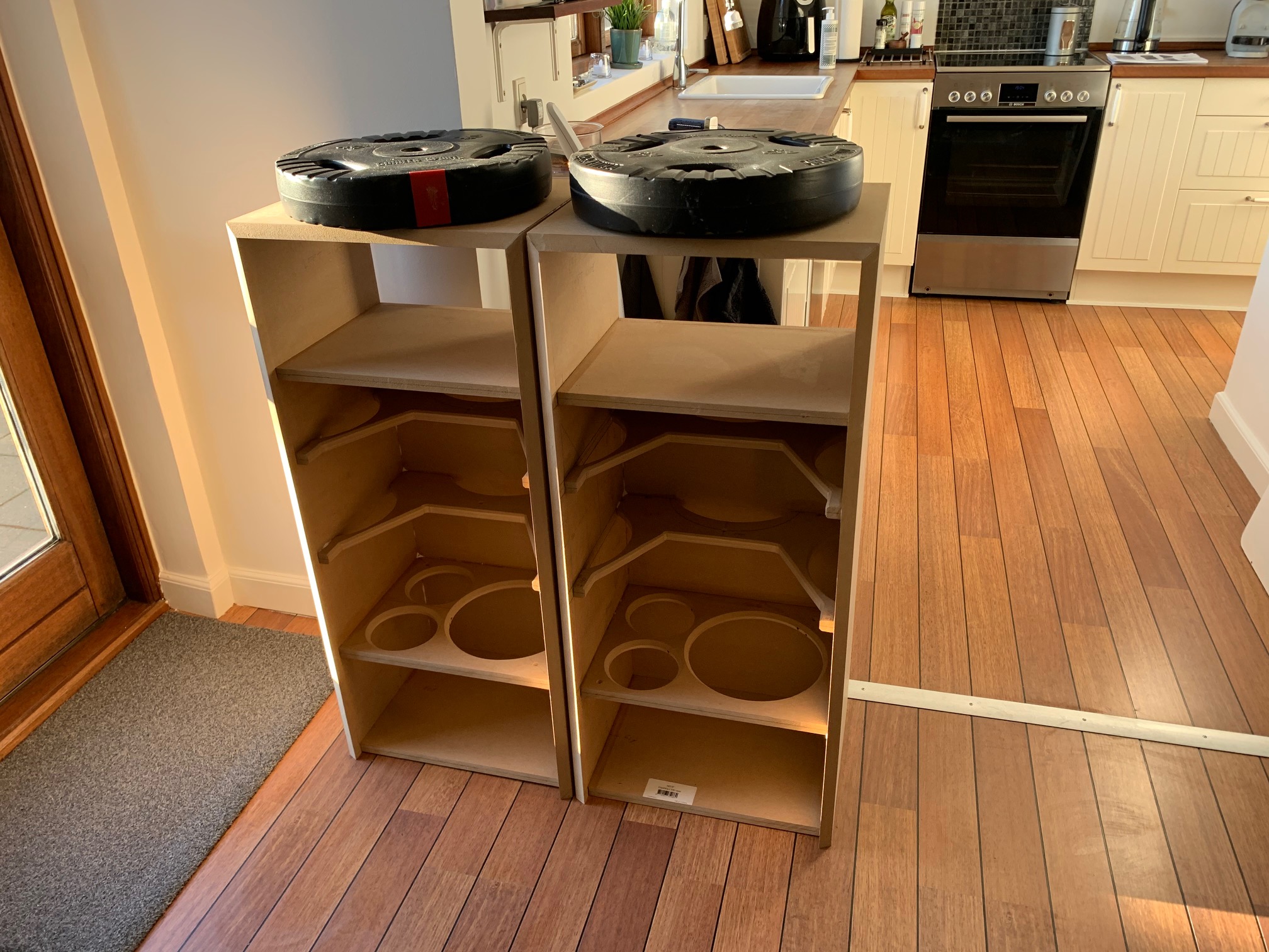

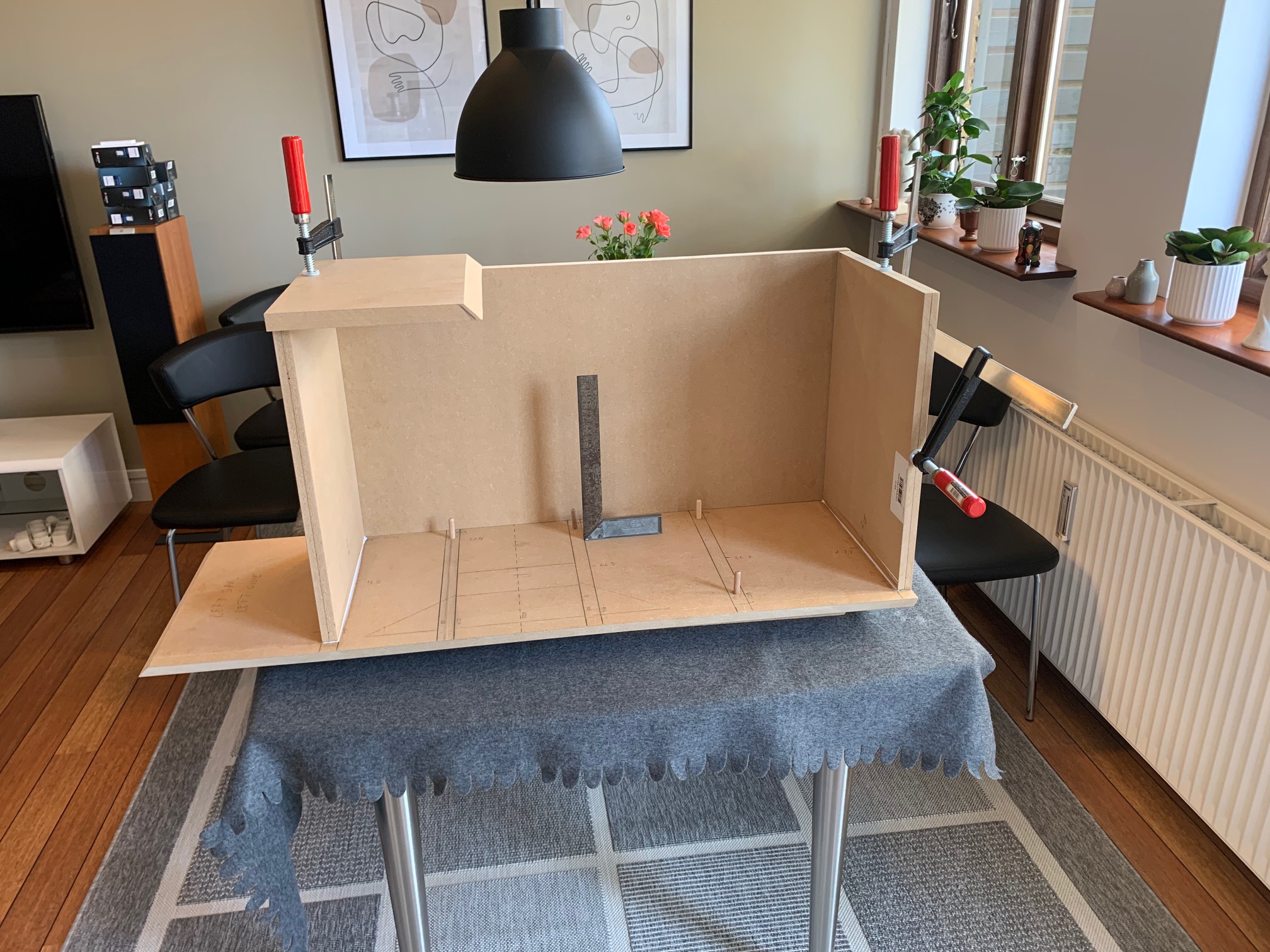

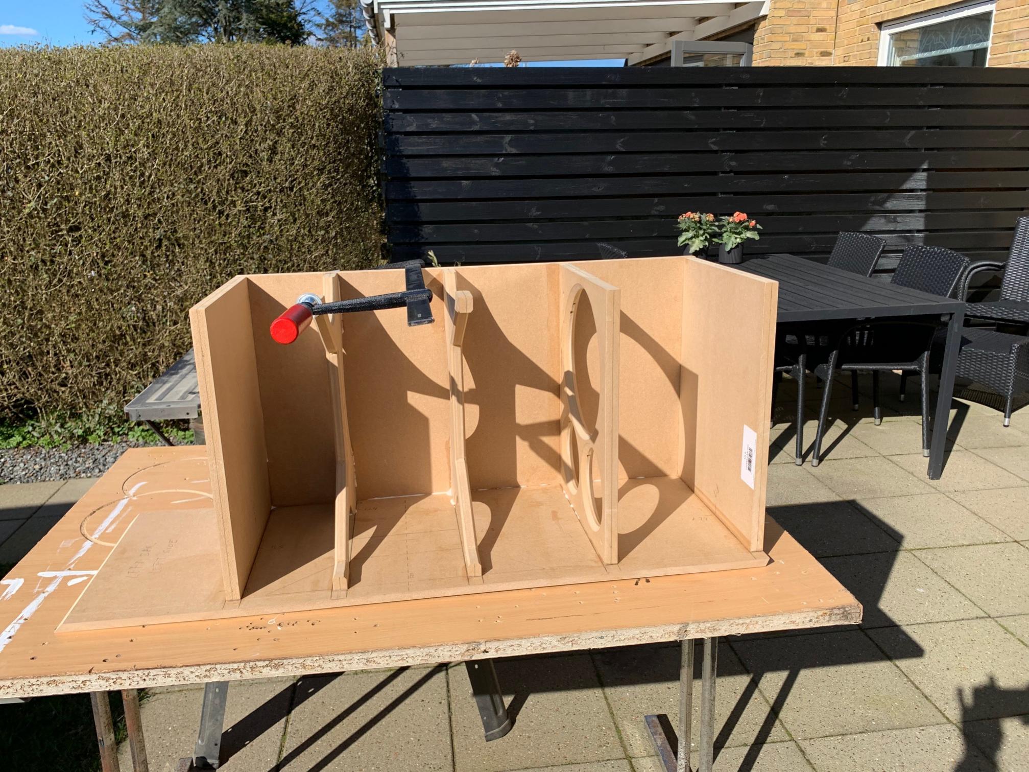

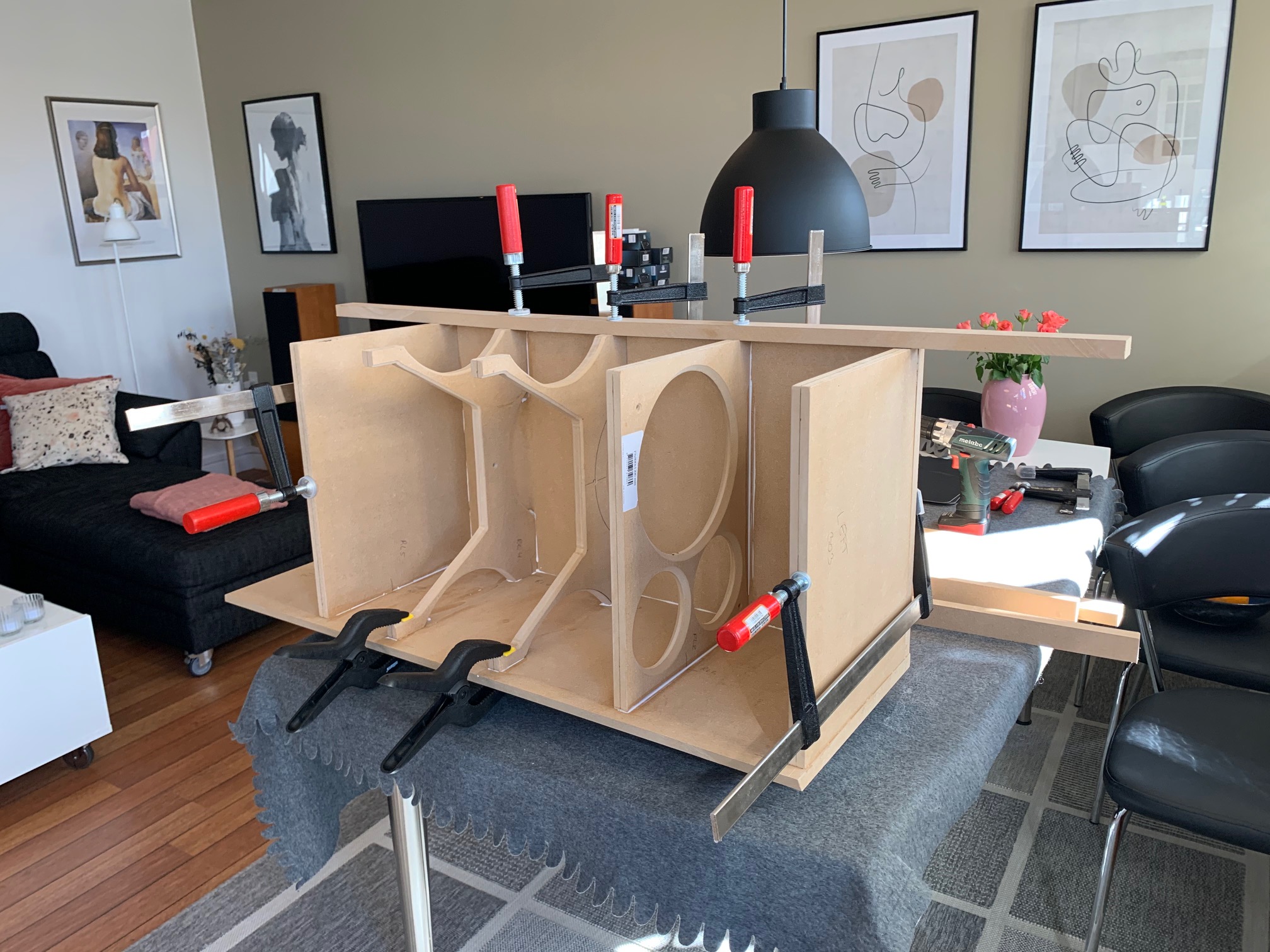

Some build progress
Nothing special, just some pic's.. I allway's like pic's... so cozy 😀
Jesper..
Jesper..

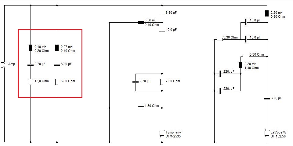

For tube amps I have now made an impedance linearization, marked in red in the picture.
Unfortunately, two RCLs are necessary for this, but except for the 82µF cap, all components are very small and inexpensive. For the Cs, electrolytic caps can be used without any problems. The resistors should be 20 watt types.
Great Rese66 🙂
Am i right that the 2,2mH (1,4ohm) + 440uF (2x220uF) + 3,3ohm is upside down on your'e new schematic, compared to the first one you posted (also i'am pretty sure that it dosent matter at all when it's crossover's)
Jesper.
Jesper.
Yes, the order does not matter in this case. I changed that because it was easier to read in the plan.

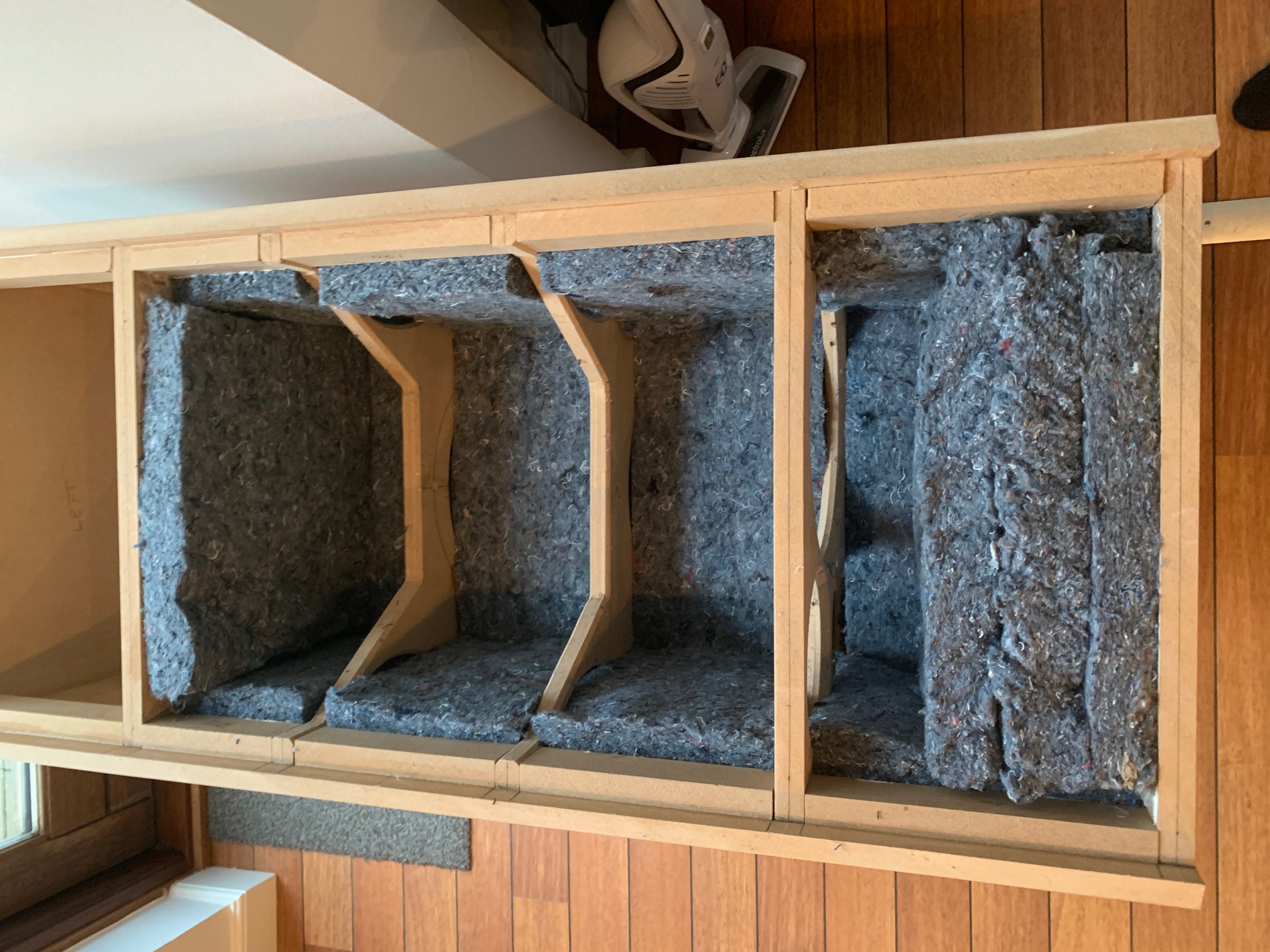

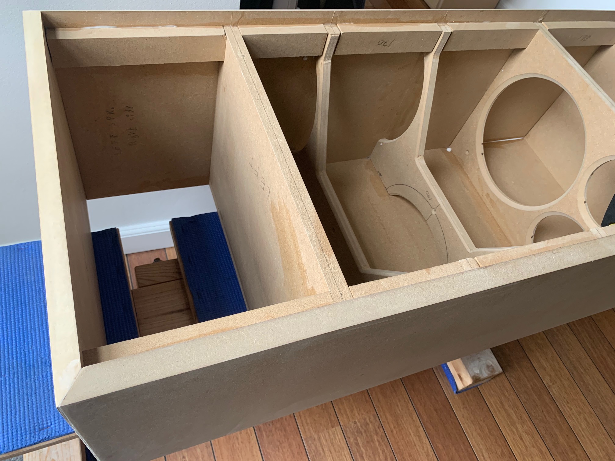

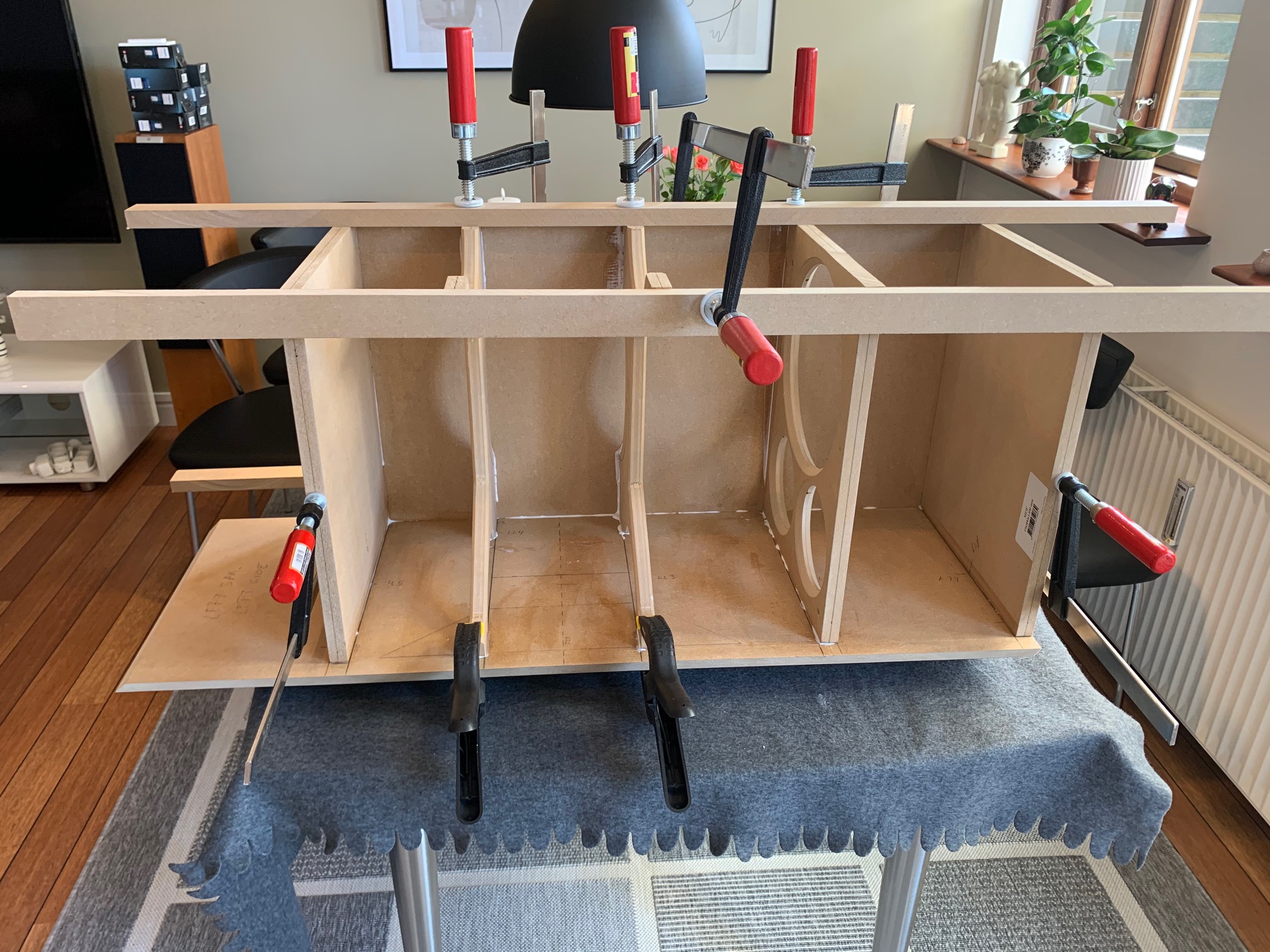

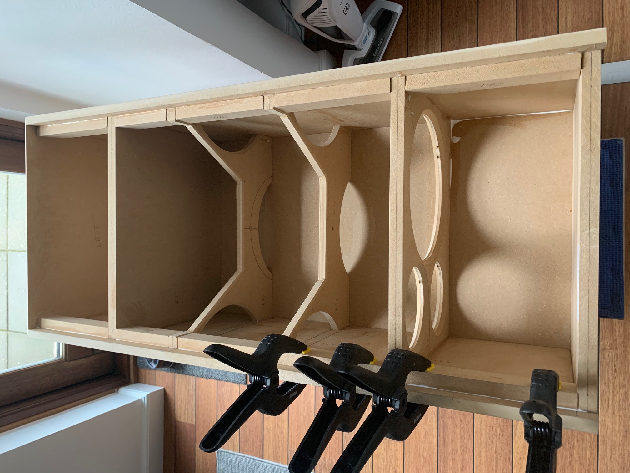

Just one question regarding your 2 pieces of bracing for the woofer. Why did you cut out the area close to the center of the speaker walls and keep the corners braced?
Usually you brace the center of the walls, because this is where there is the most movement occurs (=vibration of panels) and to reduce the length of the vibrating wave.
Maybe there is something I am not understanding, but I would glue those circle pieces back in and to give it strength add a little strips of wood to connect the circle slices and the bracing and wall you have, either vertically or horizontally or both.
Reese's bracing seen inpost #34 has the bracing cover the center of the panels as well.
If you think your corner joint is not strong enough getting 45 degree strips into the corners can help but the main reason for pracing is to reduce the length of panel sections that can vibrate, else you will have more of a secondary membrane effect. This can be interesting if this is what the designer wants, but here being a closed box I am not sure it would be beneficial.
If you have some acoustic damping left you can use it in the horn chamber, but it is not needed. More important will be adding some alubutyl to the horn and other factors. If you want to brace further you could add a north south brace, a (or better two) simple piece(s) of MDF into the horn chamber connecting the top of the speaker to the top of the woofer chamber. All nice touches but not necessary.
Cheers

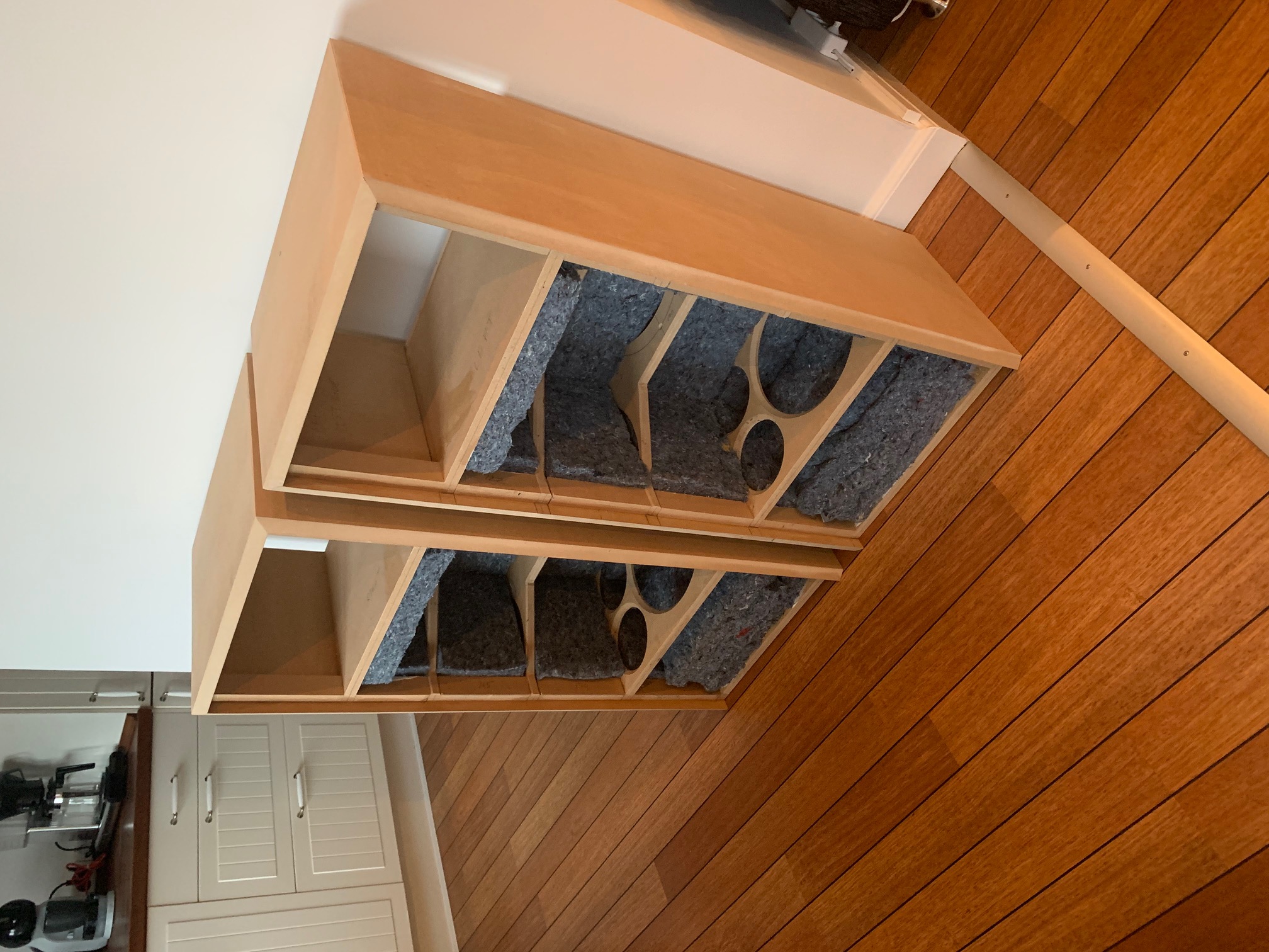

tubeglow49...
Thank's for the advises.
While i allready glued in the daemping material now 😱 - I guess i'll leave it for now through.
I simply didn't know this, and i thought that making the brace's like this was best, also to hold it on the corner's as you also describe.
Not that easy to redo now, but let's see?
Btw. :: I still have to goto IKEA and grab them "Inner" pillows, ripping them apart and fill it in, but i guess i can do that even if i do the front baffle.
Jesper.

@lykkedk
Wow you are making some good progress there.
You can test if you hear any difference between the top two braces and the bottom one by knocking it with your knuckles and thumping strongly with your palm. See if you hear a big difference in the area around the top braces and the area around the bottom brace. If you do then you can still add cross bracing, or incresed bracing with some pieces of wood. You can get the insulation off with a spatula and then reapply it the inside of a speaker. Don't worry too much not the end of the world.
For additional bracing in some speakers e.g. some Klipsches, you take a knife cut a rectangle and remove a strip. If you used tile cement ala Troels this might reguire a wood chisel or screwdriver.
In your case you can use the circular cut outs by the walls and push a piece of wood towards the walls with an F clamp. One end in the circle hole the other pressing the wood towards the speaker wall.
The issue is that in a closed box speaker the pressure inside the chamber is larger than with a BR or Passive radiator. And you don't want the walls to act like Passive Radiators. But if you chose thick MDF this all might not be a big deal.
Hope this helps and looking forward to your progress.
Cheers

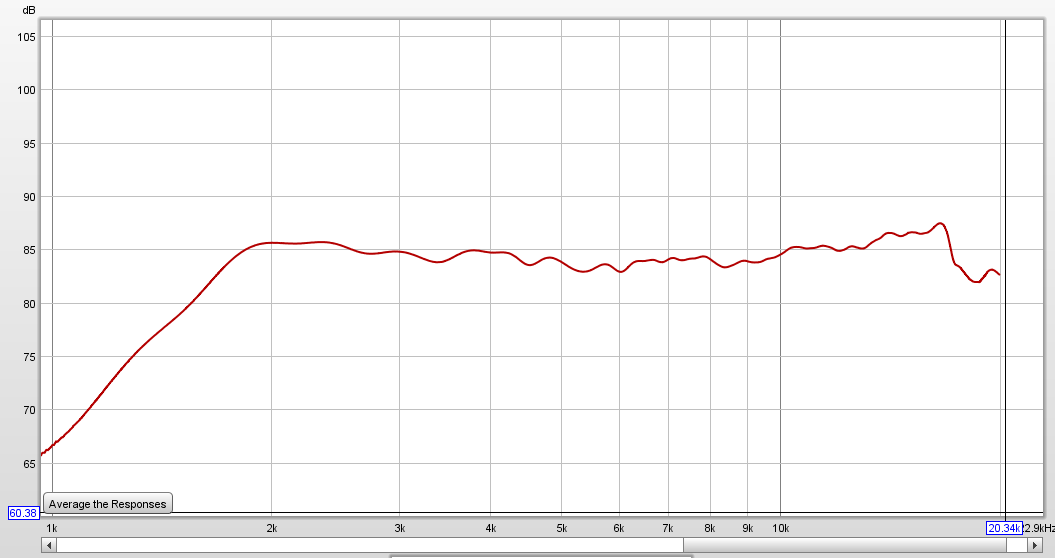

I wired up the tweeter crossovers and did a quick measurement.
My response seems to be rising at 10k compared to Reese66's. I see this with both drivers.
Specified XO values compared to my components measured with DATS v3 that produced the attached response:
6.8 uF -> 7.346 uF
10 uF -> 10.68 uF
2.7 uF -> 2.886 uF
.55 mH -> .5284 mH (.4748 ohms)
7.5 ohms -> 6.966 ohms
2 ohms -> 1.868 ohms
The second tweeter has nearly identical response and the component values are very close to the above measured values.
Any idea which components I should look at?
