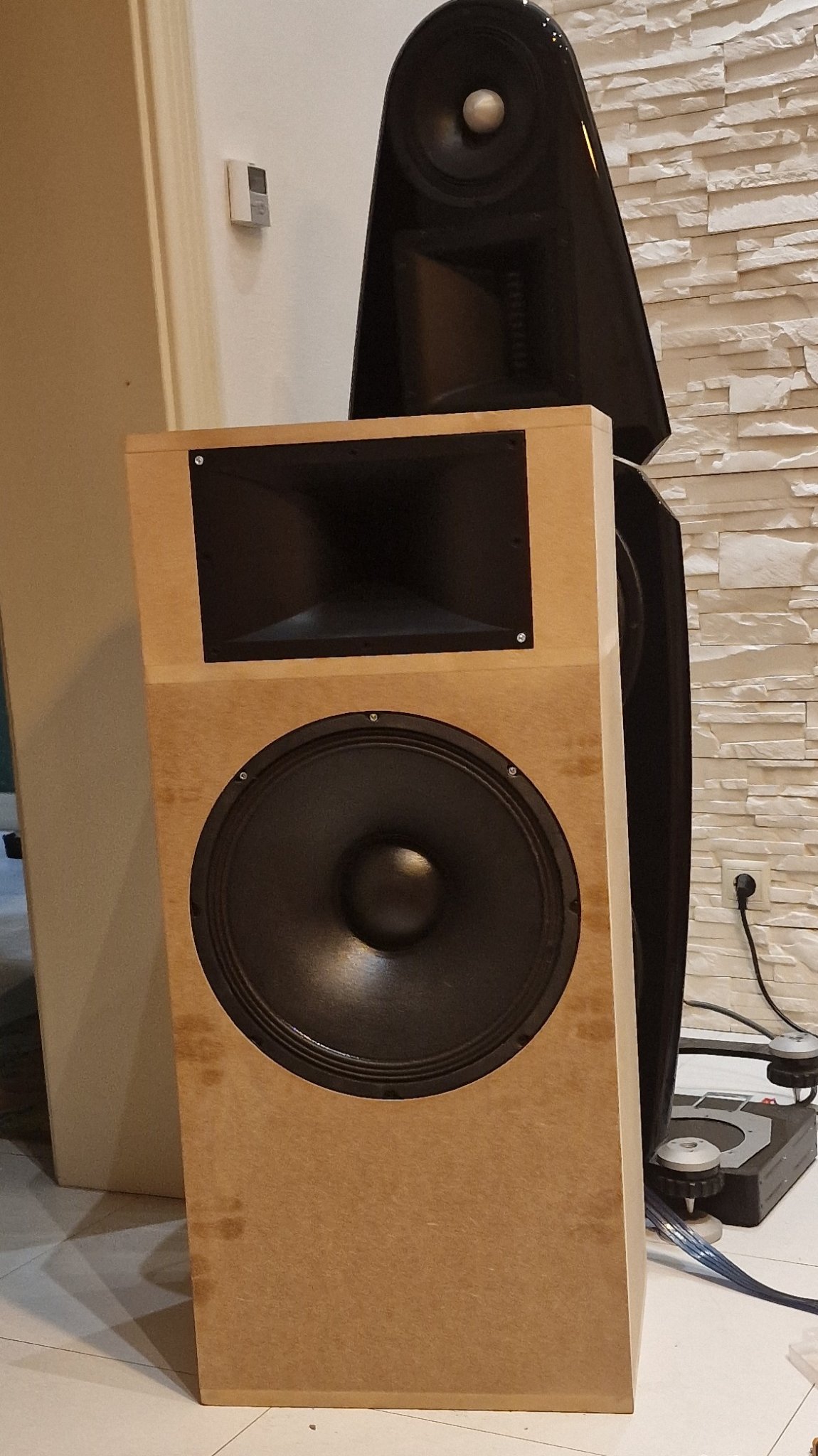

I was very curious about the sound of these speakers and I finally finished Asathor. I was surprised by the sound, very balanced, dry bass, voices without harshness. Very satisfied. One question. If I wanted a slightly airier sound (as if I wanted a little more brightness in the voices 🙂) ...is there any possibility?
Thank you.

Yeah, replace the CD+horn to an AMT or ribbon.
Nothing but pure nonsense.
I forgot to mention that I used LaVoce F10.172M for treble
There is.

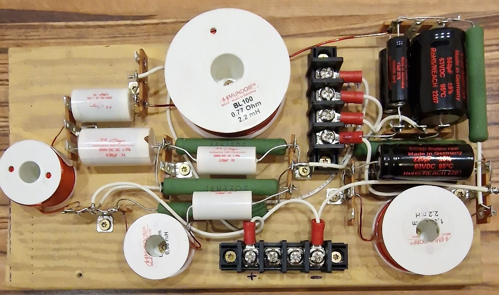

You could try to reduce the 10 ohm in series with the 172 to 8,2 or 7,5 ohm.
Or add a small amount of "mid-range" by increasing the 6,8µF series capacitor to 7,5 or 8,2 µF.
Both options will give you a precieved impression of a more "airy" presentation.
To avoid going back and forth, I would first try the resistance option. Make a switch on the back for 10R, 9R1, 8R2 & 7R5.
That way, you could change option according to the music, you play 😉
Of course, you could do the same with capacitor values. Have a combination of both.

I would not be to hasty in adjusting. If you are not used to the sound from this sized speaker with strong directivity, it might sound a less "airy" than a traditional smaller speaker that is a less directionality.

Thank you very much for the suggestions, Boydk , today I ordered the whole set of resistors and capacitors to try.
But I want to say that I think I could live with what I hear now, I've been listening to different genres of music all day. Very relaxing with a surprisingly nice bass.

Thank you very much, I'm delighted that you like my Asathor.
Boydk has already given you a few options for customizing it to your taste. Just try it out and if you like another value in the x-over more, everything is fine.
poleepkwa is also right. Speakers like the Asathor don't sound airy enough for many people at first because there aren't as many reflections in the high frequencies.
Once you get used to this, you may suddenly perceive speakers with a wider dispersion as somewhat diffuse in comparison.
Cheers

I went the other way with the Asathor´s. I found them a little bright (Peerles/Tymphany CD) and lowered the cap. value (very little)
and increased the series resistance instead. 99% happy customer now.

You have to note that the x-over circuit in the Albany has a significantly different structure. The woofer is wired with 24dB and LCR, with the Asathor it is only 12dB plus LCR. The x-over of the tweeters are similar, but in order to generate a correct sum, the polarity has to be reversed.
