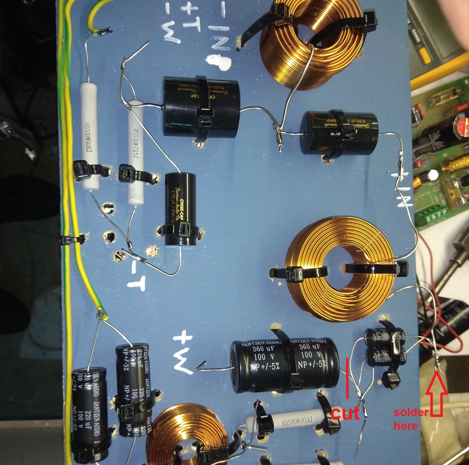

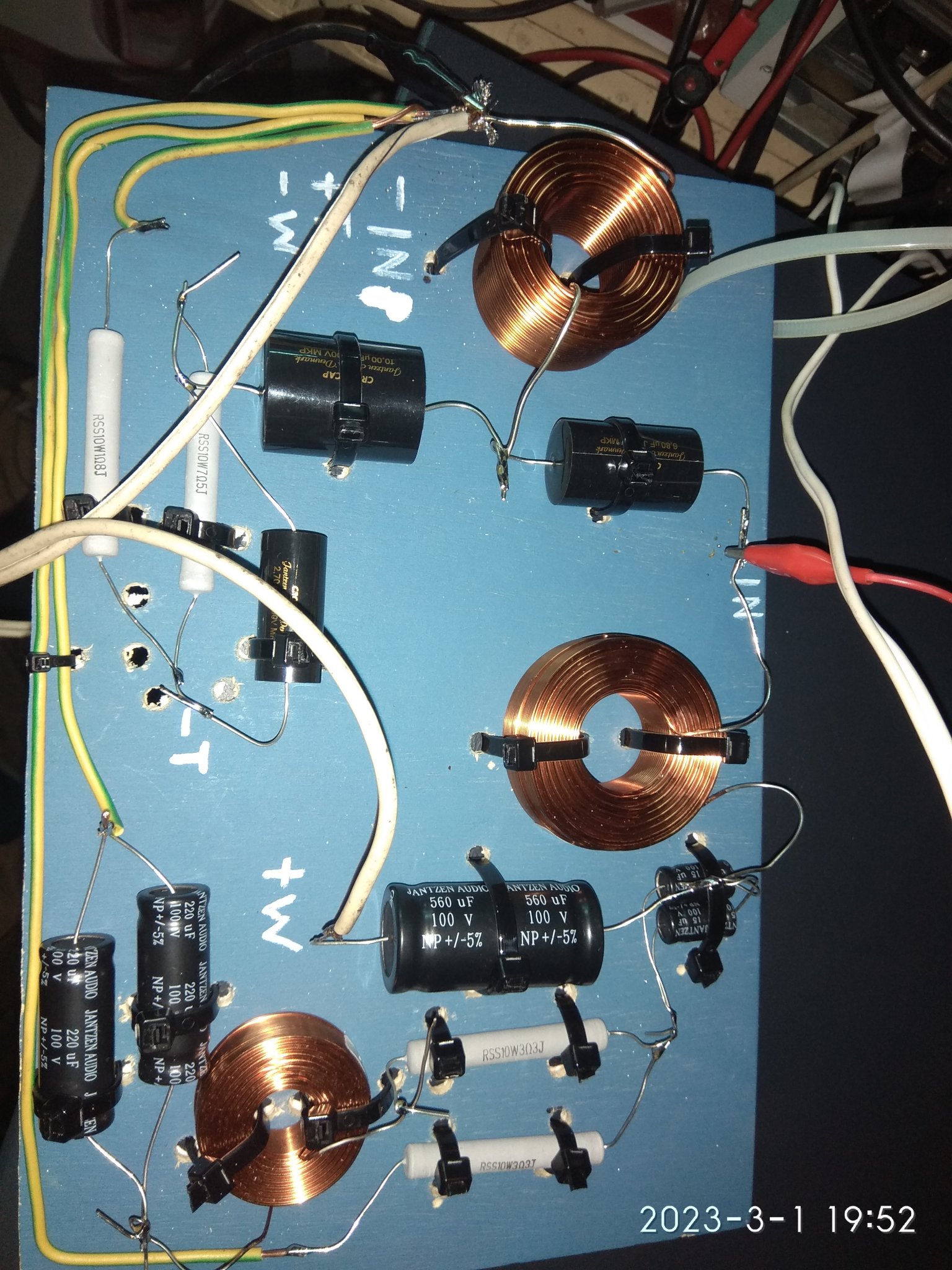

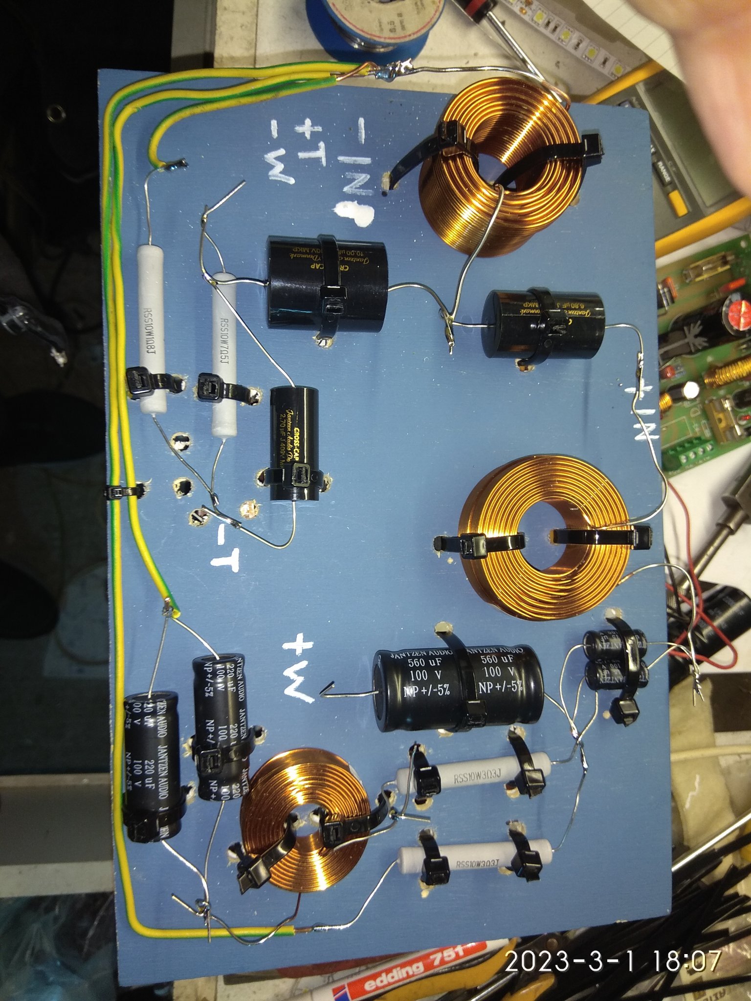

A very first configuration to the crossover.

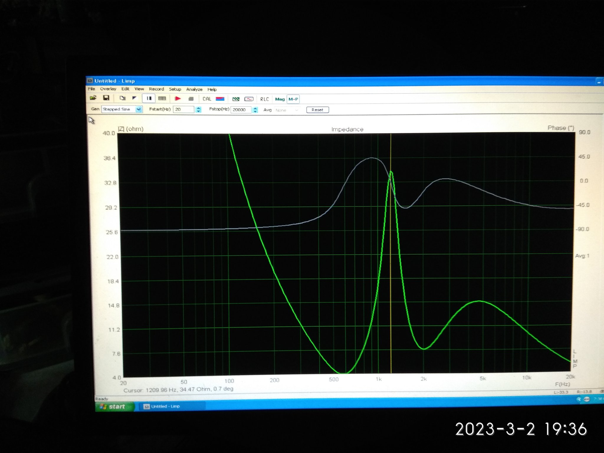

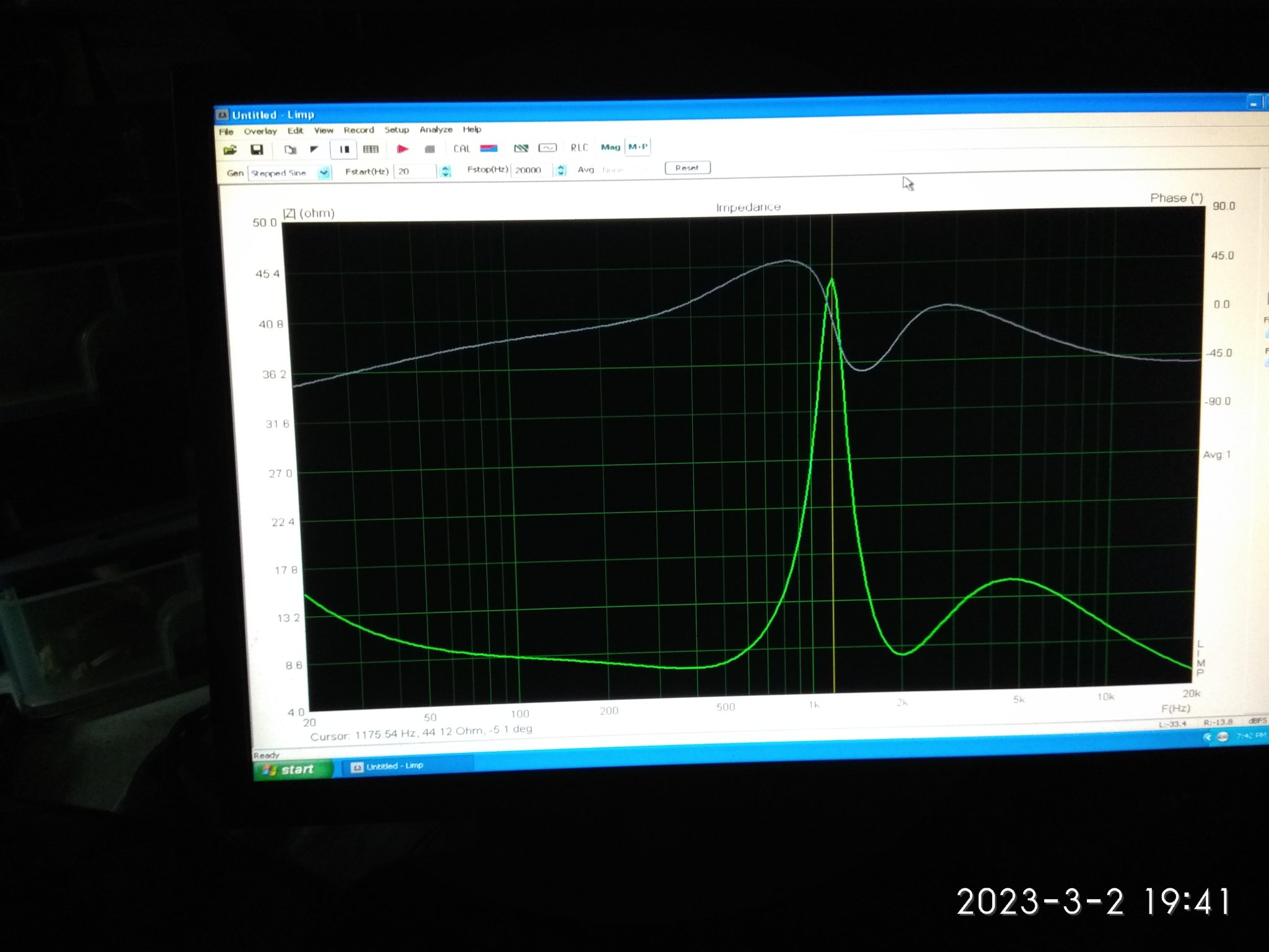

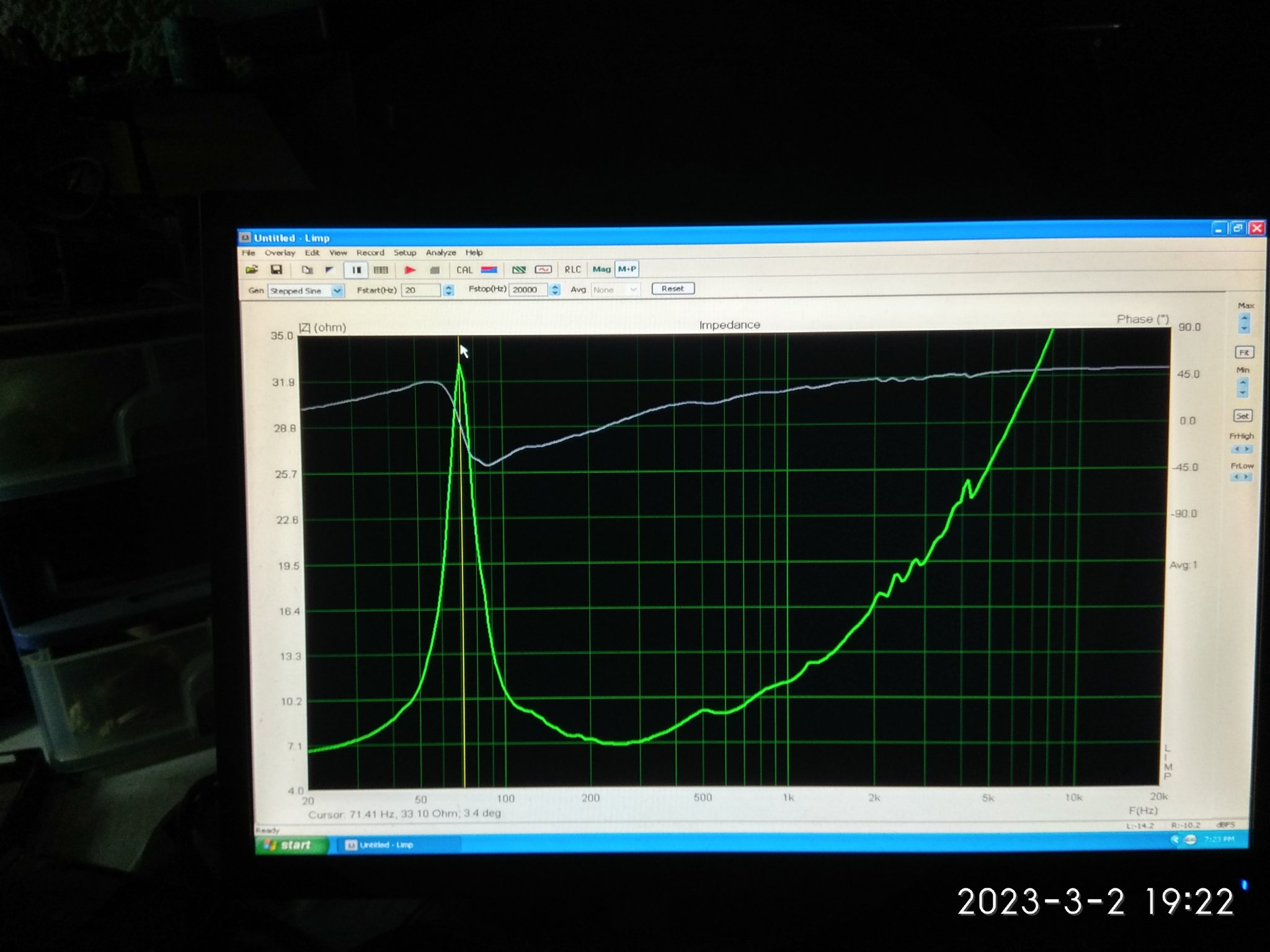

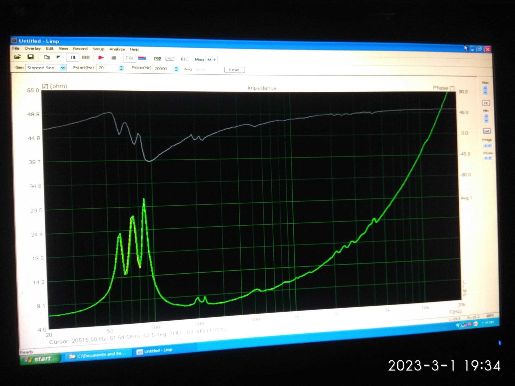

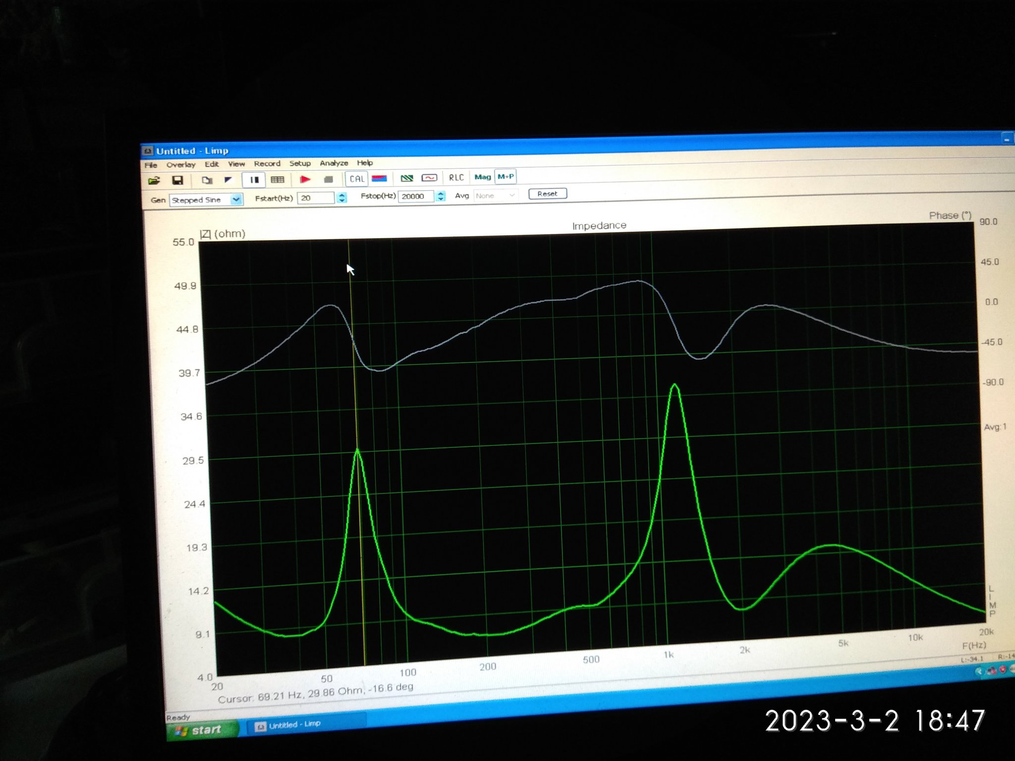

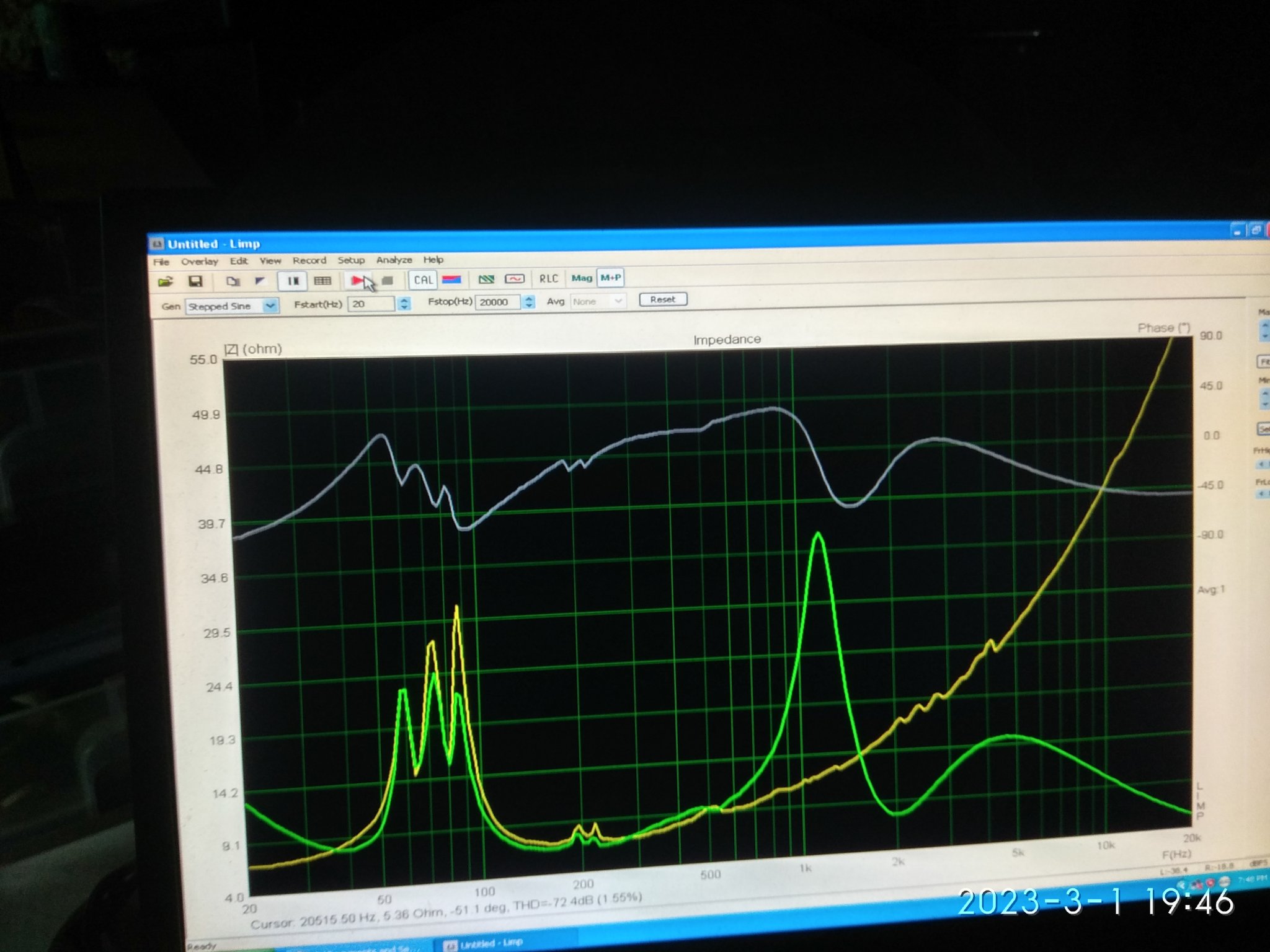

What is the right method measuring impedance when woofer mounted to the cabinet?
Do I need to measure with or without crossover connected?
It depends on what you want to measure.
You can measure both with and without X-Over. You won't know if everything is working properly until you measure the finished speaker with X-Over.
You only measured the woofer in the cabinet, right? That looks fine.
I did find a mistake with the crossover, though. You soldered the 560µF cap in the wrong place. It goes in between the first 2.2mH coil and the two 15µF caps. You have inserted it after the two 15µF caps.
