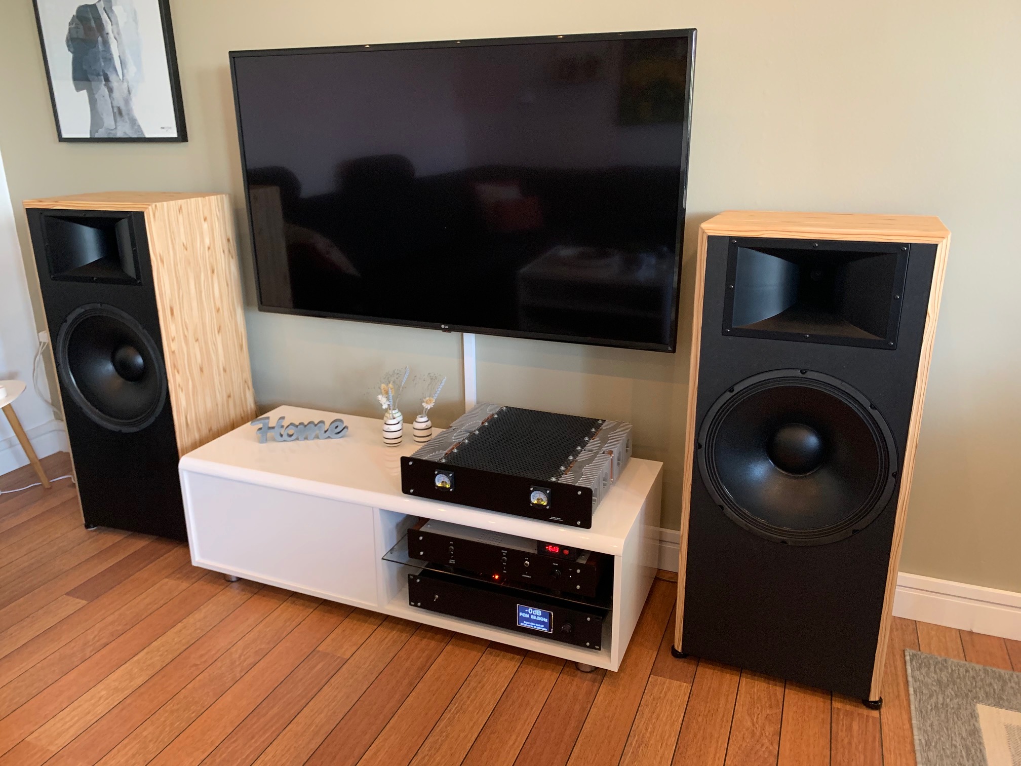

Hi...
More pic's... Sry... cannot resist 😛

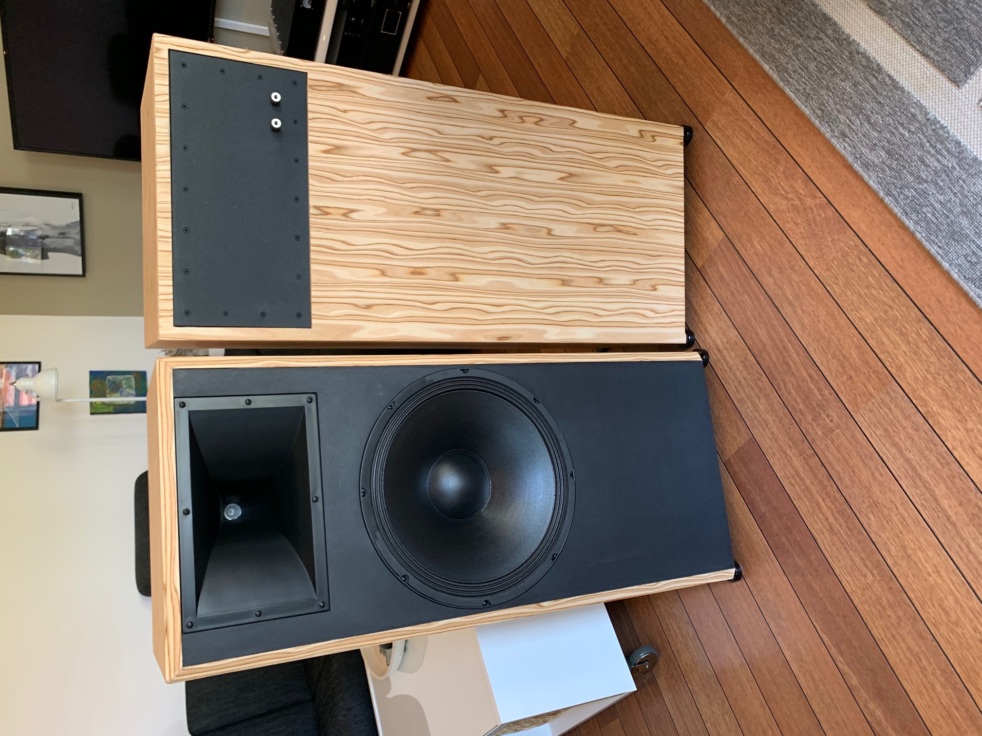

So i assembled all pieces today...
Just wanna share.
Jesper.

Nice work Jesper.
Well executed project Rese66.
What would be the minimum listening distance with these speakers?

Wow Jesper, they are beautiful.
I hope they can keep up with the great looks in terms of sound. 😱
@a3cervo:
Thank you. I would recommend a distance of at least 2.5 meters. It's about 3.5 meters in my room, which works very well.

I had a few hour's on them today, and i am still thrilled that i can "walk" away from them and still enjoy fullblown music. - Size does matter, as far as i know one need some volume and cone size to move the air, nomatter what! this i belive cannot be manipulated. Okay with EQ/DSP we can do a lot (i will try it out sometime), but still we cannot trick the fysical law's, can we?
- Most problematic thing here is that not much weissbier is being consumed here (by me) at Covid-19 Denmark present time 🙁

I am very pleased Jesper. I can definitely confirm your impression.
However, you can never use "too much" and "Weißbier" in one sentence.😱😀

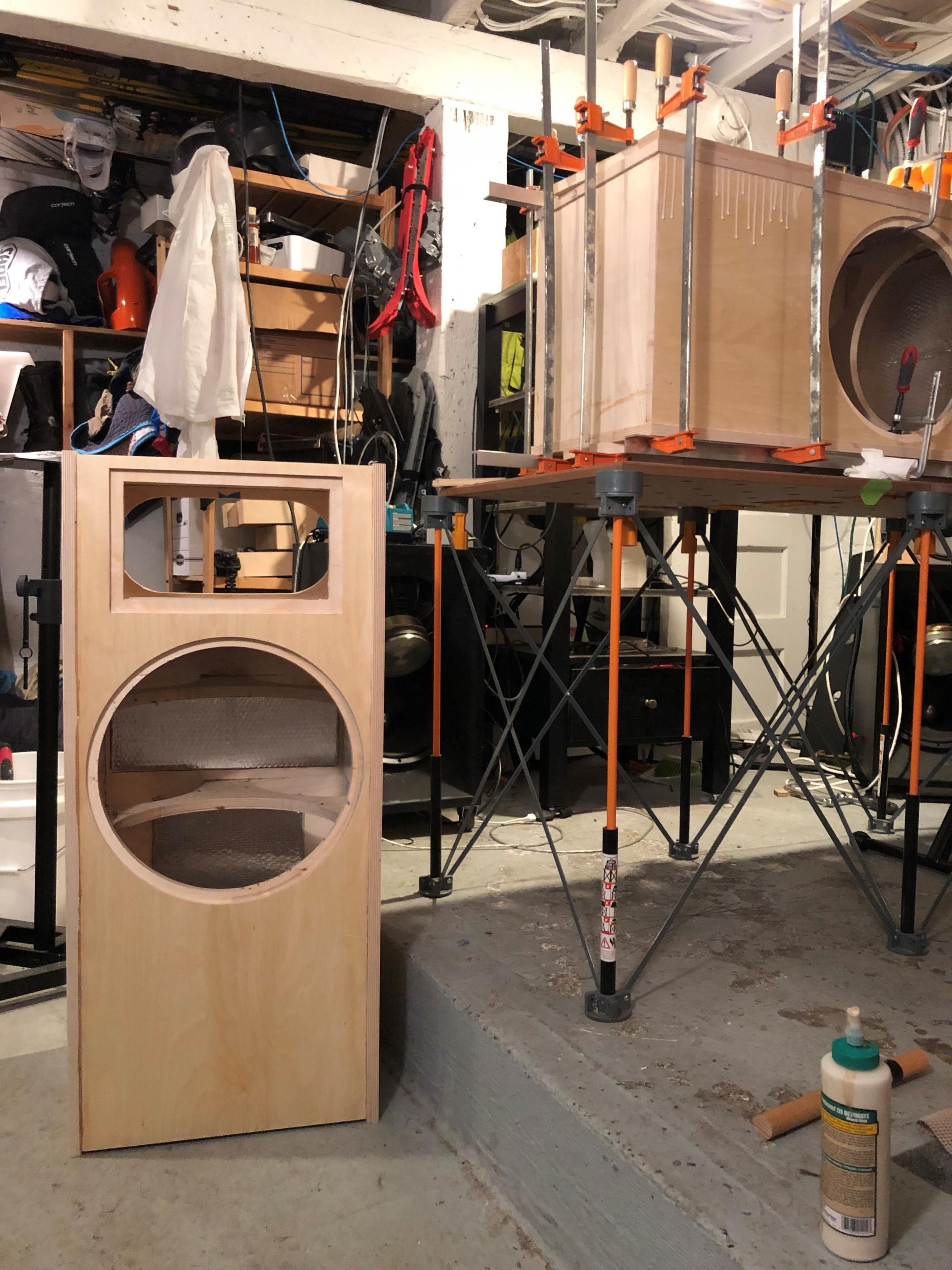

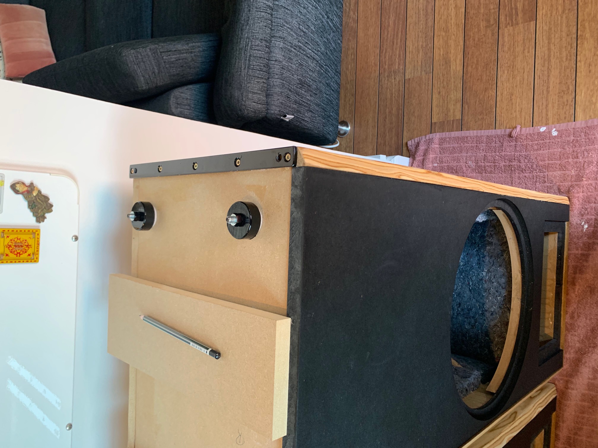

I'm applying damping pads at the moment. Mine are 2mm thick but I see others using 4mm. Should I double them up?
My baffle is 36mm of baltic birch. Should I add pads there as well?
Any point in placing them on the bottom of the cabinet?

Which dumping pads do you have exactly?
With the thick front you don't need anything extra, but it doesn't hurt either.

I'm using this.
Noico Black 80 mil (2 mm) 10 sqft (0.9 sqm) Sound deadening mat - Noico
I went ahead and doubled them up but only had enough for a single layer on the front baffle. About 4.5kg per cabinet. I glued the first layer using flooring adhesive and then 3M 77 spray adhesive to attach the second layer.
With sound deadening, each cabinet weighs about 30kg empty.

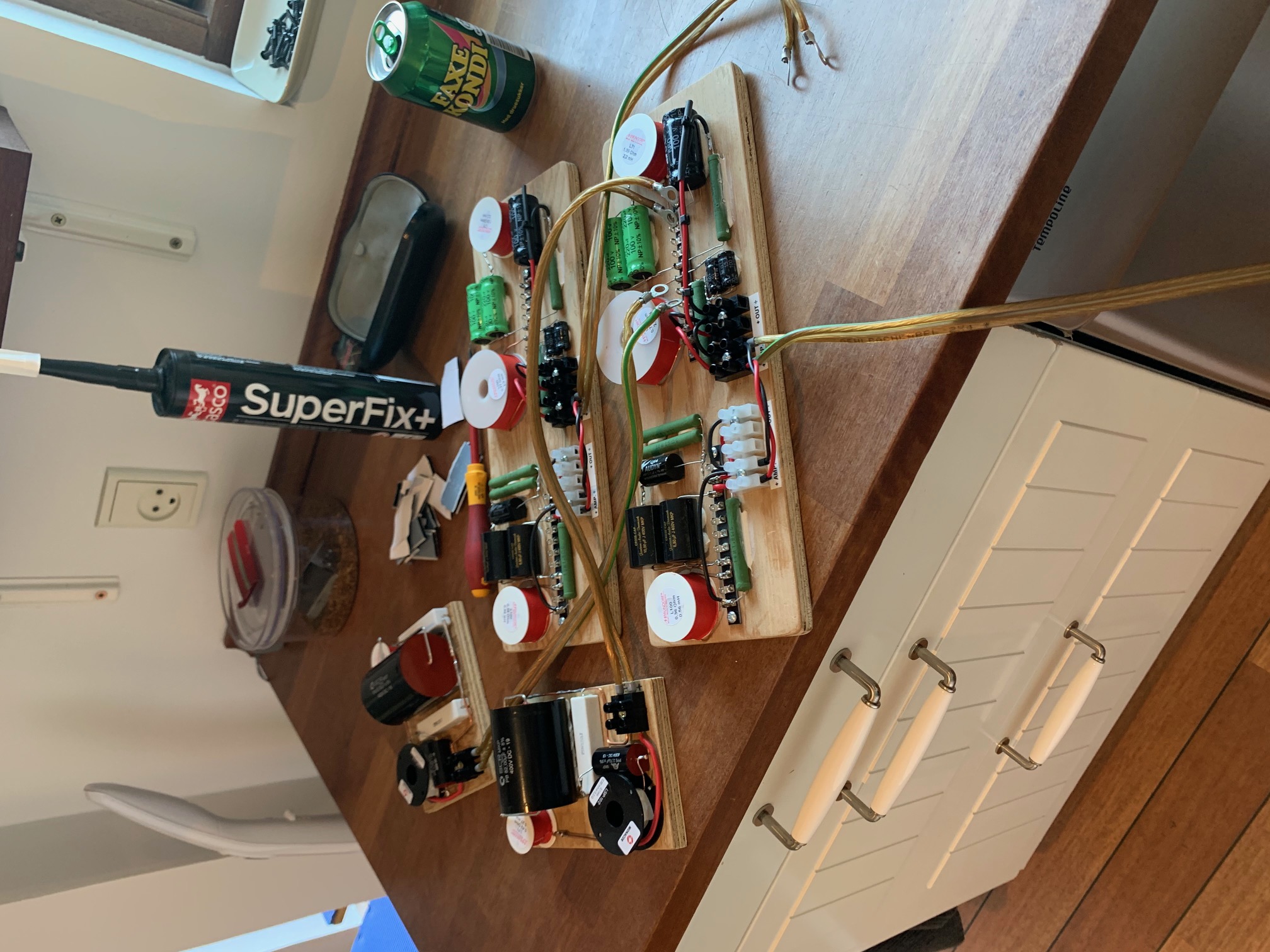

Both cabinets are now glued up. My remaining tasks:
- trim side panels flush
- sand/seal
- install denim insulation (after I learn how to effectively cut it. very difficult.)
- final crossover assembly
- install drivers
I need to figure out how I want to connect the woofer to the crossover board that I had planned to mount in the upper chamber.

Good job so far. I just drilled a hole in the wall, ran the cable through it and sealed everything with a large amount of hot glue.

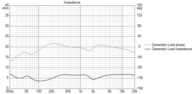

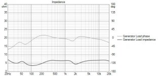

How would I know if I need the Zobel network (impedance linearization circuit)?
I am driving these AsaThors with a 45w KT88 amp.

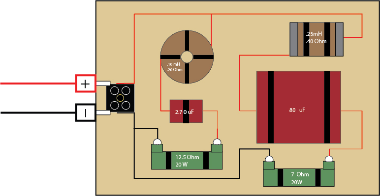

Just to be clear, can I build the zobel circuits and leave them external to the cabinets but connect them at the binding posts?

With tube amps, impedance correction should always be included. They can also be connected to the terminals from the outside.
@ joe
yes of course you can attach it externally. With PP loads it's more difficult to figure out if you absolutely need a correction circuit. It will likely be slightly advantageous. Build it, hook it up, ifyou like it move it into the horn cabinet with the rest of the crossover if not recycle it. The correction circuit is mainly for SET or amps that really prefer 8+ ohms, but it all depends how your amp handles 4 ohms. This is basically a 4 ohm speaker, check the first couple of posts to see the graphs, and goes down to 3.something. Do you have 4 and 8 ohm taps on the amp?

Yes, the amp has 8 and 4 ohm posts, but like you mentioned, the Asathor
dips to 3.6 or thereabout. So it cannot hurt.

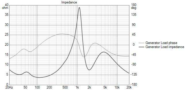

The impedance correction only works in the mid-range and above. Here the impedance fluctuates very strongly, which is not ideal with tubeamps.
With correction it looks like this:
