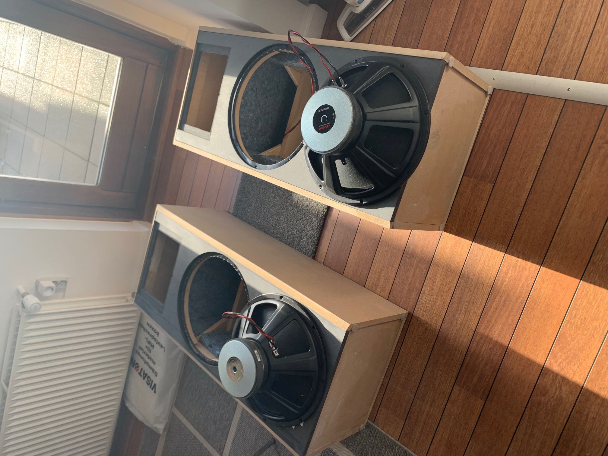

I should really be clearer regarding the use of the bitumen or in general. The way you lined the horn chamber is good. Bitumen doesn't damp, its highly reflective and gives additional weight that helps with vibrations, so good to prevent vibration from the woofer chamber entering the horn chamber, for others building this it is slightly more effective to line the top and front of the woofer chamber before gluing the felt and acustilux and also in the center of large unbraced surfaces, but this will also work.
When Rese and I spoke about damping the horn you want to glue the bitumen strips to the actual plastic horn to reduce the vibrations there and give it more weight and "stability". Its one of the cheap but very effective ways to iprove the sound of the horn. This video shows you how it's done How to Modify Klipsch speaker horns for better sound. - YouTube
The other place the bitumen can help is around the woofer basket. It prevents it from ringing, especially if the basket has a tendency to ring or is flimsy and also soundwaves reflects off ofbitumen. Test this as often its great, sometimes little happens and rarely it can be weird/nothing/slighly negative e.g. some Altecs . A bit of bitumen around the hole of the woofer also helps calm vibrations and reflects sound off the front baffle coming from inside wall reflections, if you have left over pieces. The most important thing will be using bitumen on the plastic horn though, followed by the woofer basket and then the front baffle around the woofer hole and any big open surfaces that could vibrate.
Another thing you can do is fixate the compression driver and hold it in place either attached from the ceiling or floor of the horn chamber. There was a picture of the mods used for horns in this thread if you want to check it out.

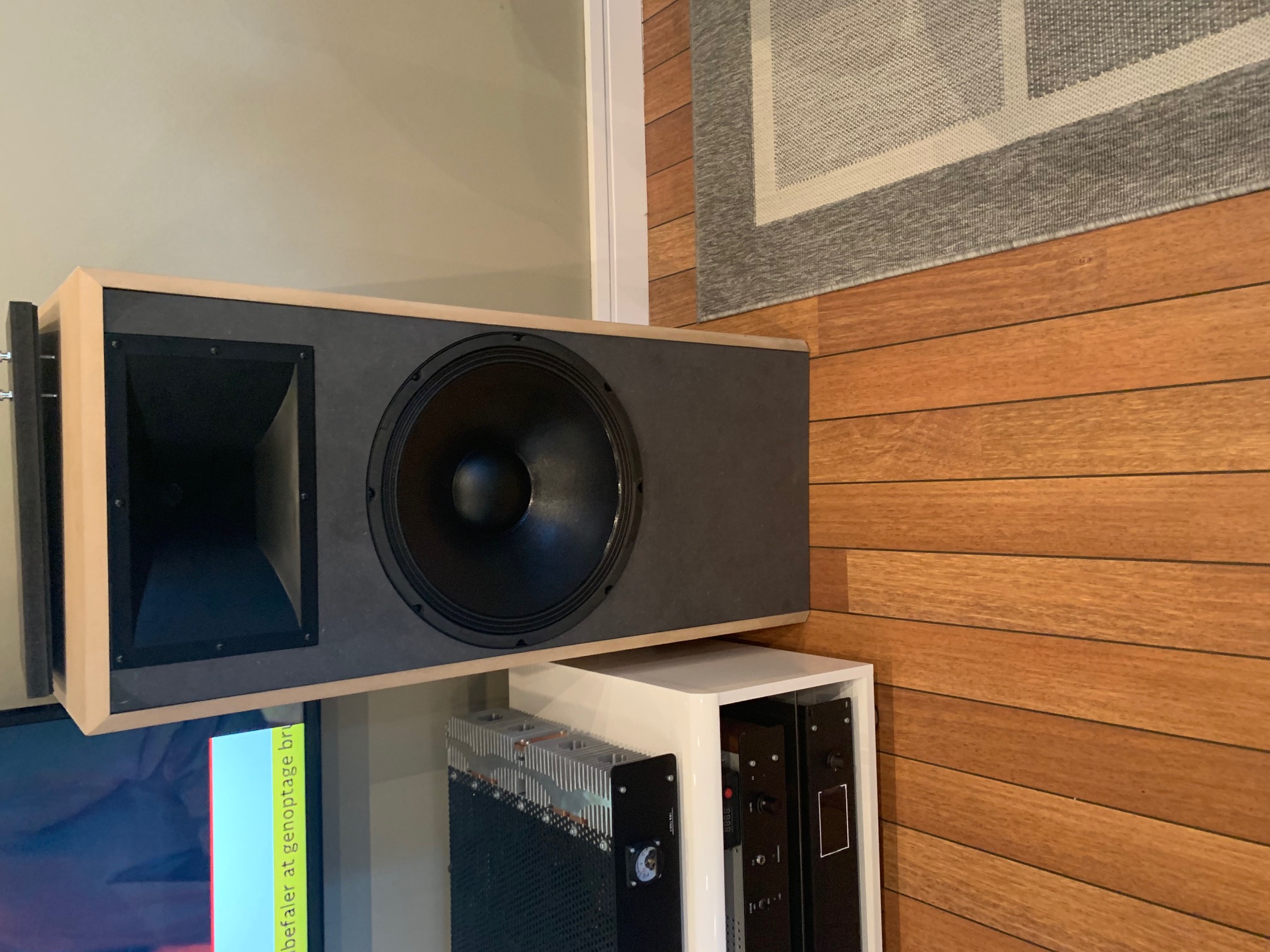

The Asathor was inaugurated with Bavarian Weissbier - it couldn't be better.
They already look great Jesper and I'm very happy that the first sound impression is also positive.
Bitumen on the plastic horn and the woofer basket is definitely recommended.

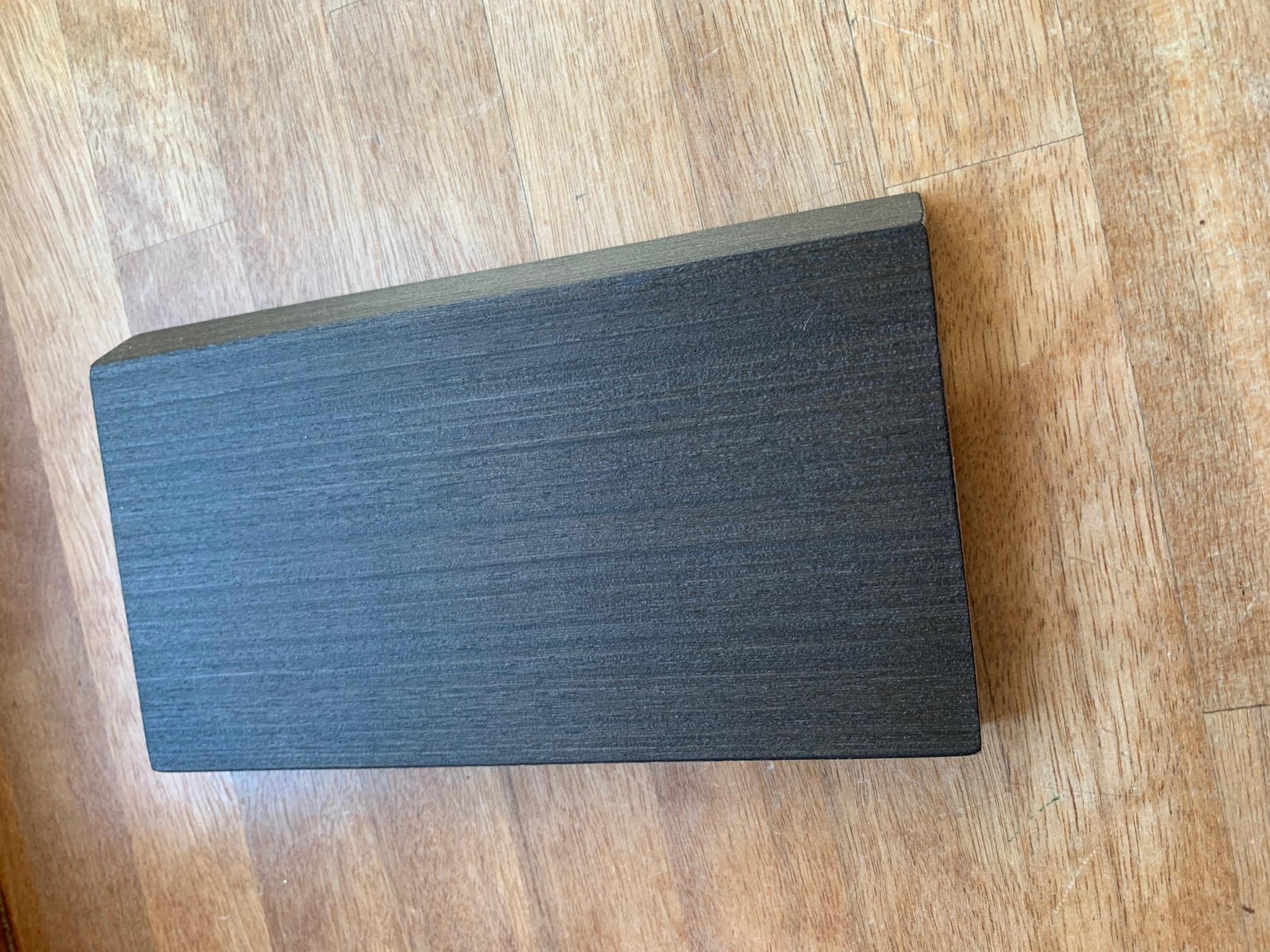

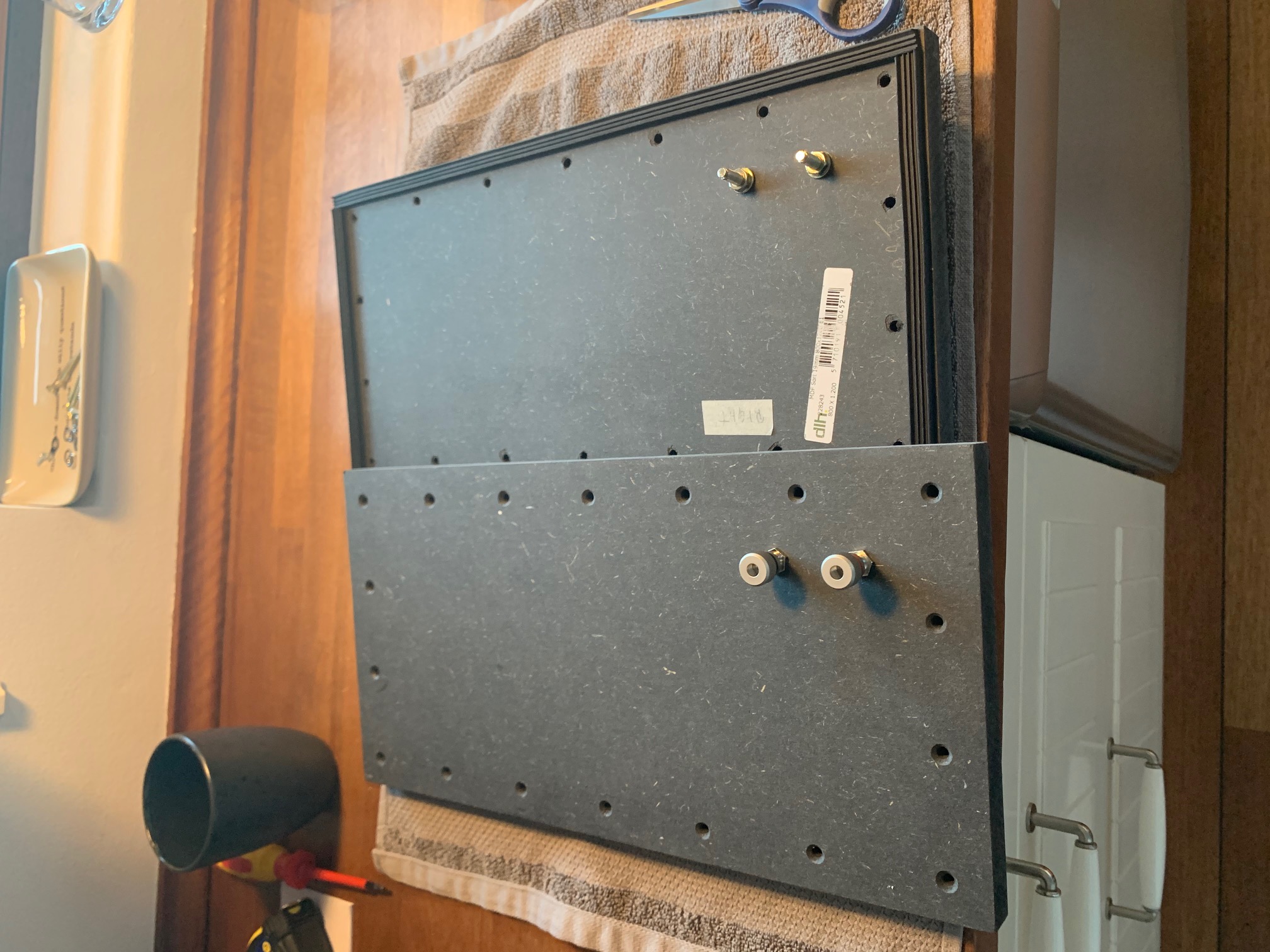

I sealed black MDF / HDF with Clou hard wax oil:
CLOU(R) – aus Liebe zum Holz. | Clou DIY | Produkte DIY
This makes the black a lot more intense and gives it a matte sheen. If you wipe the surface with a wet sponge or cloth, it will look very similar. You can test that.

Just to be sure, is it the black reinforcements that should be with bitumen on the woofer basket's? (I suppose so)

Exactly the black, relatively thin metal always resonates a little. It is better with a few strips of bitumen.
The hard wax oil is also available from other manufacturers. Osmo, for example.

Be carefulwith the oiling of the HDF and try to not get any oil on the MDF this can make the veneering more difficult/uneven. A bit of tape is helpful. I would veneer first and then apply the oil everywhere, not sure if you want that.
I have never done this with the baffles already glued on. Maybe Rese can give you some advice. Make sure to use good spatcheling copound. The ones for cars bodywork or similar. Search online to prep the MDF. Then still wait a few days, best a week or two for the mdf and glues to settle. (Keep speakers in a dry place. Sand again. The surface should be the same as for spraying paint. Really smooth that way you get veneer that will look great for a long time. Any shrinking or joints will be visible under the veneer. Those baffled edges are going to be a bit trickytoo if you want to continue the grain. Watch a lot of videos and read while you wait for everything to calm down in the speaker and that there is no more shrinkage/ change. Also make sure there is no more stink of glue inside and let it air out without woofers and drivers if there still is.
Great work for a first speaker build very impressive and especially lightning fast. Keep us posted

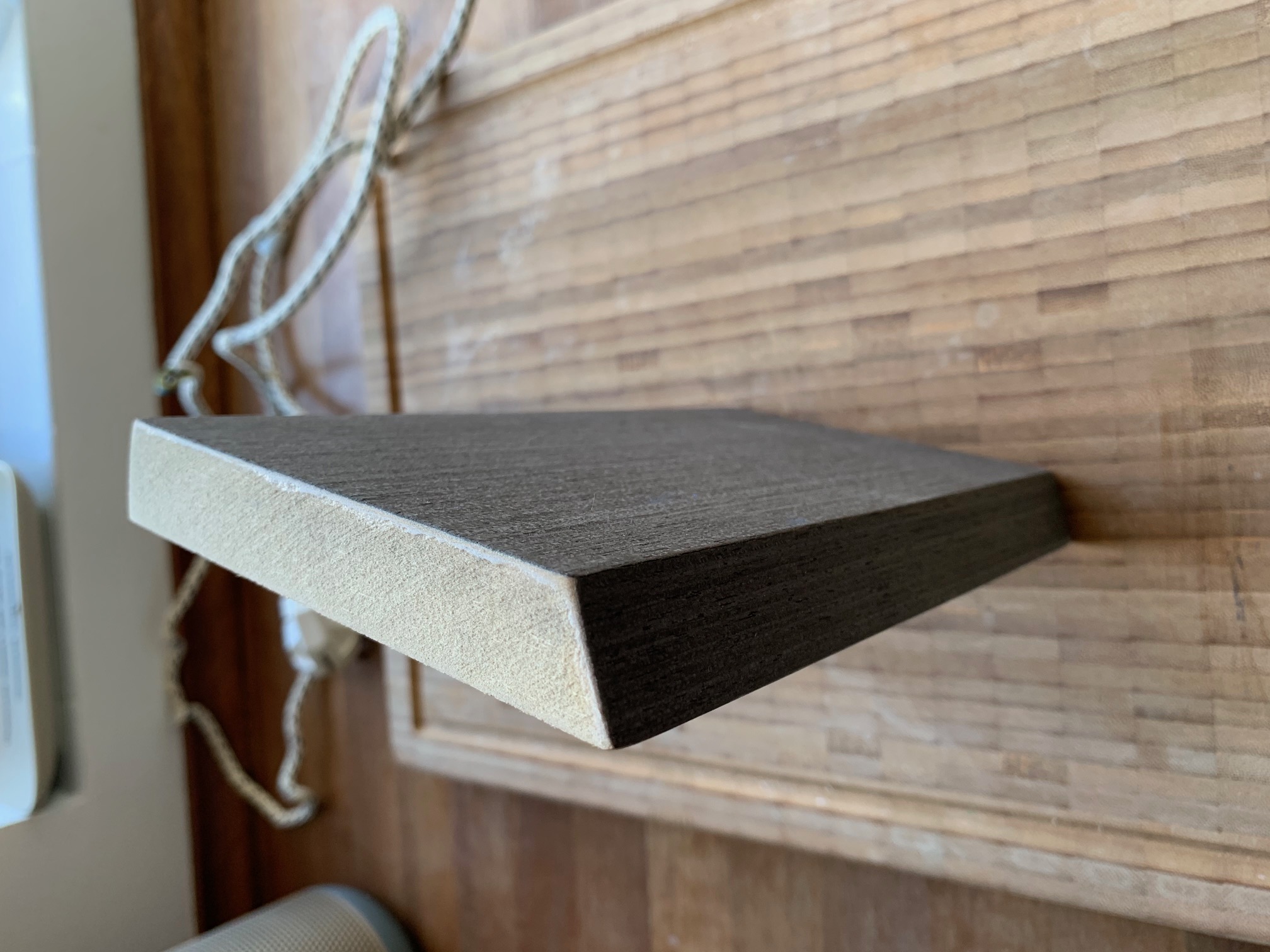

Regarding veneer. I wood go with something lighter than that black. The contrast between black hdf and light is what looks so good. The speaker looks good even with the exposed mdf because of the contrast. Black on Black will maybe ruin that IMO, its definitely nice enough for real veneer.

I'm all about tubeglow - black veneer wouldn't work so well here.
I'm a big fan of the SaRaiFo from designholz. It is significantly (!) Easier to work with than normal veneer and is available in large widths. I even think the price is cheap. And you protect nature.

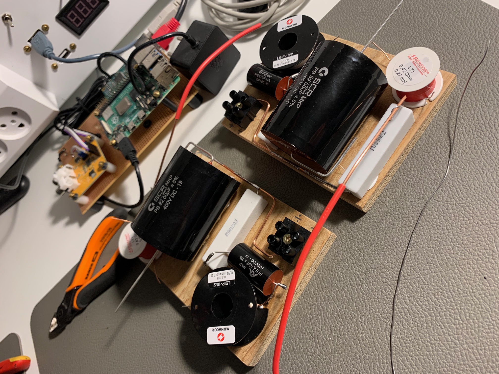

Do not use bipolar electrolytics in the crossover! Inexpensive polypropylenes are available. For all your hard work on the cabinet don’t skimp on the crossover. A film and foil polypropelene is recommended for the cap(s) in series with HF driver.

@ticknpop, Rese suggest only to use bipolar's on the woofer section. He suggest using filmcap's on tweeter section.

I'am doing my butique cap impedance "addon" 😉 today, also i'am done lining up my horn's (sure it was hard for the thumb's to press the bitumen into place on them)

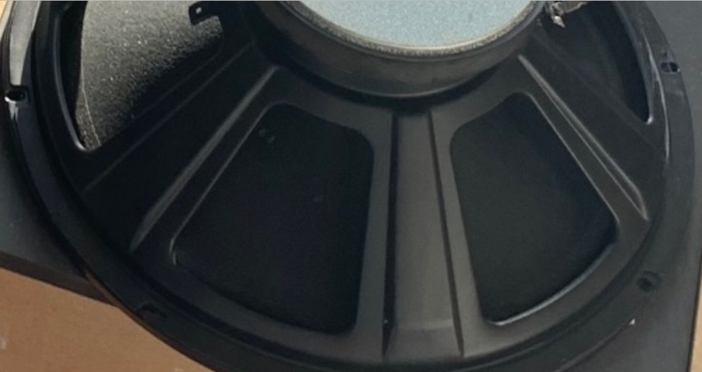

Woofer lining...
Btw. :: Could someone kind explain how they would line the woofer's basket with 4mm. bitumen pads? - I know Rese told me that i should lineup the small black reinforcements, but does it mean the hole widtht, or just the middle of them ???

I usually put felt on the inside of spokes if they are wide, it dampens also reflections, but never heard any improvements🙄
However, after mounting the driver on a baffle and tapping the basket without any treatment/damping, I stopped bothering about it. When driver is attached to baffle, any ringing is virtually gone. Easy to test, but it doesn't cure ones OCD😉
