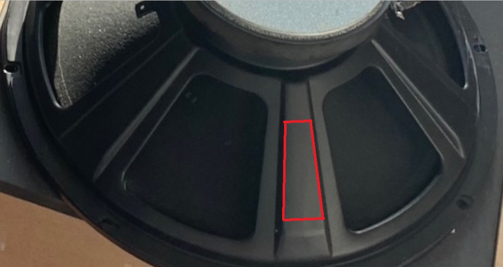

In the case of the woofer, the bitumen in the middle of the struts works best. I would simply stick on the area marked in the picture.

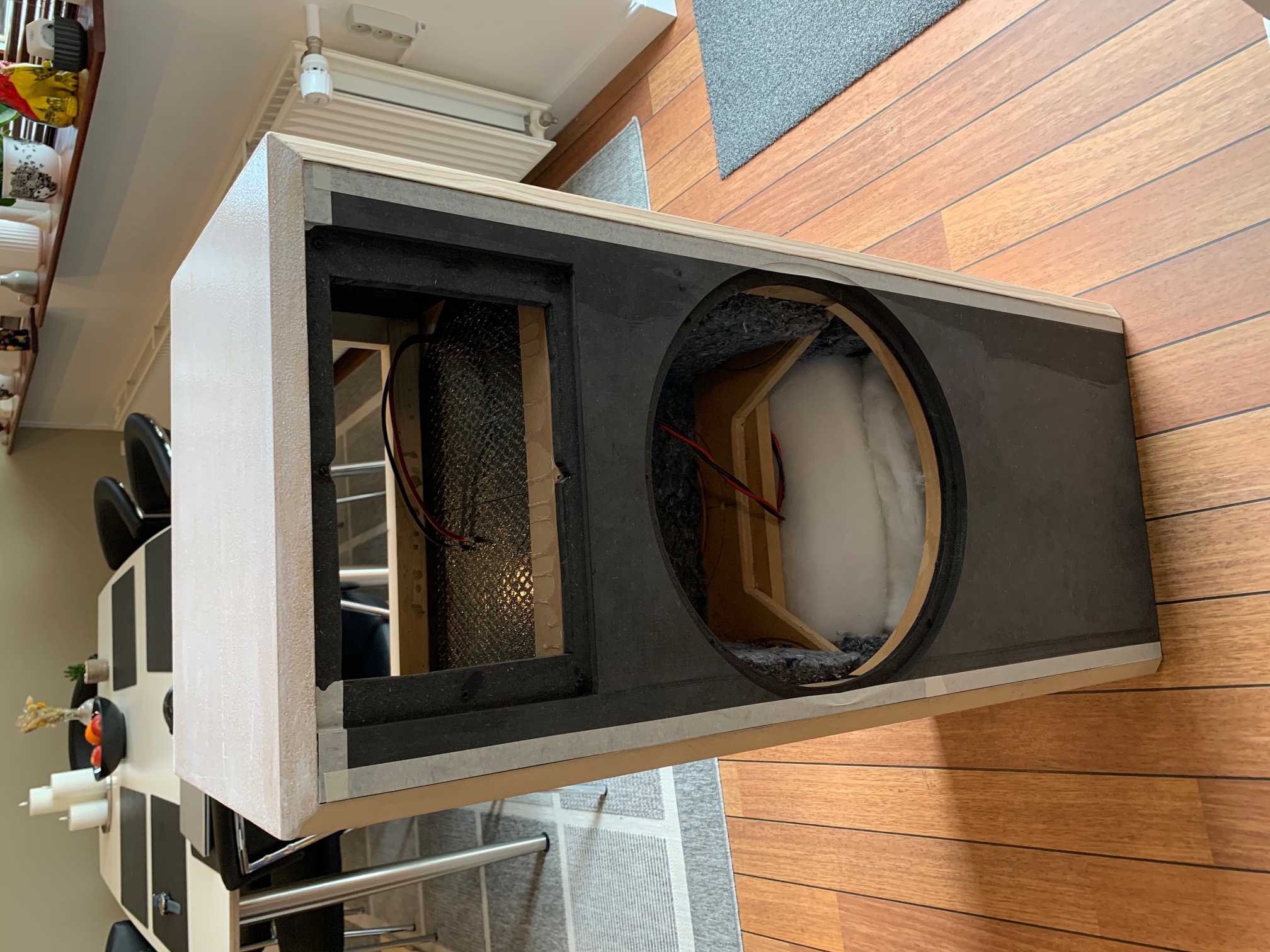

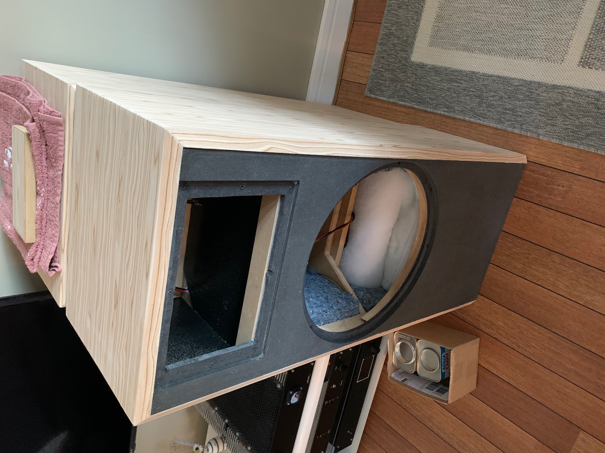

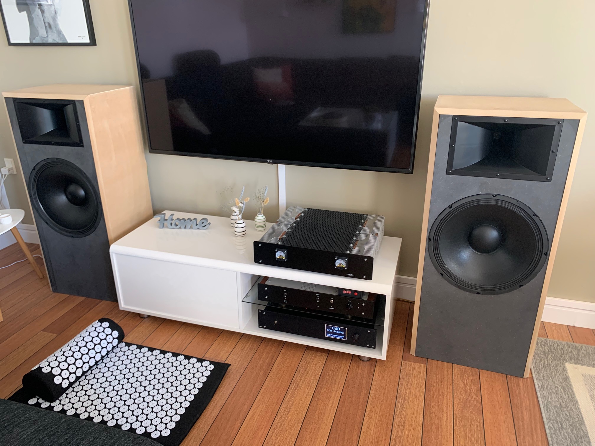

So finally i got it all set up...
Must say, that we bought a new couch recently, waiting for delivery late may, first june :)
So speaker's will have some more space then.
I tried moving them a bit around, they don't seem to be very sensitive to placement, stereo holographapy'nes :) is there, and they spread the music in room perfectly, excatly what i wanted.
We just did a 2 hour session with an old retro playlist we created with the grownup kid's some year's back :grouphug:... Speaker's don't have but a few hour's on them but they sound crispyclear and fullbody'ed so to say. With fullbody'ed i mean whatever volume level i choose, the music is "warm" and present.
Didn't tryout my 300B SE yet (I have installed the impedance filter btw.), i donno how she would sound, problem here is that my AlephJ Mimi is so good to my ears, 300B sound different on my other speaker's... but honestly not better, let's see how them tubes behave on thoose speakers ;)
Jesper
Nice to hear that you like the sound. :happy2:
It's always a little exciting when other people rebuild your project.
That's right, the loudspeakers are not that critical in terms of placement. But I have angled them a little towards the listening position. You can test for yourself what you like best.
The Aleph J is a good amplifier - even if it is not very powerful, that should be enough for high levels. I have a Marantz PM66 SE with only 2x50 watts. You don't need more in living rooms.
In any case, I wish you a lot of fun with your great speakers.:cheers:

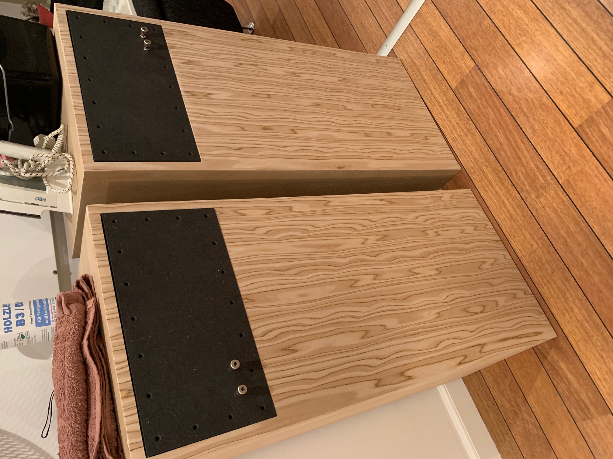

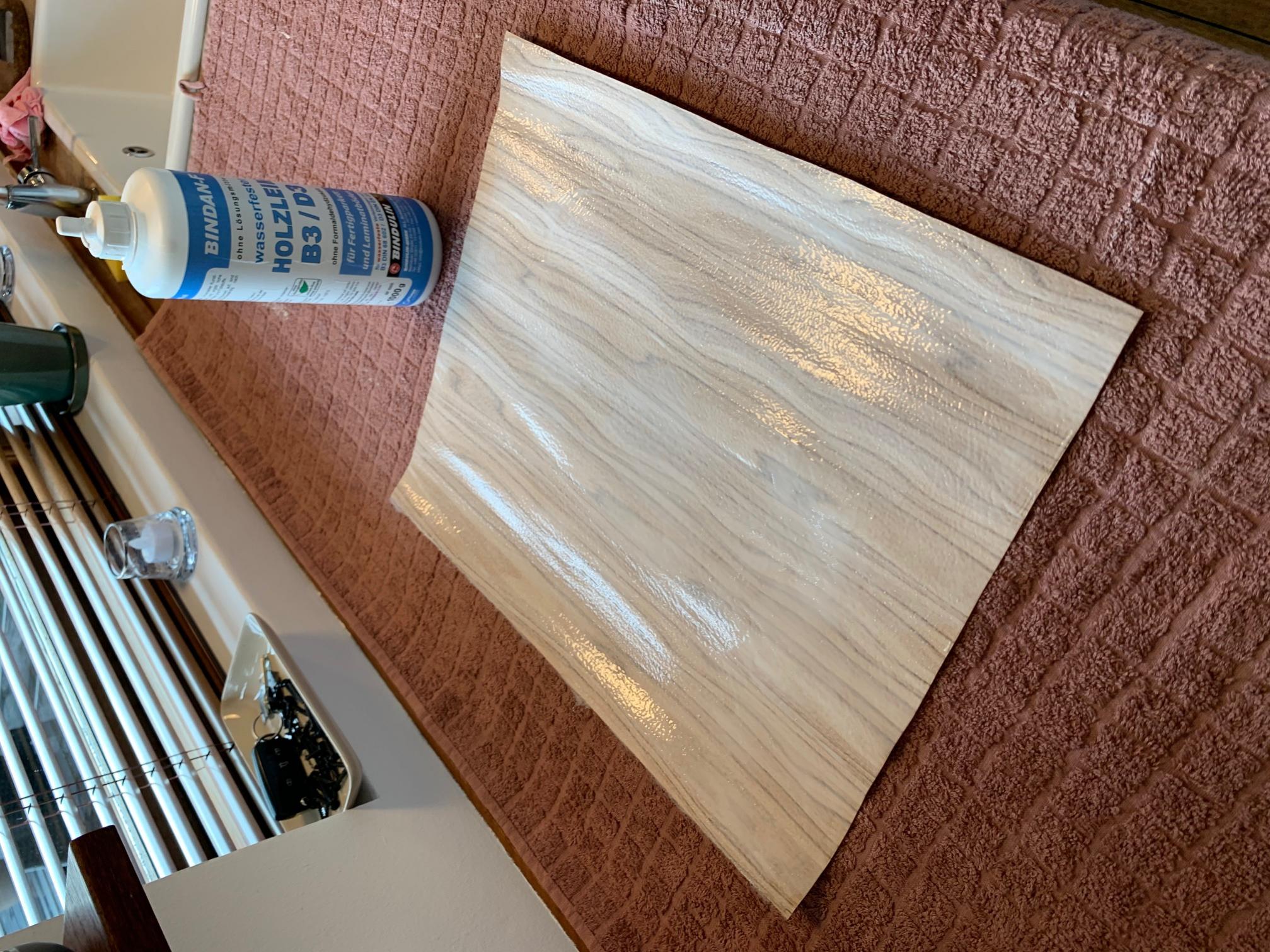

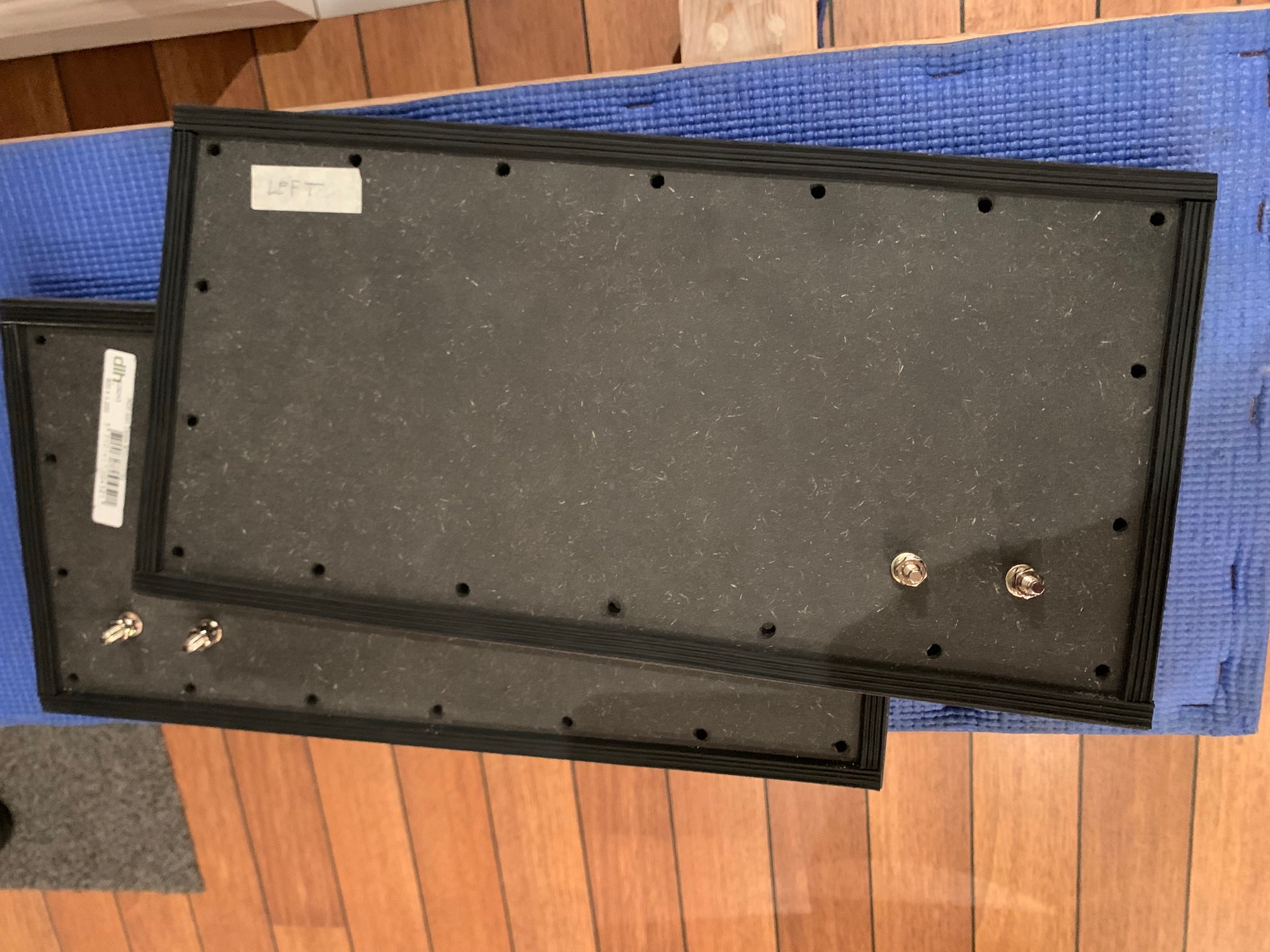

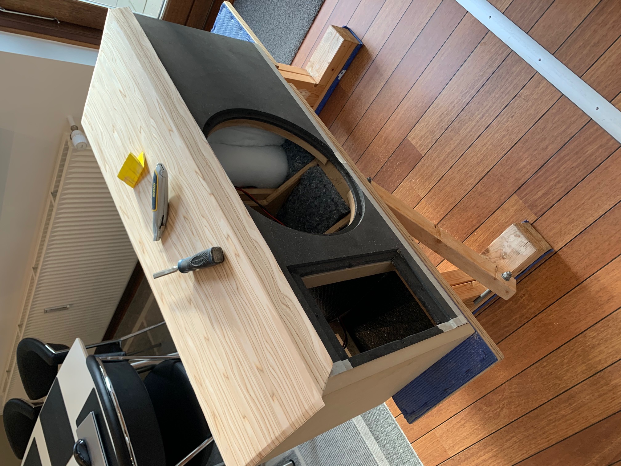

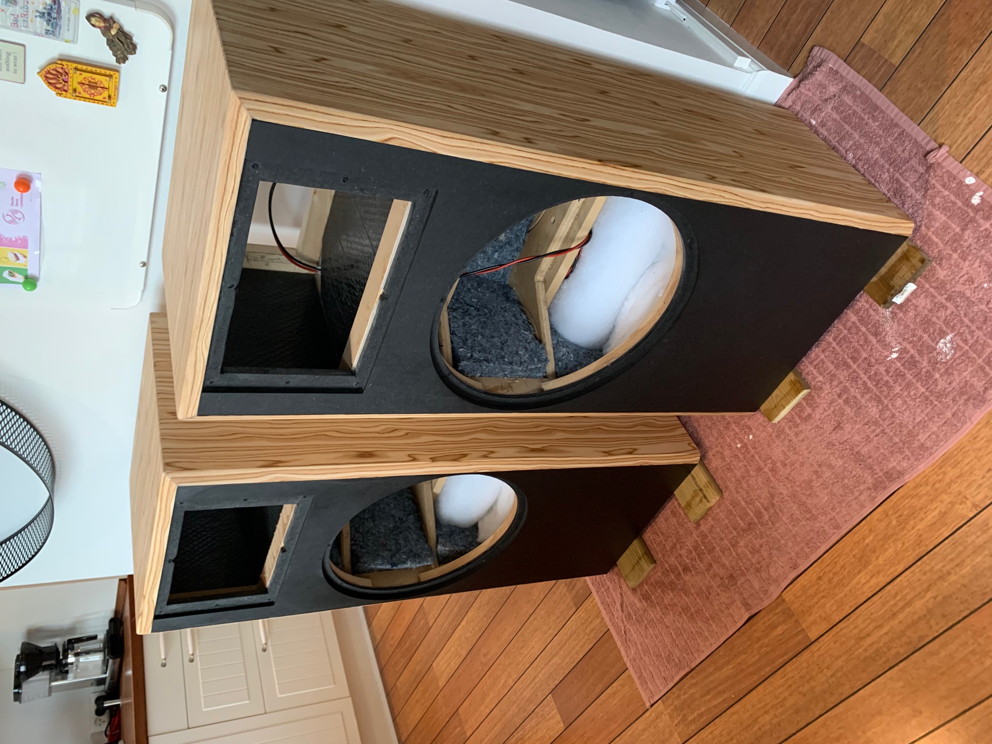

Hi...
So i spent ~10h. with my veneer, glue, iron and some other stuff.
I followed the guide excatly, only thing i did besides that, was to give the veneer a bit of water with a spronge on top side.
Professionelles Finish mit SaRaiFo-Furnier - Bugelmethode - gazza-diy-audio.de
Everything went fine, and i'am really happy with the result.
I now have to try out different finish on a testpiece of wood. It proberly be hardwax on the black baffle, and lacquer on the olive-veneer :) (Yes i miss Greece!)....
Jesper.

Thank's all!
Those look killer... I like the veneer... Is it that SaRaiFo stuff? Veneer work scares me, but seeing results like yours make it awfully tempting.

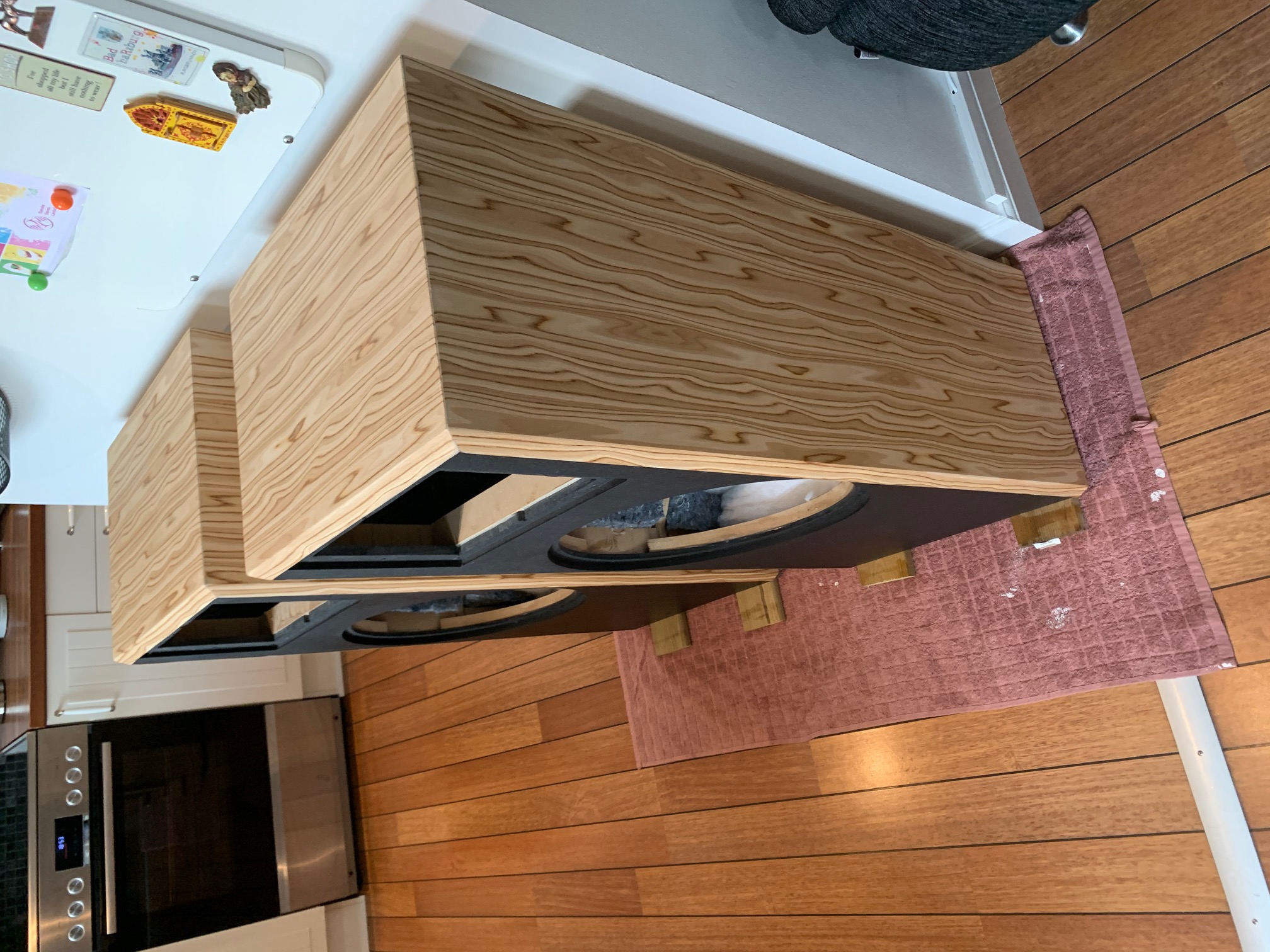

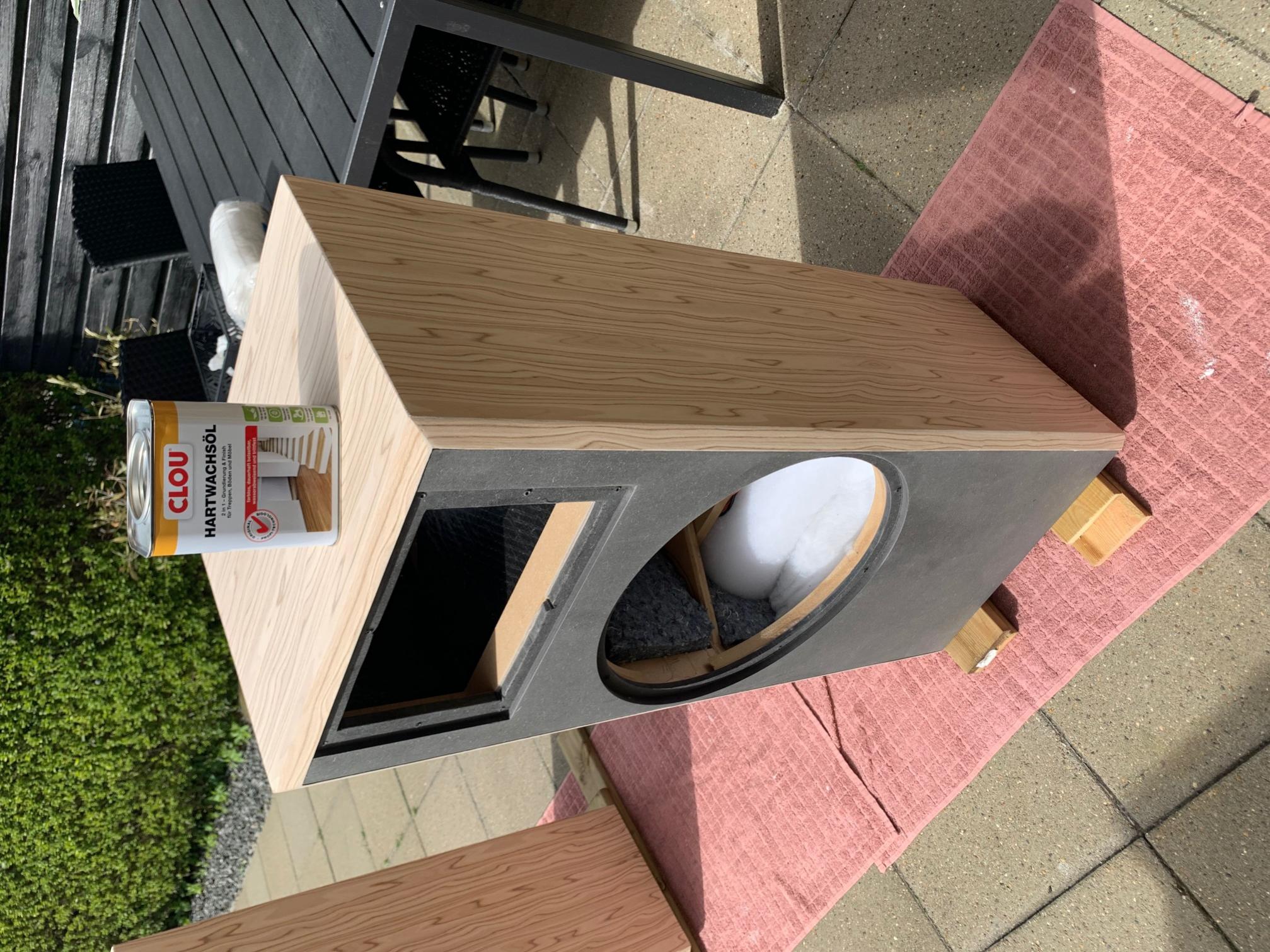

Yes it's the SaRaiFo, with fleece on backside. -I had problems finding glue which was not fast setting glue, so i ordered it in Germany (out neighbours) -While i was at it i ordered the wax-oil and lacquer there also...
I tried as i wrote before on a piece of scrap wood, both lacquer and hard-wax-oil.
The lacquer. Same test on a piece of black mdf(hdf).
The lacquer was not the best on the black piece, and on the veneer it did not add much glow to the three... I normally like the highglossy look of the lacquer, but wax-oil is better on the build i do here :) --- Soo i gave them 2 layer.
The end result is really satisfying for me, at least i am satisfiyed :D
Jesper.
