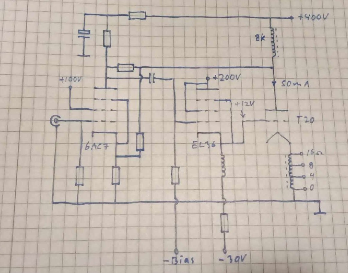

Choosing the Taylor T20 as output tube in a hifi amp is probably a good example of such insanity: As far as I know they were made by one company some 80-85 years ago and has no real equivalents, it consumes 7,5V 1,75A of very clean DC only to heat the filaments and it requires both grid current and a decent amount of negative feedback to produce anything useful. To be perfectly frank, the driver tube could produce the same output power even when wired as a triode, and that without pushing the ratings too much.
Still, when I became aware of the T20/TZ20 tubes less than a year ago I knew I had to get some and build something with them, no matter how impractical they were for the job. It took three power transformers and six chokes to produce the necessary DC rails (and it still hums, though very little...) and three local feedback loops to make these darn things behave as something resembling "normal" triodes. Did I do it because I needed the function of another single-digit power tube amp? No way, I have plenty already. I did it because I saw a picture of a T20 somewhere online and decided that I needed to own it and tame it. Probably a mindset that has caused a lot of grief in the world...
Anyways, the efforts paid off quite well this time, resulting in a nice and quite "neutral" sounding amp. Similar objective results could have been achieved using more traditional tubes (or a couple of LM1875, for that matter) but overcoming a few adversaries always adds some flavour to the dish.
I promised earlier to share some details aboit it, here is a conceptual schematic:
(A technical note: The -30V rail isn't strictly necessary, I had a couple of extra 12V windings on the mains transformers and decided to use them to keep the output tubes biased completely into cutoff until everything has warmed up, since the HV rail uses solid state rectifiers.)
If you want to make it a bit safer you can use E235L instead of EL36 for the cathode follower. same tube but no top-cap

Funny anecdote: I bought a pair of E130L to use as drivers in this amp, not the cheapest tubes around but their high gm should make them excellent cathode followers. Unfortunately I had missed the simple fact that they are much larger than EL36 and won't fit...
I bet these will put up a lightshow when the filaments are lit:
The driver stage is interesting, Dynamic Coupling but with some local feedback from connecting the driver anode to a tap on the OPT rather than to B+.
The prototyping was done with an Edcor transformer that only had a 40% tap which didn't provide very much feedback. Connecting the driver anode directly to the output anode increased the amount of feedback but also decreased max output power by 20% or so. The James OPTs I'm using now has taps at 85% (2.5/3.5k prim Z) that should be just about perfect: a decent amount of local NFB while there is a bit more voltage left across the driver tube when the output anode swings fully negative.

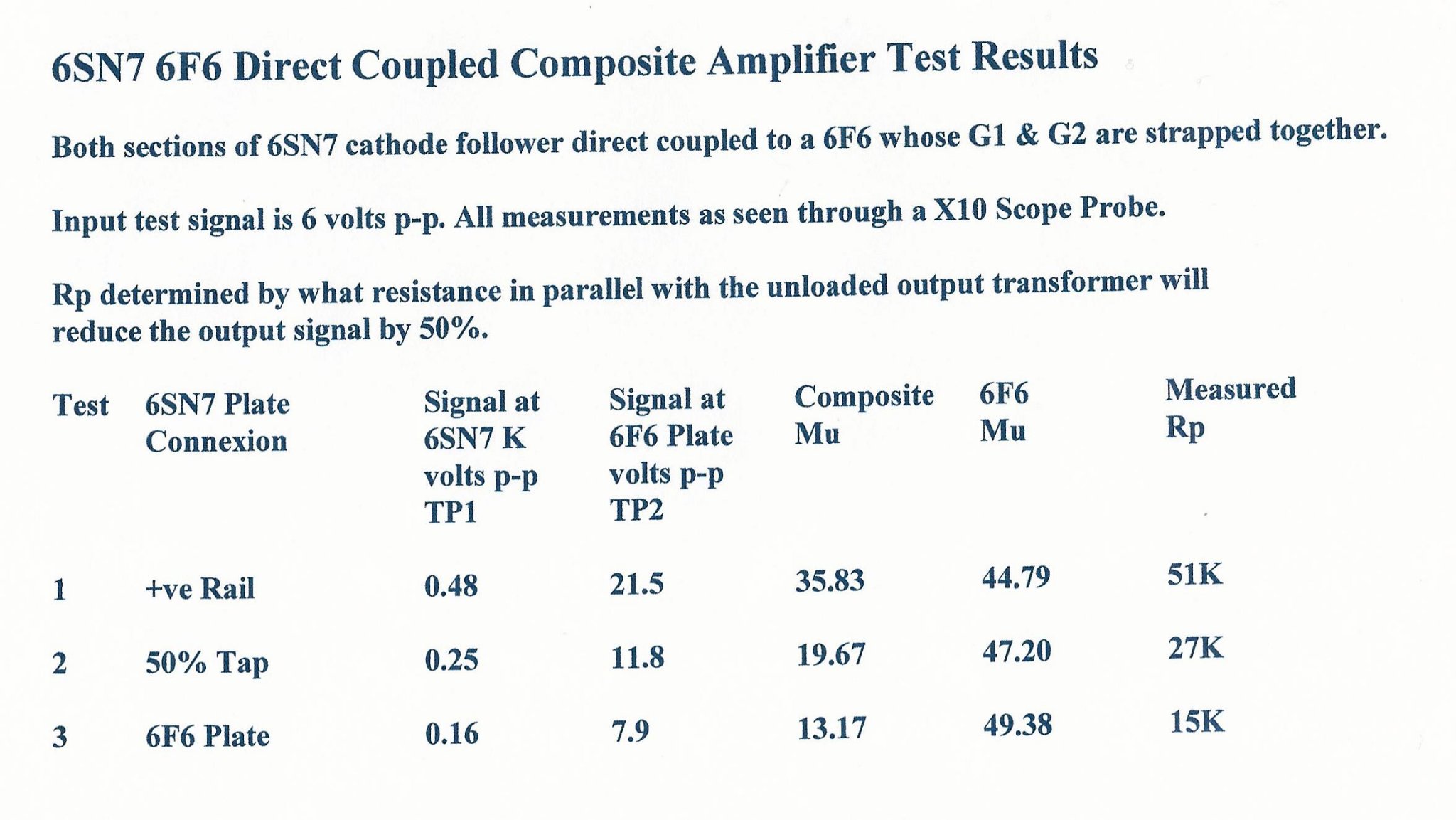

The all triode distributed load (UL) circuit is something I looked at about 15 years ago. I had seen in the old tube manuals back more than 60 years ago some rather odd power tubes. These would include the 6AC5 & 25AC5, a pair of very high mu power triodes. Others are 6B5, 6N6G & 25B5, 25N6G.
All are now quite expensive, I guess the collectors need them to keep the old stuff running. I wondered about simulating them with easy to get tubes. If one thinks of it, most power pentodes when run as triodes with G1 & G2 strapped together have quite a high mu. I checked some 6F6s in that mode & found mu to be about 50, so OK for some kind of trial. If we check the old tube manuals we find that the recommended driver for the 6AC5 was the 76, a medium mu triode. The 76 is the same as the 6P5G but on the older base.
The trial circuit is quite simple, a 6F6 DC driven by the cathodes of parallel sections of a 6SN7GT. The anodes of the 6SN7GT could be alternatively connected to the B+ supply, the OPT CT or the plate connexion of the 6F6. That varies the amount of NFB applied to the anodes of the 6SN7GT. The resulting reach thru to the 6SN7GT cathode is (1/mu). I’ve put the test circuits & results into attachments.
I never did build the complete PP UL circuit. I realized that the driver plate(s) direct to B+ version was used commercially in some radios in the 30s. If you look at the base connexions on the octal 6N6G & 25N6G they are identical to many common power tubes such as the 6F6GT, 6K6GT, 6V6GT & so on. In the circuit they are self biasing, no cathode resistor required. But they did not catch on. Probably more expensive to build these tubes than the corresponding pentodes with there two cathodes, etc. An interesting exercise.

jhstewart9: Yes, your experiments with 6F6 and 6SN7 has been a useful source of inspiration for this project!
I've done similar tests myself using pentode drivers with only the screen grids connected to the output transformers, it worked pretty well but it was difficult to find suitable tubes that could handle large voltage swings on the screens.

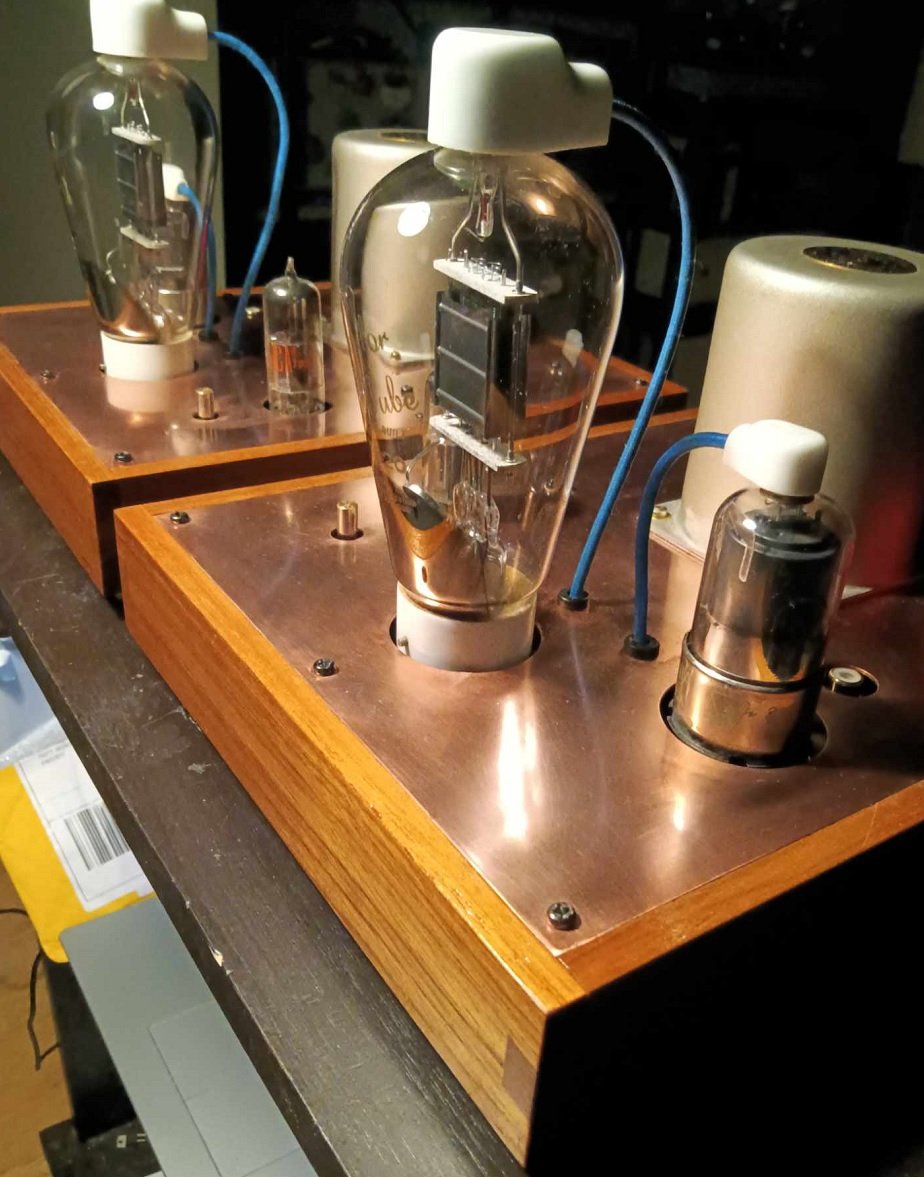

Where did you get those cases?
I assume you bolted everything onto a sub plate under the top cover? I need something like that for my current project.
I made them myself from teak planks and 1mm copper sheets. A bit labour intensive but I work night shifts at a mechanical workshop... 😎
Just as you guessed there are sub chassis below the top plates, made of 2mm alu sheets. Not easy to make everything align but it's nice to get all those screw heads out of sight.

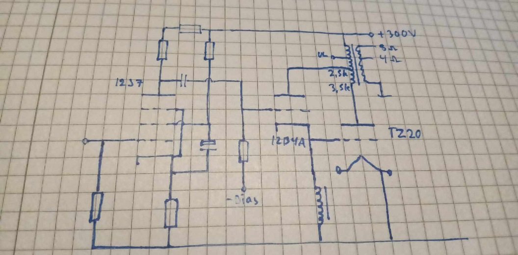

The schematic on p71, is that the final circuit?
On a separate web site I found what looks like the tube mu is 20.

I didn't use a distortion paralyzer to measure any of the information on that 6SN7/6F6 experiment.
The TE was SG, DVM & Scope. The objective was to find a way to create a pentode out of two triodes.
That worked very well.

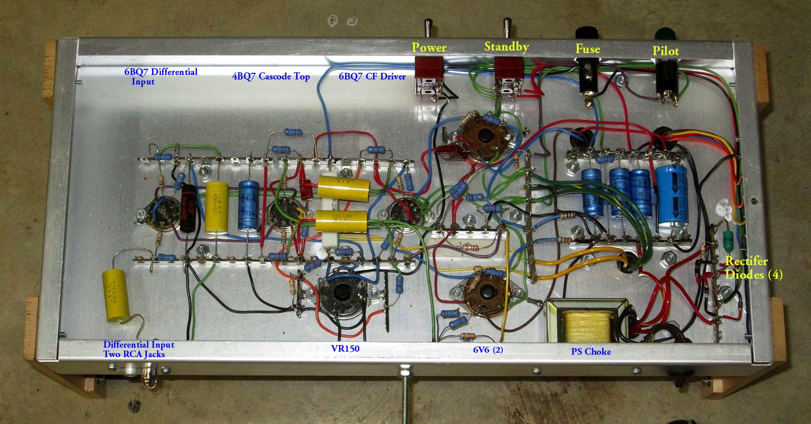

I don't build amps to look at. Or listen to. But I do know how to do a clean build free of problems.👍
If you are refering to post 71 in this thread, it is the conceptual schematic of my T20 amp. A completely different story with three separate feedback loops but none that has anything to do with the Triadyne topology.
That project is finished (except for some hum hunting...), the Triadyne discussion refers to the amp(s) in post 84.

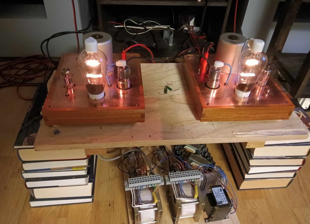

They just got fired up for the first time:

On p84, what is the resistance of the choke in the cathode of the 12B4A?
The Q point of the T220 will depend on that. When the plate of the 12B4A is on the B+ rail, the T220
acts as a Pentode. But when the 12B4A is moved to the plate of the T220, the composite tube acts as a triode.
I see many thick books under your amp. Technical or otherwise?🙂
The chokes are Hammond 156C, Rdc ~3700 ohms plus another 470R resistor in series, not shown in the schematic. The TZ20 grid sits at +28V or so at idle so there are 6-7mA flowing through the choke and another 7-8mA into the grid. The choke allows the driver to pull the grid below 0V for max output power. A resistor or a CCS connected to a negative rail would probably do the job just as well but I have a certain fondness for iron and copper. Nostalgia for a times long before I was born, I guess.
By the way, the bias is set by a negative voltage on the 12B4A grid. It would probably be possible to find a combination of tubes and voltages that would bias up correctly with the driver grid at ground level but an adjustable bias voltage made things a lot easier.
Mostly fiction I'm afraid, Stephen King and whatnot.
Right now I'm trying to figure out how to make the PSU a bit more presentable. I could either pay good money for some better looking iron and build another teak/copper chassis or I could just shove the existing surplus transformers into some kind of anonymous box and be done with it.

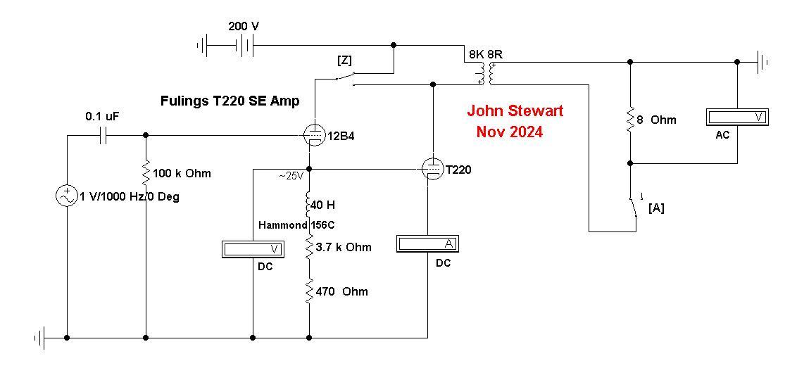

First Pass trying to analyze Fuling's T220 SE amp. Got a nice preliminary schematic. B+ needs correcting, might be others.
I had forgot the Electronic Workbench (EWB) simulator does not allow positive biasing of tubes.
But there is another way. I'll run that in a day or two.🙂

Thanks for your efforts, John!
B+ landed around 290V, a bit lower than I hoped for but I had to add mosfet cap multipliers to get rid of some hum. Also, the OPT is 3.5K:8R with a 2.5k tap that I use for the local feedback.
