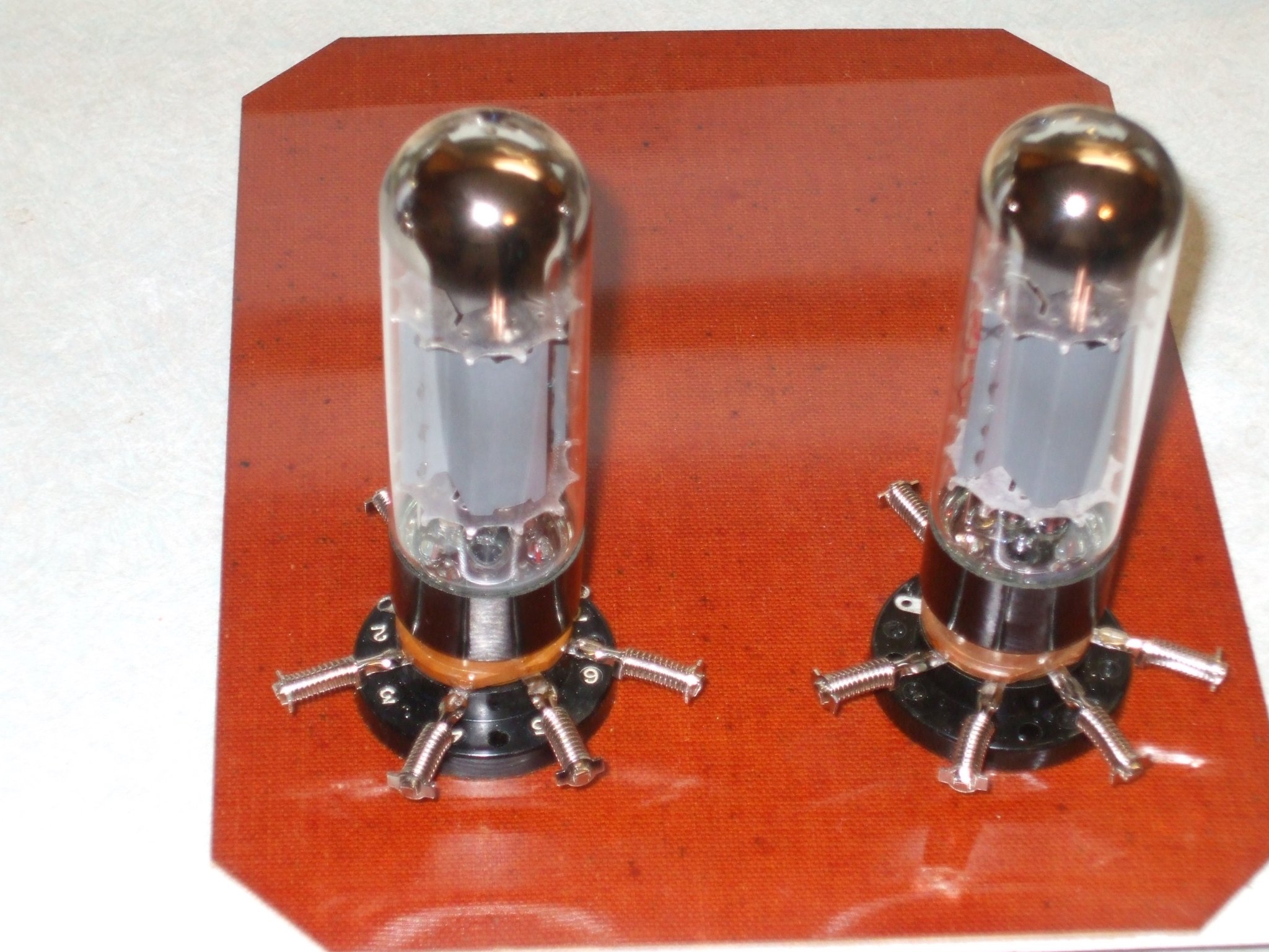

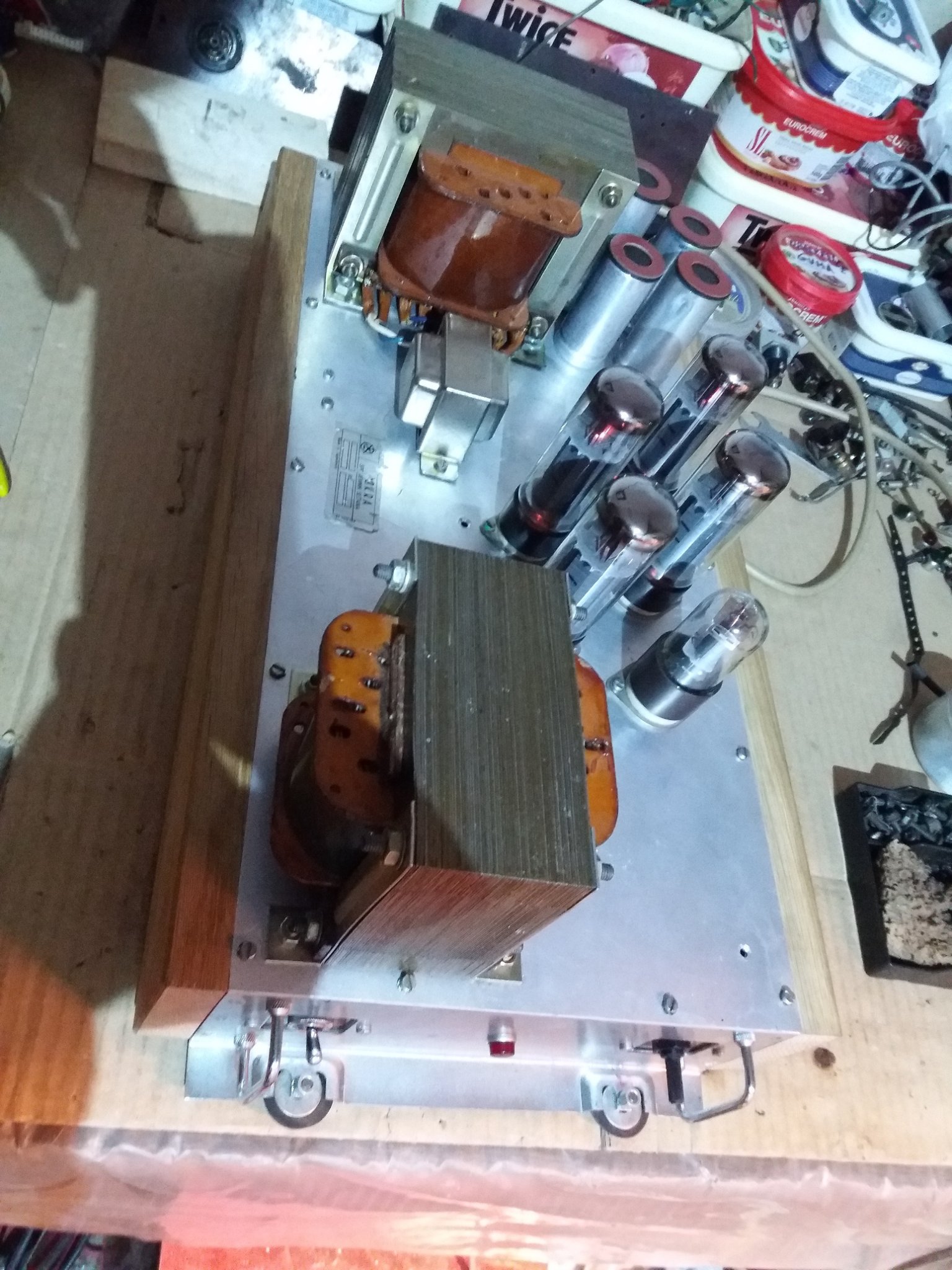

Personally I still have great fun by DIY good sounding tube amps , both for guitars and HI-FI use , where bunch of more tube amps parts waiting for me to be assembled together in more HI-FI tube amps mostly, but I`m more and more convinced that good hybrid amps is one very good solution for DIY ,by using tubes at input voltage gain stages and power Lat-Fet`s for OPS , think that this combination connect together tubes with almost perfect linear voltage gain characteristic and power Mos-Fets for power gain stages , where one very critical and expensive part as output power transformer is not needed anymore ,
and here`s one pics of one of my two ~100W AB class recent DIY tube amp monoblock, but also basic schematic of one really perfectly good sounding hybrid amp , which is designed by famous Russian designer Alexandar Bokarev ,

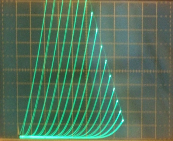

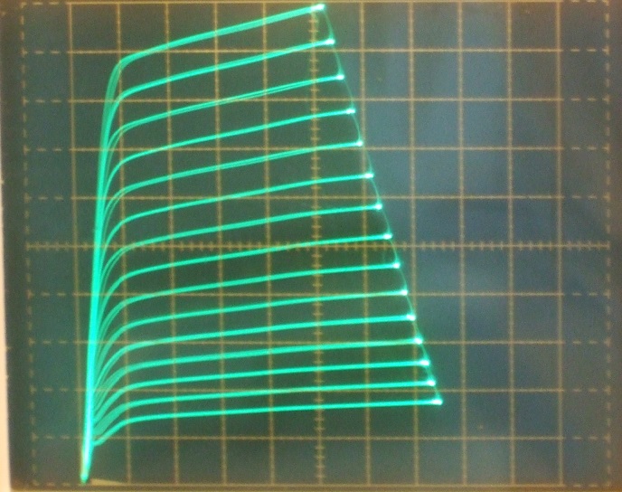

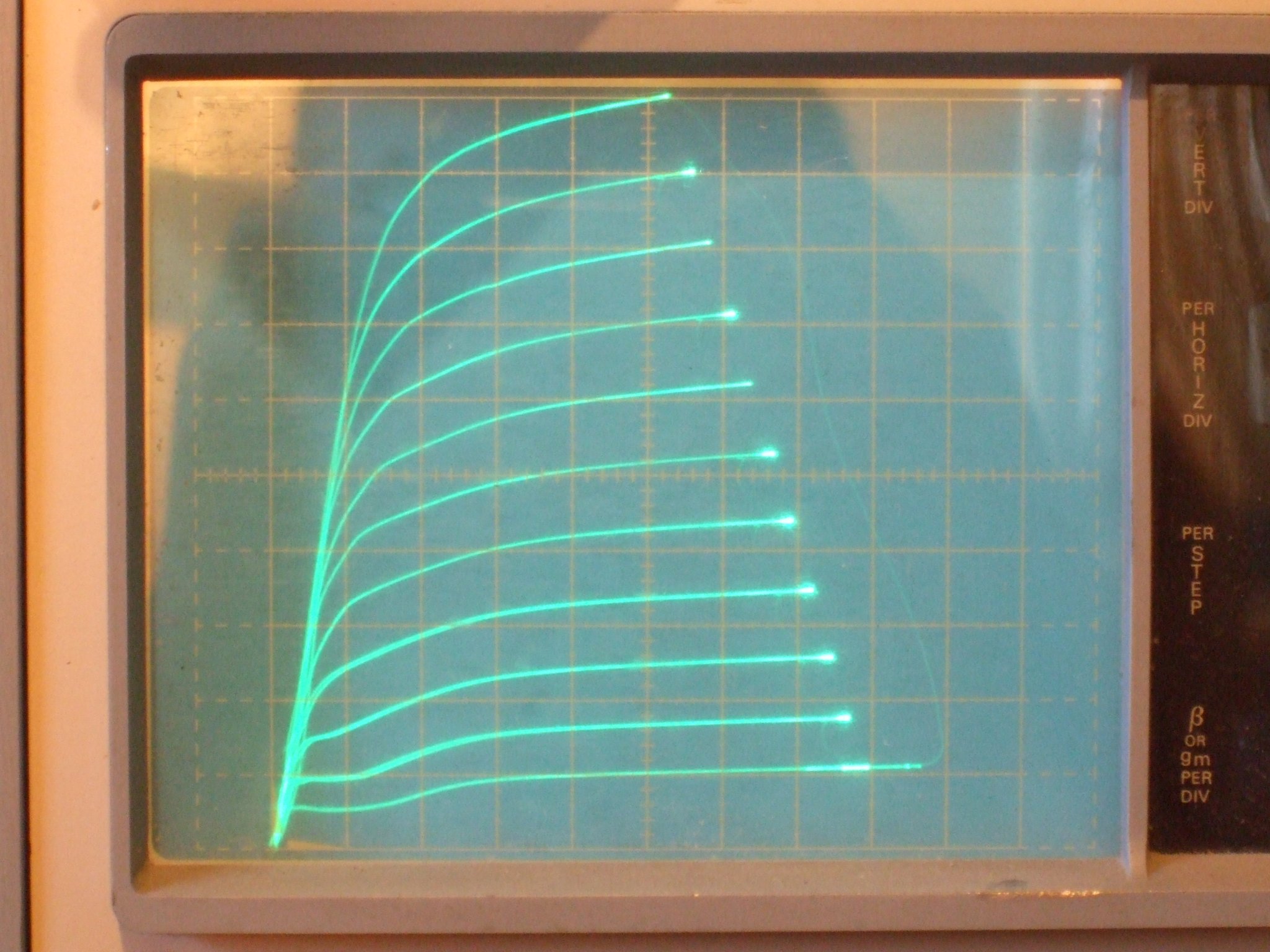

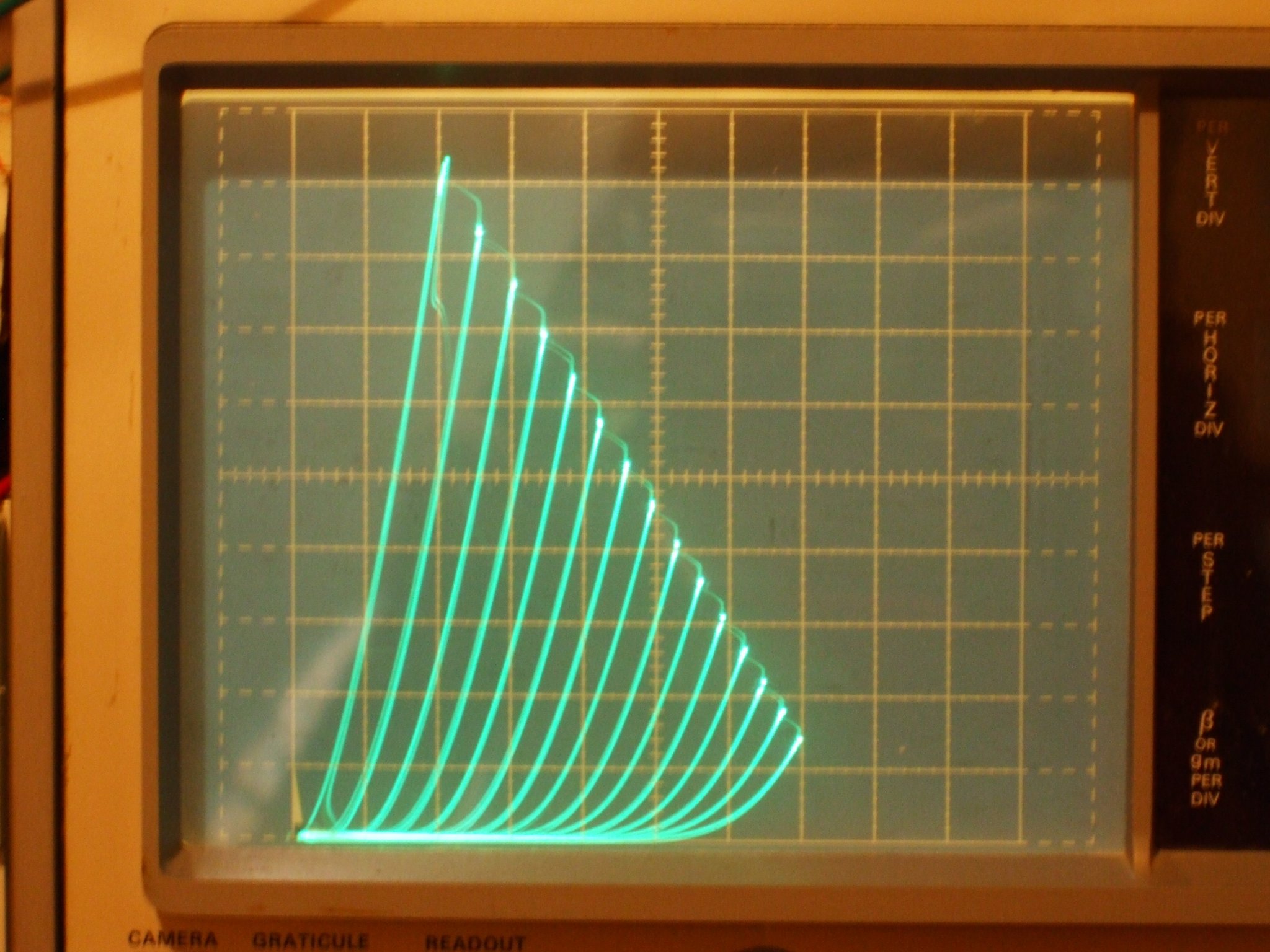

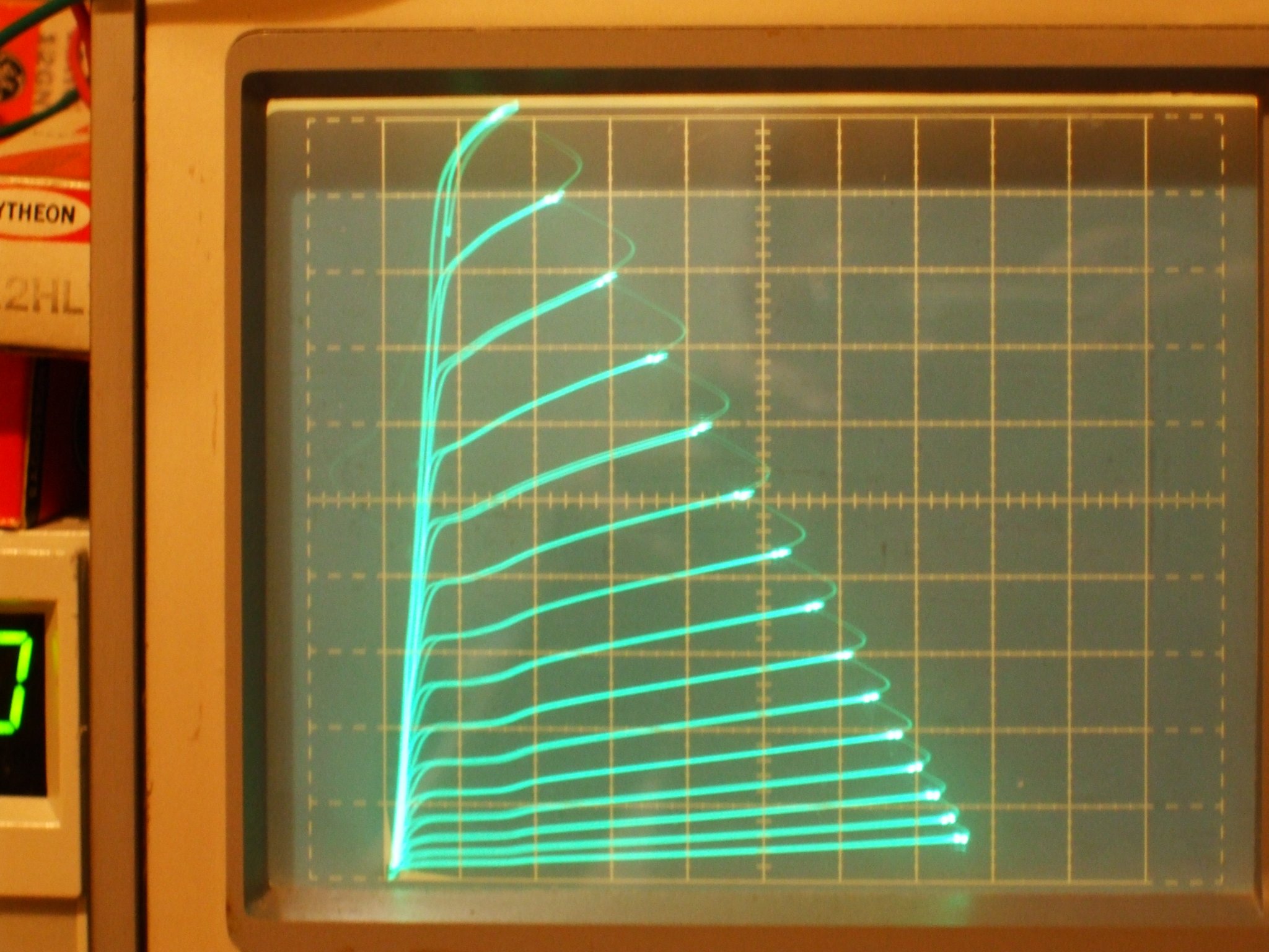

FUN tube times for me were when TV Sweeps and driver type tubes were plentiful and cheap. $1 or so etc. There was then the challenge of linearizing them WITHOUT a super expensive high BW OT to support gobs of global N FDBK. Hence the popularity of more "local" forms of N FDBK: UL, Schade, driver stage N FDBK from the OT primary, Triode mode outputs, grid 2 drive, Crazy Drive, UNSET, neg. R for fixing the OT (Audio Precision patent )... Failed experiments leading to "expired" tubes -occasionally- were no big deal at $1 a tube. You could practice your aim at the trash bin.
This all required some form of curve tracing to see the tube issues and the fix-up results, which led to the cheap (at the time) Tek 576 curve tracer and numerous upgrades to it for tube use. This soon revealed that most "Audio" tubes were actually the -more- distorting due to rounded plate curve knees (for reducing 2nd H, or 3rd H in P-P, but higher levels of high harmonics ). "Audio" pentode tubes have an optimum load Z due to the high screen current distortion used. Near Linear triodes can avoid this, but are scarce or dangerous to use. And $$$.
I found the ubiquitous FFT plots to be mis-leading and uninformative for design work, just more of a final report card. Using a simple triangle wave drive signal from a function generator with a differentiator OP Amp before the scope display was impressively more informative to see tube stage gain transfer functions and crossover problems (Wing Plots in the SS world, aka Audio Precision ).
Then there was the "treasure hunter" syndrome of looking for super buys on amazing "unknown" tubes. See tube curve traces below. The MIL 6197 for example, $0.35 each in boxes of 100, all matched, who needs 12BY7s.
And coming up with clever prototyping schemes. Some of these turned out to be so unusual, I just leave Amp builds in prototype form now. It's like having the 1st antique versions ever built from a century ago.
21LG6A, low screen current Sweep tube:
26LX6 Sweep tube in Crazy drive:
6HJ5 Sweep tube using UNSET:
6HJ5 Sweep tube in native triode mode:
6197 video (driver) tube, $0.35
6197 in native triode mode, mu 24:
12HL7 video driver in triode mode, mu 30, frame grid:
1E7G DHP in triode mode:
JJ KT77 an "audio" tube with well done knee corrections, notice near constancy of gm above 100V, 50V/div Horiz.:

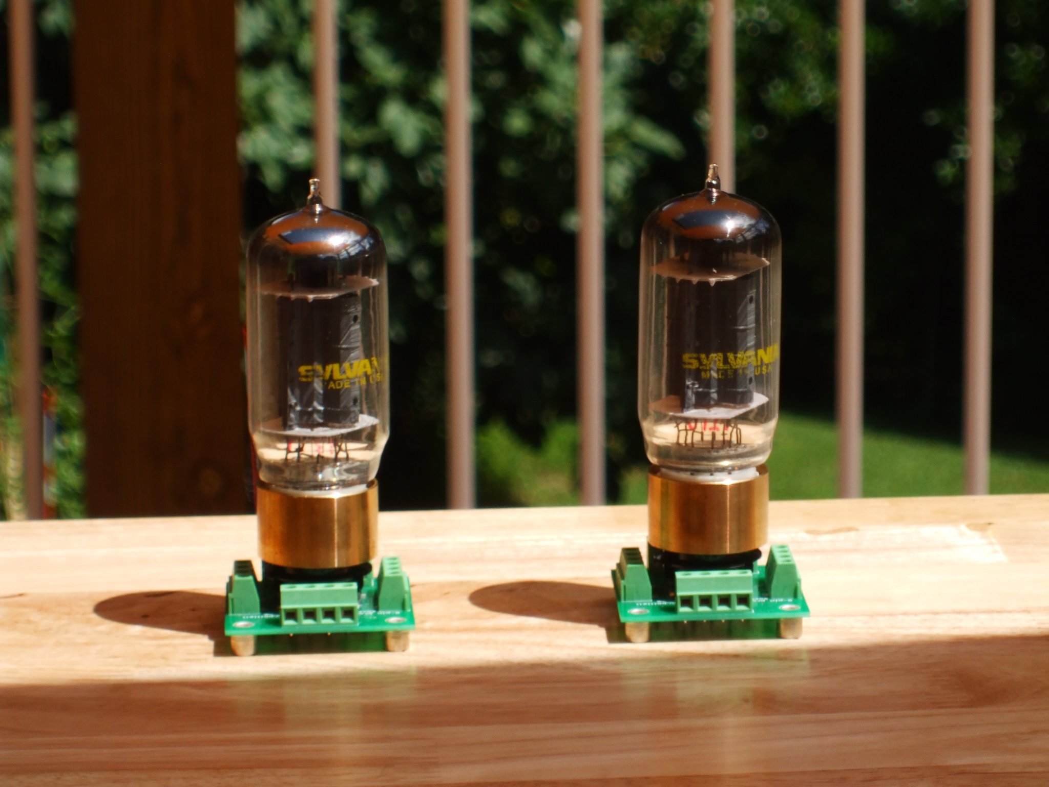

Surface mount tube sockets with Pomona Spring Clips for prototyping:

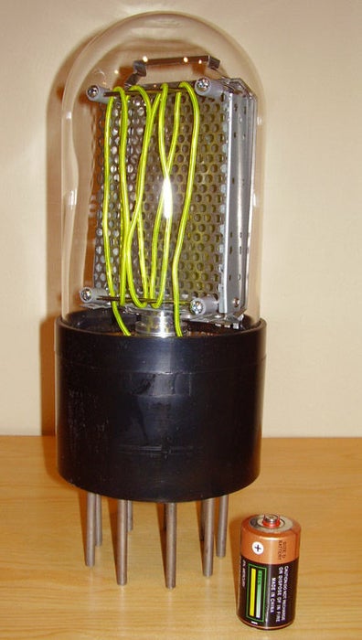

This is an old radio I picked up for something to tinker with during the height of the pandemic, when I was working away from home. It is from 1936, and is totally original apart from new caps, and an earthed mains lead.
Here it is playing through its field coil speaker, with its original 2A3 which only measured 5% on a tube tester ... it is not hifi, but it used to fill my bedsit with streamed music for hours on end.
