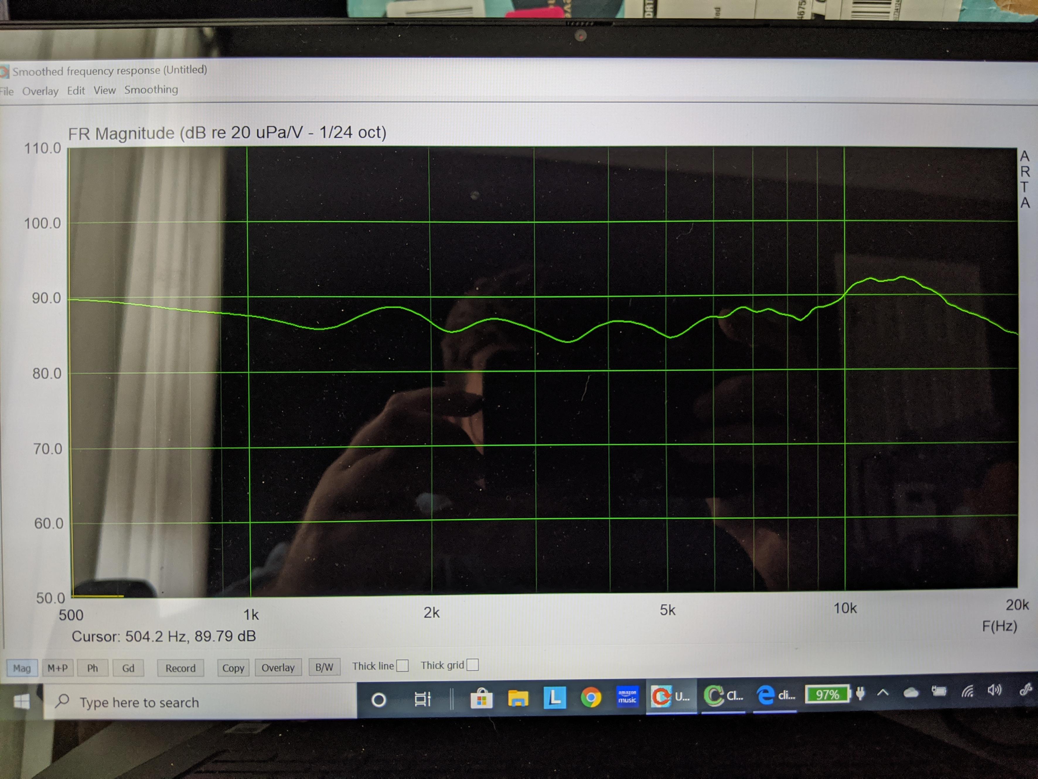

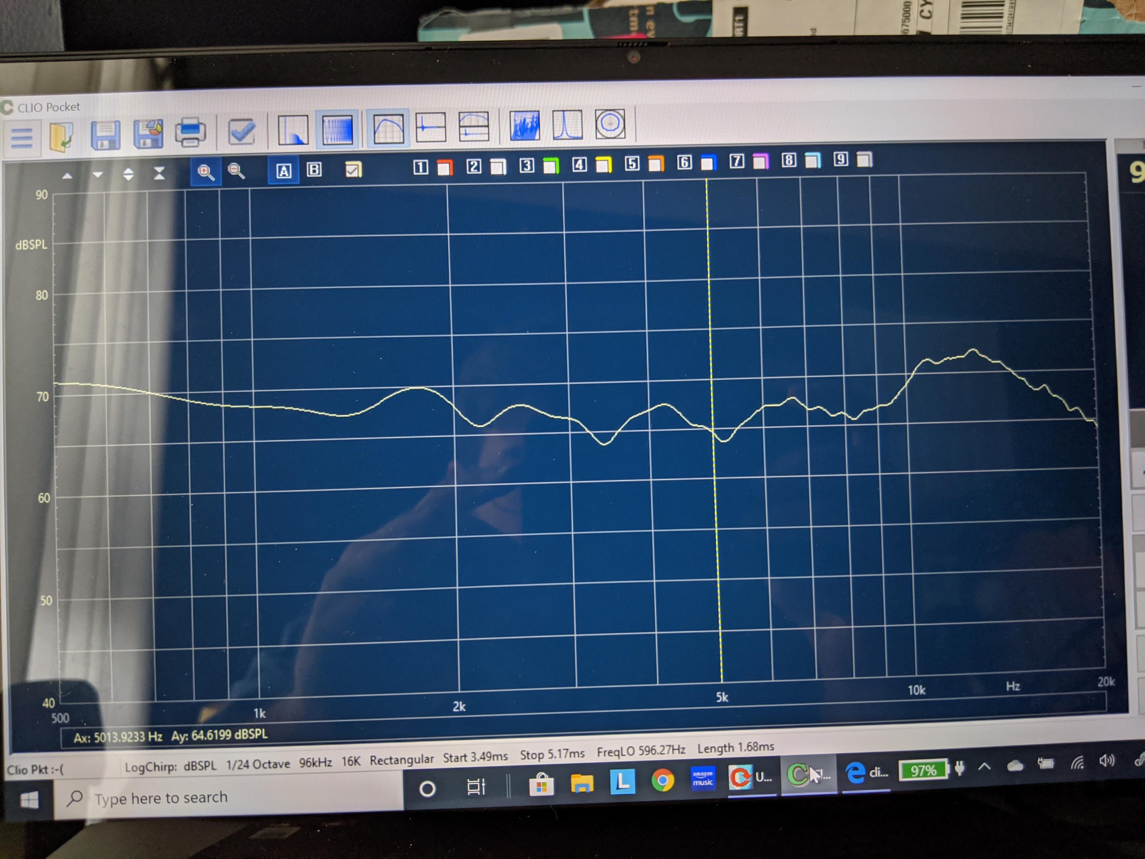

Ok...ARTA is great but making me feel pretty dumb trying to set it up ��. Still Comparing ARTA with Clio Pocket with the included mic. ARTA is with the Steinberg UR22MKII and using a EMM6 mic (not currently running the calibration file for the mic). The correlation between the two systems is very good other than the SPL is off. What should I be checking to get SPL in line? I have the listed mic sensitivity loaded into both programs.

Still not sure how to get a frequency response graph with true out put level. In Clio Pocket it's basically just point and shoot...I don't see why it's not that simple in ARTA. I'm sure I am missing something simple?

It is expected behavior. You must differentiate two modes of measurements:
Level mode (like spectral analysis of level in STEPS) – it measure Level on system output 20Log(Uout). In this mode result depends on generator level.
Ratio mode (like frequency response FR1 and FR2 and IR) – it measure log ratio 10Log(Uout/Uin). In this mode result does not depends on generator level.

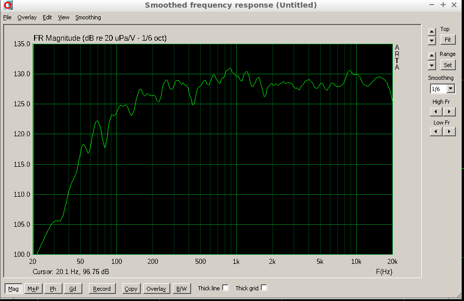

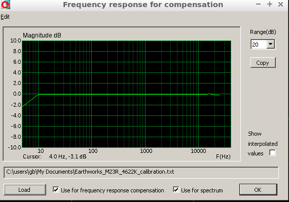

Mic Calibration
I have not yet used a calibration file with ARTA, my mic is very flat and to this point I've mostly been learning how to use ARTA.
However, I am now ready to do some more detailed measurements, so I loaded my calibration file.
However, I'm getting some unexpected results. See the attached.
The first pic is the setup of my calibration with the boxes checked to use it.
The second pic is the FR with those settings.
The third pic is the FR with the two radio boxes unchecked so that it doesn't use the calibration files.
What am I doing wrong here? The only change for the two graphs was checking or unchecking the boxes in the frequency response calibration settings.
thanks, gabo

When loading mic calibration file, if you calibration file contain unevenly distributed points at frequency axis, as is your case, please check the box "Show interpolated value ".
Then you will see two curves, one loaded and second calculated by interpolating values on frequencies of current FR.
You will probably see that in you case you have large differences at low frequencies. I've seen this behavior in several Earthworks calibration files, sent by users.
You can correct calibration file by loading it in some text editor and adding more dense frequency points. That will be give correct interpolation - with smallest differences from original file.
Ivo
