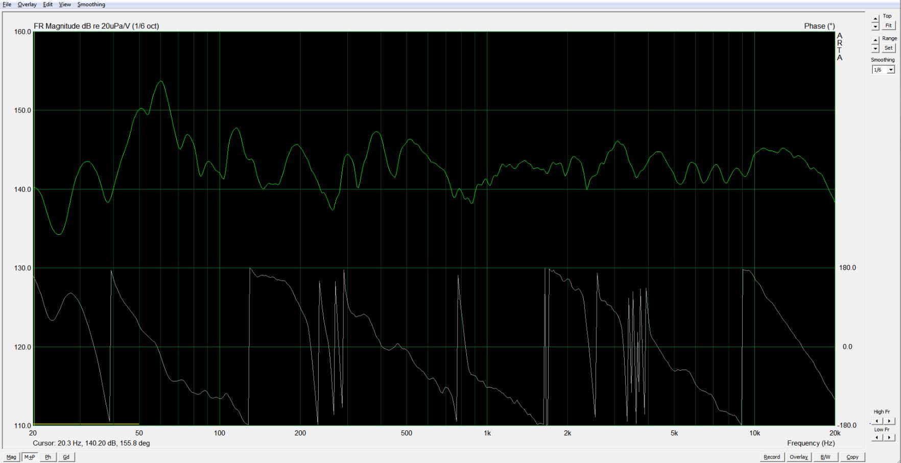

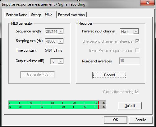

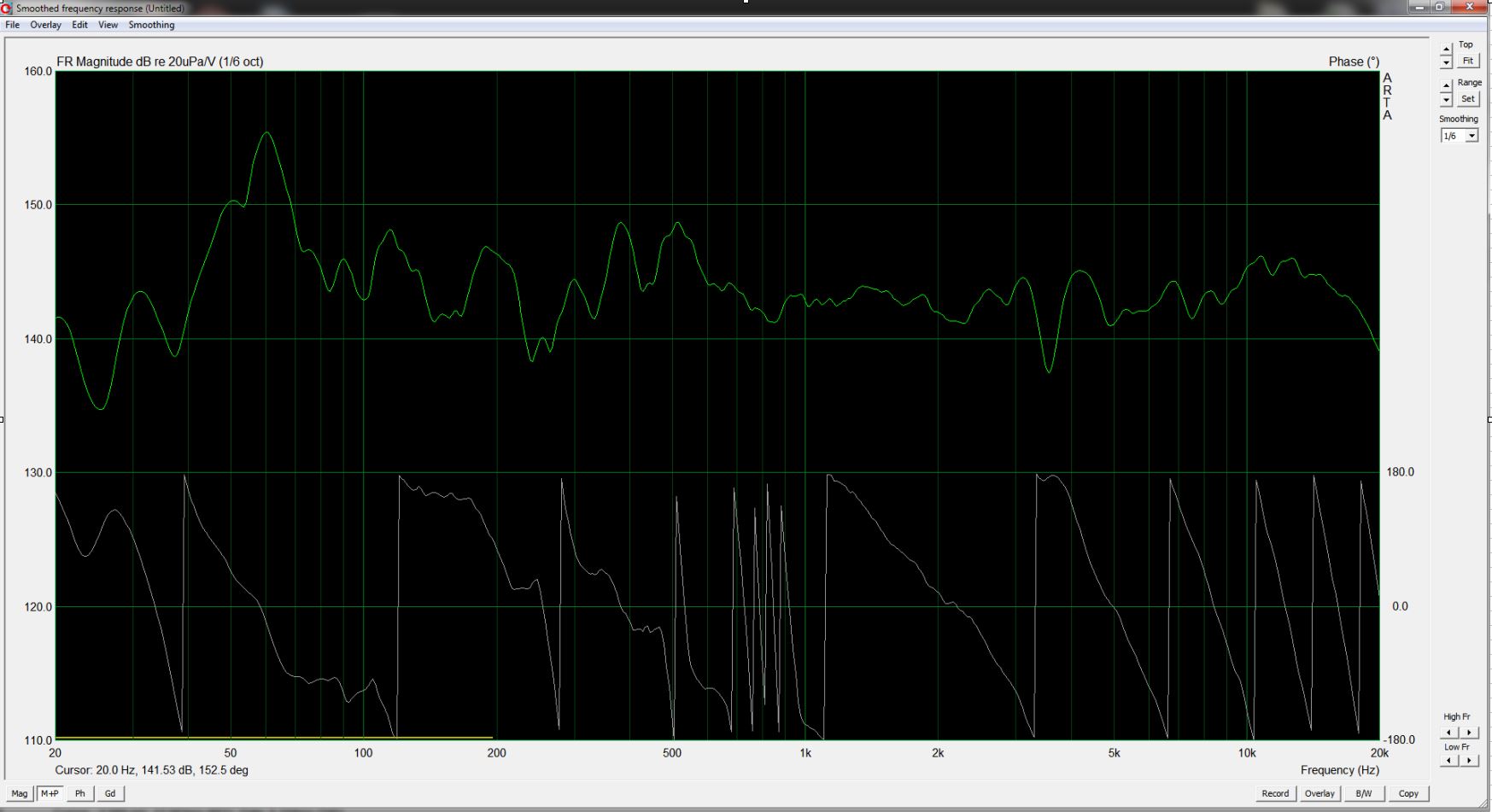

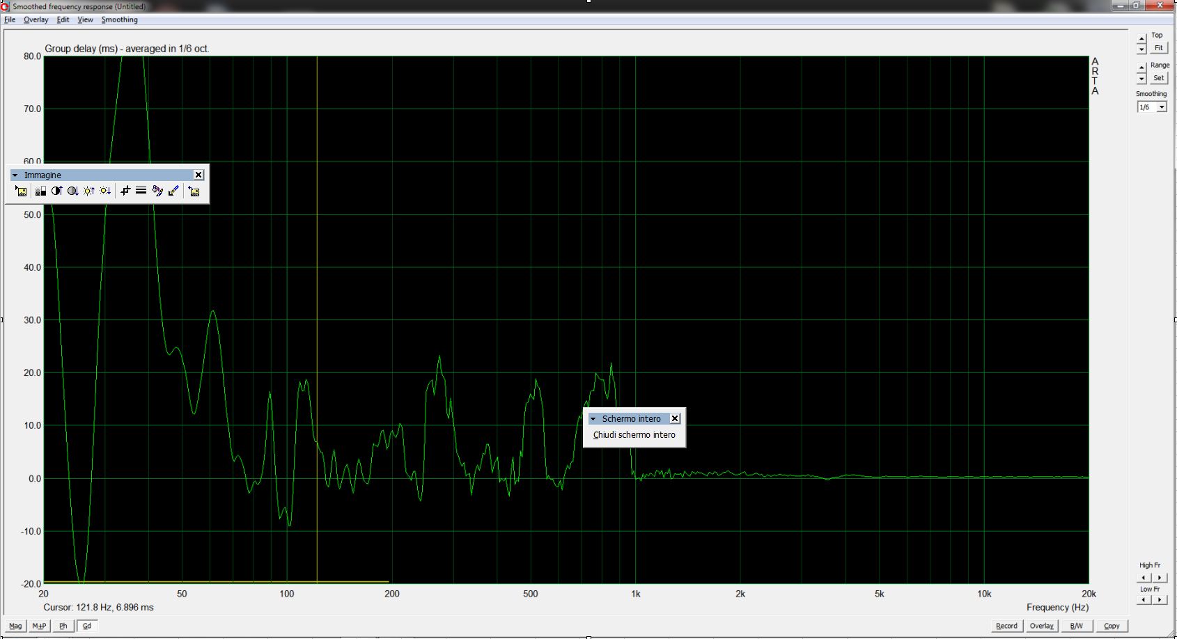

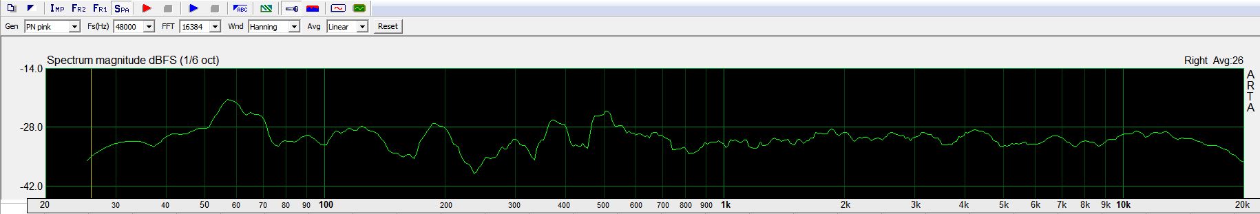

I add somes measure,
From listening point and microphone ears height.
I use a Beringer ECM8000, preamp and Realtek high definition audio integrate in motherboard.
The question is,
What happen in the region from 700 to 1khz?
Can ignore that? Or i have to consider a correction.
Tell me your thoughts all adivices welcome.
The speaker is a dipole.

It looks like reflections. But depends on where you are doing your measurements and obviously what the response of the speaker is normally. 1/time window will give you the lowest reliable frequency...but generally speaking I find that is still a bit optimistic. How far way are you measuring from? What is the closest boundary? Being a di-pole makes it even more complex. I use a lot of ground plane measurements to help give me a longer window. Just a few things to consider.

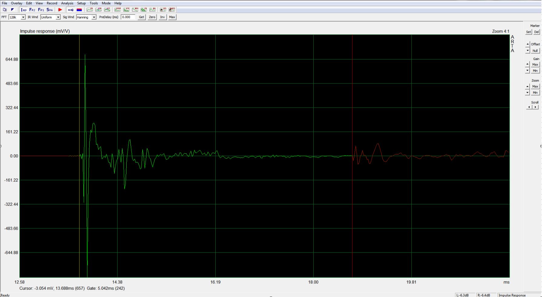

I had chosen the windows at the first reflection, what time do you suggest?
If your microphone is 2.6 meters away and your back wall is 1.4 meters away...there is a very strong possibility that you are getting a strong reflection from the back wall... especially since you are di-pole...if you double the distance to the back wall, it is 2.8m...almost the same distance as your microphone. If you are trying to get the response of the room and the speaker together than it doesn't matter, but if you are trying to get just the speaker alone...you might try moving the microphone closer (1 meter) and putting some blankets/pillows on the floor between the mic and the speaker. Your floor bounce is most likely your first reflection. I would suspect your first reflection in the measurements you have shown are right after the 14ms mark.

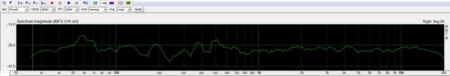

If you just want the sound of the speakers at the listening position the you may want to use the RTA function. Or don't use any gating on your impulse response and run the measurement to take the average of 10 to 20 averages...then apply smoothing.

Hi Erik,
so you were right, the 1 meter measurement has a regular phase.
Listening point 2,60 meter and 1 meter.

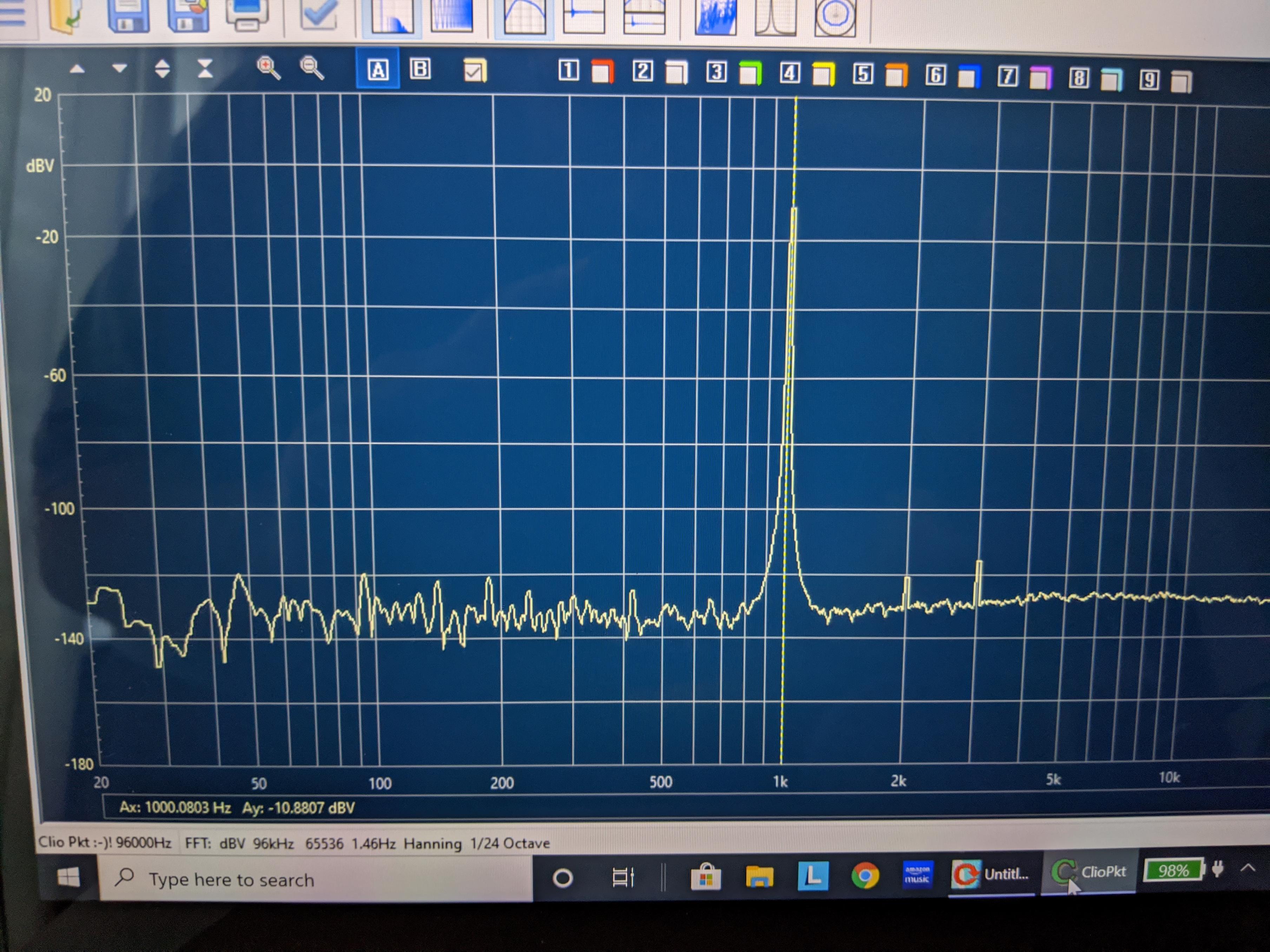

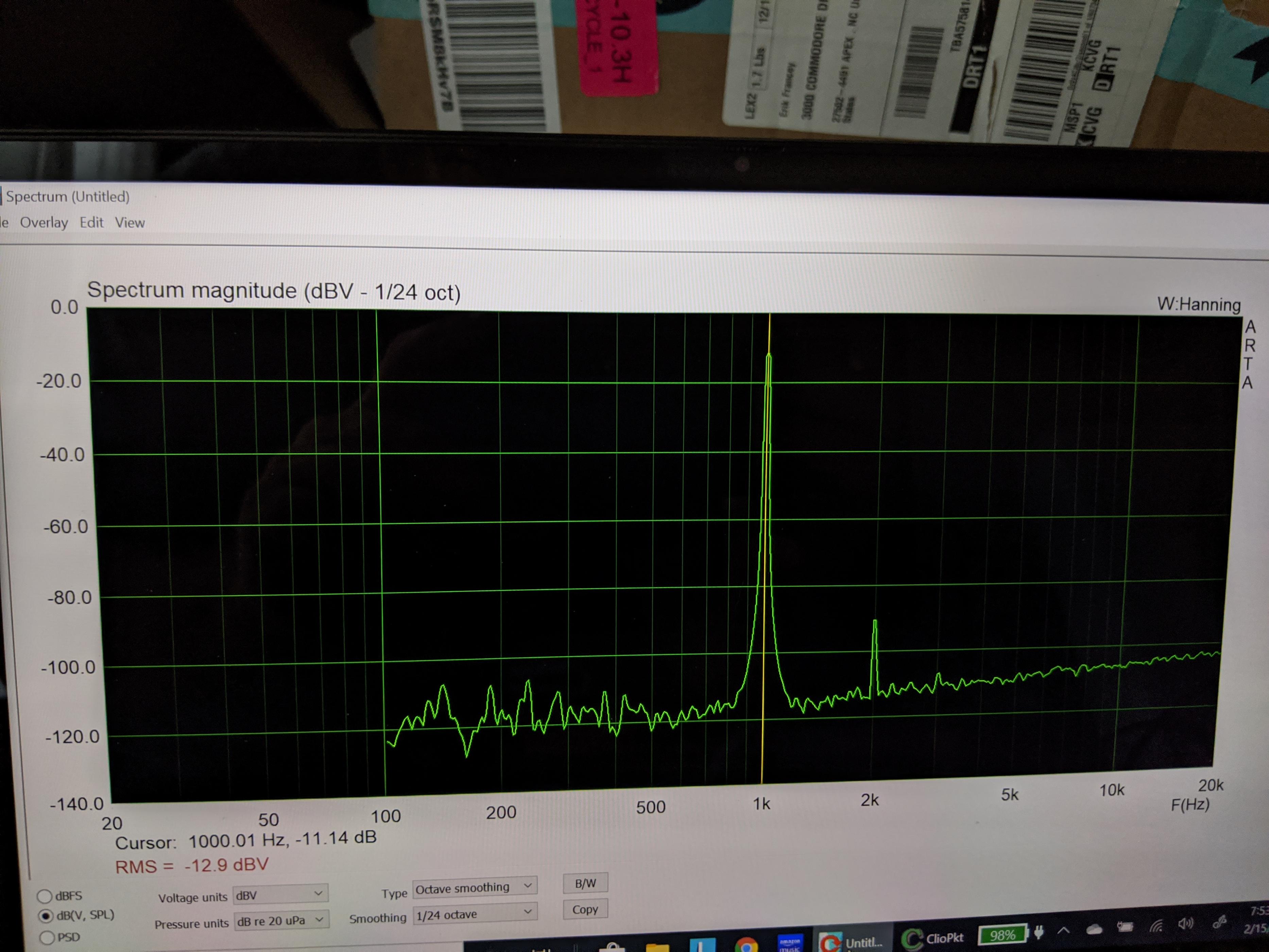

I am trying also to calibrate ARTA. I am trying to get a 1KHz signal to match the reading I get in Clio Pocket. Using Clio Pocket as the source. I see that using spectrum in ARTA the it is always smoothing at least 1/24th. With out setting Clio to 1/24 smoothing there is about a 10-12 dB difference using dBV scale for both. When I set Clio to 1/24 smoothing I am about 1or 2 dBV off. If I do an impulse measurement of the same signal is closer. I have attached a few pics. What I am unclear on is, once calibration is done, wouldn't adjusting levels on the sound card throw off calibration? Shouldn't ARTA have some way of controlling level from within? I see it can go as low as -20 dB for some measurements but in my system for spl measurements that isn't enough attention? I am not an electronics expert and don't have much experience using scopes. Mostly just acoustics.

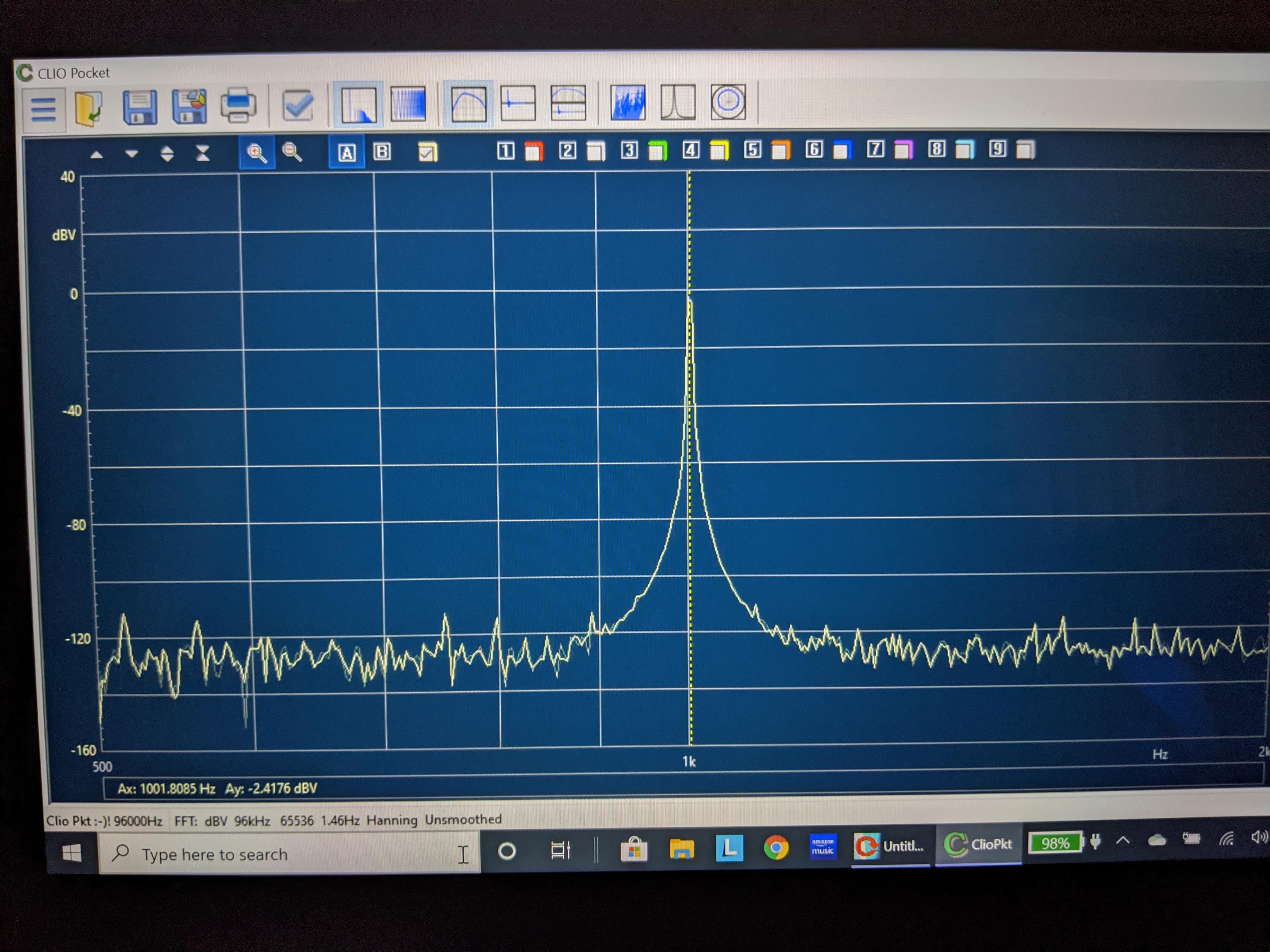

Arta feeding ClioPocket 1k sin at 1V and ClioPocket feeding Arta 1k sin at 1V...I'm assuming since they are both reading the same I have Arta calibrated properly? I did this with inputs on the Steinberg UR22MKII turned down all the way and Output gain turned up all the way. I did this so it is easy to keep calibration set( I don't have to recalibrate it I bump a gain knob). I was surprised that it still passes signal with inputs turned down all the way. But it seems to work.

Sorry looking at it I can see how you would think that. I have cursors set as close to ok as I could get. If you look at the bottom left of each screen they are reading -2.5ish dBV. The cursors make it look like it's at 40dBV.
