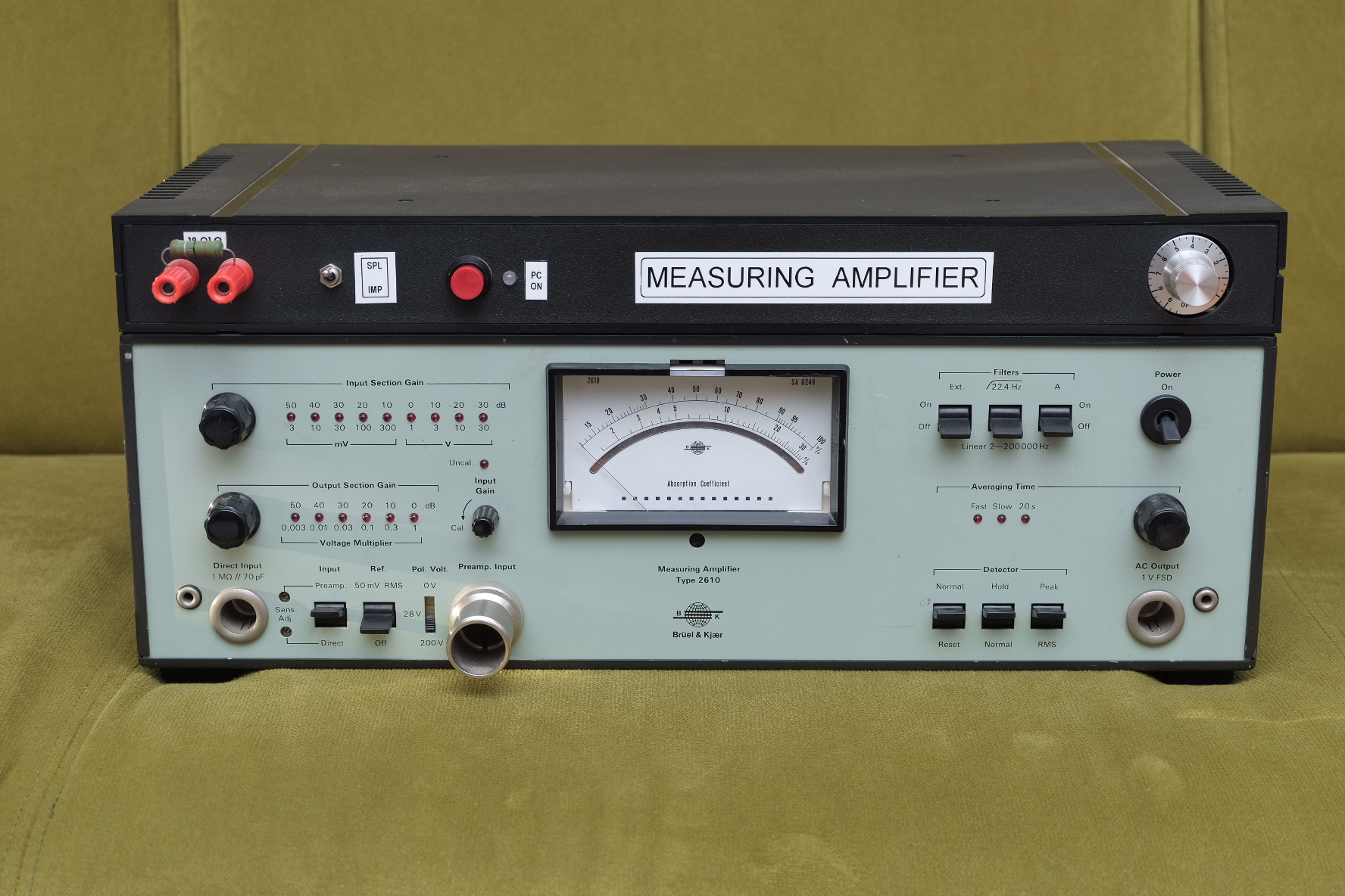

I was using Maudio Transit, it worked ok but willing to upgrade. Selling my Bruel Kjaer 2610 with mic and computer. Upgrading to 2690.
