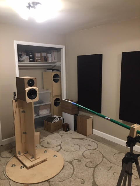

Simon,
I believe gate time was about 4.5ms.
Mic was about 800mm from the baffle, 1150mm from the nearest boundary (i.e., ceiling).
EDIT: attached a measurement from this morning along with a picture from my setup. Speaker baffle is about 1000mm from back wall. Mic is about 1200mm from the ground and 1150 from the ceiling and 787mm from speaker baffle.

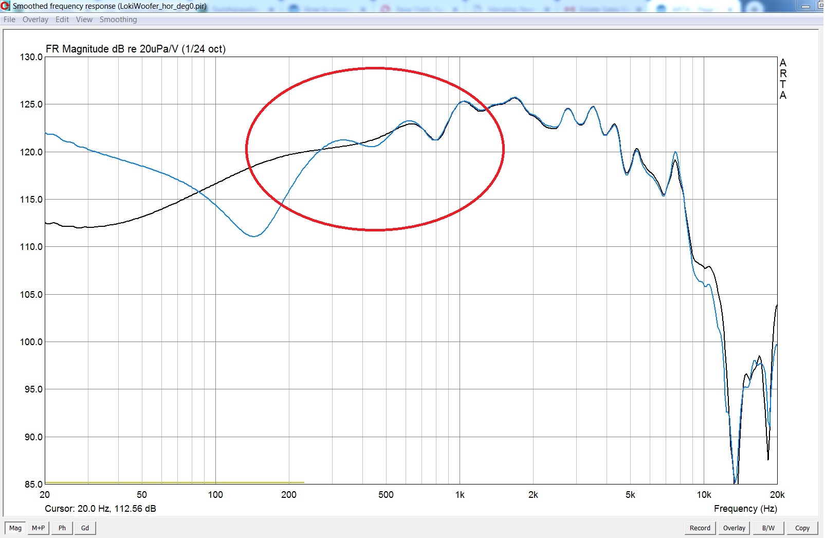

Thanks Ergo,
Unfortunately, the issue continued with using longer sweeps. I've not had the same issue with REW or HolmImpulse - but I still want to stick to ARTA because its integrates so well with VituixCAD. I've read through VituixCAD's measurement preparation document and learned about merging far-field with near-field. However, with near 4.5ms of gating time, I was hoping far-field measurements would be accurate in the 300hz - 600hz range. Unfortunately, I'm having as much as 1db-3db variance in that region, which I think can drastically impact the level (SPL) at which I merge far-field with near-field --> which I'm concerned can further impact the tonal balance of the speaker (e.g., too much or too little bass).

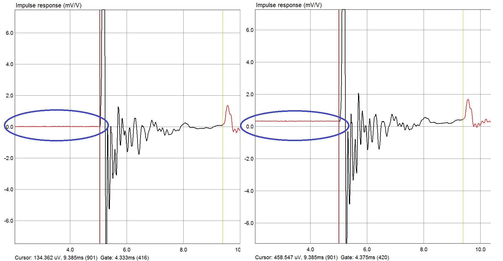

One thing I'm curious about is why, when making consecutive measurements, sometimes the impulse response starts a level zero, and some times slightly above/below it. It seems to correlate with how the FR is then derived (with more wave-ness when the IM response is not starting at level zero). See attached images - I'm really not explaining it well.

Dhar,
That looks like some sort of DC-offset or maybe just a simple ground-loop ( measured against a reference channel while in 2-channel mode > though I don't really know which ).
Hopefully it's not a dc off-set caused by your sound card starting to fail.
Are you able to move your measurement setup to a laptop ( running on batteries ) ?
If so ( & the problem goes away, it's a ground-loop ) you'll want to continue in that battery mode or get a high quality Iso-Transformer ( to put on the output of the sound-card ) or find some other way to break up ( what's quite likely a ground-loop ).

Hi DKalsi,
there could be several sources of error that manifest as subsonic (alost DC) shift:
1) air conditioning changes sound velocity and generate noise in subsonic region.
2) impulsive noise can contaminate swept sine measurement more than PN Pink noise (try make measurement with both)
3) when using swept sine the measurement duration is double the value of swept duration, so be quiet until measurement stops.
4) loudspeaker can exhibit large hysteresis distortion, so try to give loudspeaker burn in time.
5) there can be changes in connector resistance during measurements (typical for on-board cheap connectors).
6) clipping of signal is also generator of subsonic noise (check time record of signal??)
7) some sound cards (like Scarlett or Behringer) has bad channel separation which can contaminate dual channel measurement (so give try to single channel measurement??)
8) some soundcards has very high distortions on low frequencies (like Steinberg UR22).
9) battery operated microphones, ground loops, and more...
try to eliminate all this????
Ivo
This is probably due to signal to noise ratio in low frequencies. Don't know how loud was your excitation signal, but worth a try to make speaker play louder. Also sine sweep will be more immune to SNR at same level compared to MLS ... again don't know what type of test signal did you use.

Indeed. With a 4.5ms gate time you will only get useful measurements down to approx 300Hz, anything below that is going to be inaccurate and may be inconsistent from one measurement to another.
Another thing I notice is in the impulse response image in post #682 the start marker is awfully close to the start of the impulse. In single channel measurements with some sound cards there can be a small random differences in signal propagation delay through the sound card drivers from one measurement to another.
This causes the reference point for the start and end markers to move around slightly each time you take a measurement. If the start marker is too close to the beginning of the impulse and the delay on one measurement pushes the marker too close to the impulse you can end up truncating part of the beginning of the impulse, depending on what windowing method you have selected.
While this won't be the cause of the DC offset in the impulse it can add significant errors in the frequency response. There are a few things you can do to avoid this.
1) If the sound card is doing this, find a better sound card. Better quality cards don't have this issue with random sample processing delays each time the device is opened.
2) Use dual channel mode - in dual channel mode the extra random delay will be the same in left and right channels and will cancel out. Dual channel mode ensures absolute consistency in timing from one measurement to another which cannot be guaranteed in single channel mode.
3) Back the cursor off a bit. I always put the start cursor significantly further before the beginning of the impulse than you show here. There should be silence before the start of the impulse so going a little bit too far before the impulse should not affect the response so it's better to have the start cursor a bit too far to the left than too close to the impulse.
I would also bring that end cursor slightly to the left. Depending on what windowing algorithm you have selected, that cursor is too close to that obvious reflection (the downwards dip) so some of the reflection will be included in the measurement especially if there are timing variations from one measurement to another.
If you have made good choices for start and end cursors you should be able to move them around a little without any significant change in the response, and this is one way that I check I have them well positioned.
