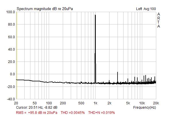

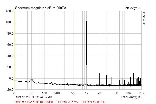

i got curious and did a loopback test on a umc22, not stellar in any way but still adequate for acoustic measurements i think![]()
That's pretty good. Are we talking about the same thing, UMC202HD single ended out to single ended inst in?
no, my test where for the smaller umc22, line out to line in
below, line out to mik in

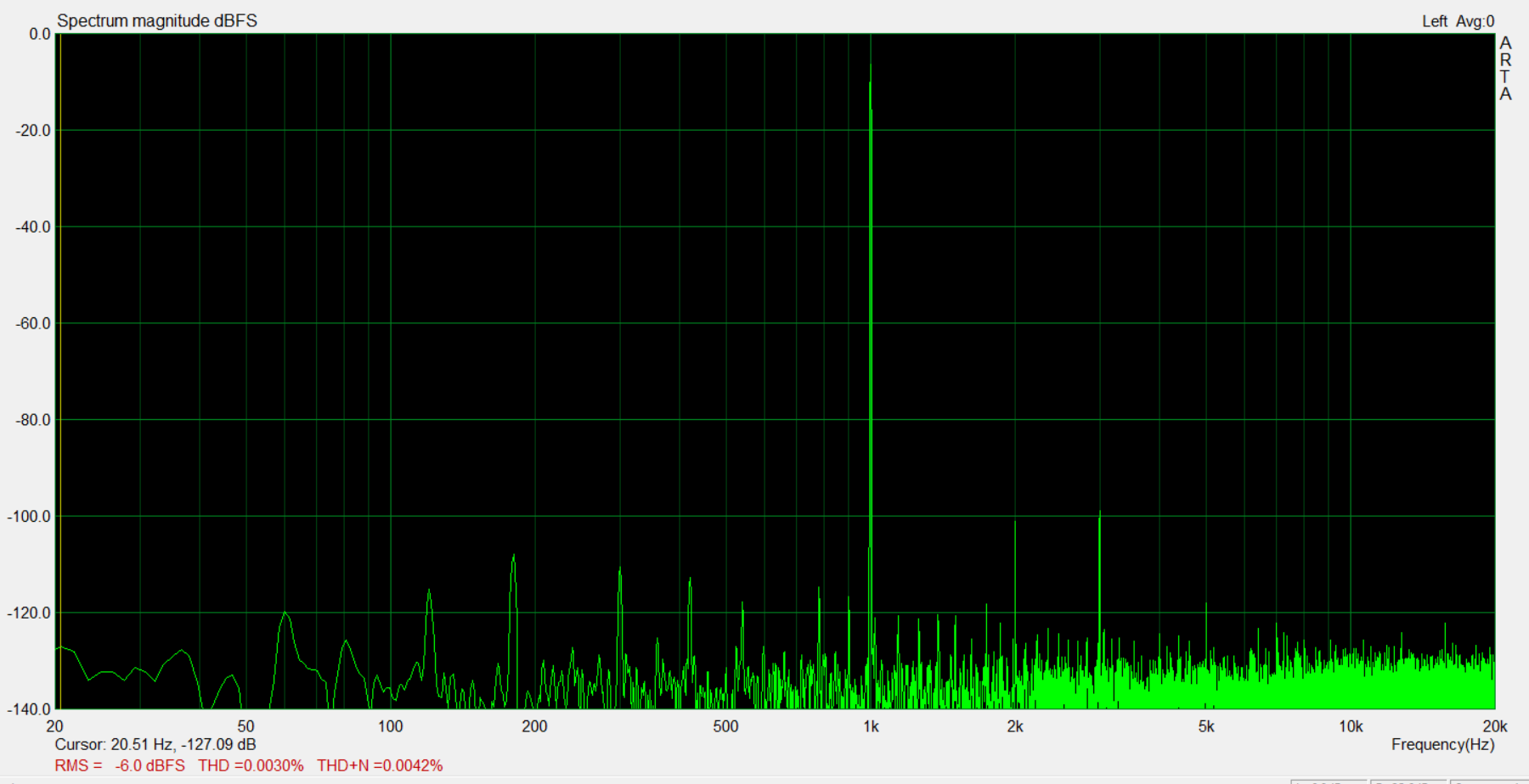

I took some measurements of mine over in this thread:
https://www.diyaudio.com/forums/equ...-audio-interface-measurement.html#post5233173
The summary is that a line level unbalanced signal input via the TRS socket on the front going through the preamps has a 2nd harmonic that is only about 55dB down - not very good.
But the same unbalanced signal input using the insert inputs on the rear has the 2nd harmonic more than 100dB down - which I think is perfectly adequate at the price point...
A floating balanced signal (such as a transformer secondary) on the front TRS inputs also has the 2nd harmonic about 100dB down.
