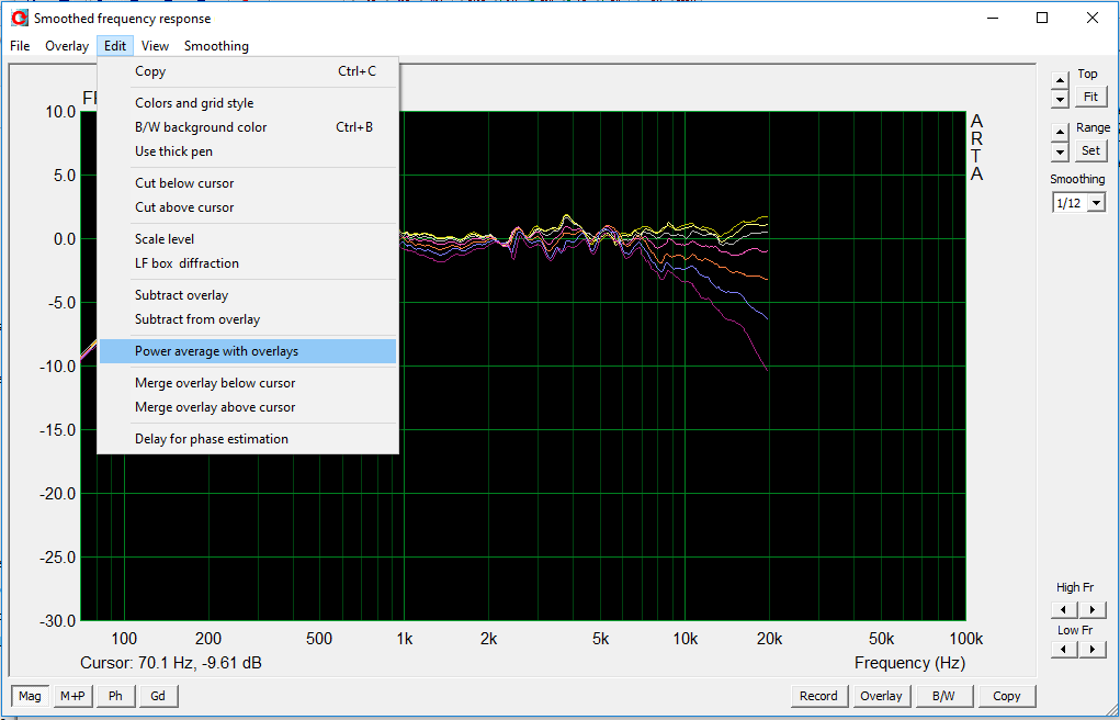

Is there a way in ARTA to calculate the average respons from a range of measurements? For example to calculate the average response over a 30 degree section?
If you are after a power average of a group of impulse measurements, this can be done thru the Edit menu on the Smoothed frequency response window. See page 93 in the Users Manual. Open your impulse measurement, use the Single-gate smoothed frequency response, select smoothing as desired, and then save as an overlay. Repeat for each of your +30deg thru -30deg measurements. Then select the "Power average with overlays" option from the Edit menu. You can export the result as an ASCII or CSV file.
If you only have measurements for 0deg to +30deg, you can enter the +deg measurements twice(saving as 2 separate overlays) to cover the -deg space.

Thanks for pointing that out. In practice this hasn’t proved to be a bothersome limitation.…averaging overlays and current curve is possible only if all responses are measured with same sampling frequency and smoothing…
When taking polar measurements most(all?) people leave the sampling frequency and smoothing settings unchanged from measurement to measurement.
That would speed things up a bit…loading up all angles at once rather than one at a time as overlays. Still, the capability is currently there and not too difficult to do; certainly quicker and easier than exporting to Excel or other program for processing.It would be really great if you could do it within ARTA, from the same menu and with the same way of loading the files as with the polars.
If you ever want or need to average a set of measurements taking into account their relative phase (rather than power averaged) ARTA can do that too. Use the “Load and Sum” option from the “File” menu of the Impulse Response Window to sum the impulses for all the measurements of interest. Then use the “Scale” option from the “Edit” menu to divide the magnitude by the number of measurements. Finally, set gating and calculate frequency response as usual.

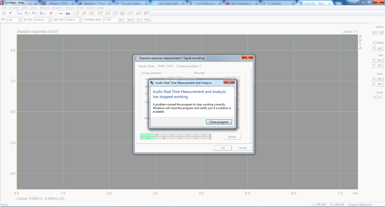

I've recently realised that ARTA 1.9.1 is crashing for me when I try to use the swept sine measurement method. As I normally use periodic noise (which works fine) I had not noticed this until today, so I have no idea how long this problem may have existed and through which versions.
I also stopping using ARTA for a few years (no chance for speaker development during that time) before coming back to it and when I started using it again it is with different hardware, both different PC and different sound card. I remember that swept sine worked for me with my original PC and sound card many years ago.
The crash occurs immediately following the sine sweep but before any results are displayed and happens every time.

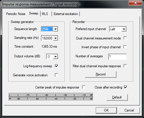

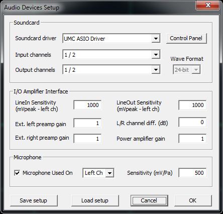

I'm not sure what information you might require so for the moment here are screenshots of my audio device setup, the sine sweep configuration, and the crash itself.
The PC is a Samsung laptop running Windows 7 x64 and the sound card is a USB Behringer UMC204HD using asio drivers.

there is no difference in how ARTA record noise and swept sine.
The problem can be with a driver or with laptop.
I've not tested Behringer UMC204HD. Does it have control panel to adjust sampling rate?
Unstability of usb souncard drivers is typical with laptops:
- Try to measure at least 2 minutes or more after system boot. Sometimes drivers need several minutes to settle.
- Disable WiFi
- Assure that system is updated (to minimize background processes).
- Set the same sampling rate in ARTA and in soundcard control panel.
- Try different sample rates.
