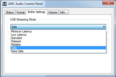

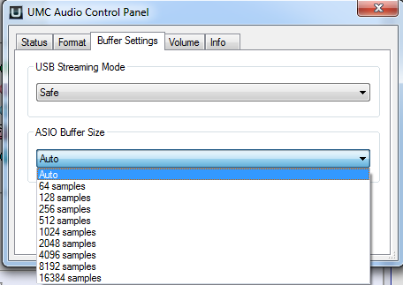

I found it only crashes with a 262k sequence length, smaller sequence lengths are OK.
After your suggestions I think I have found the issue. The sound card control panel allows adjustment of "USB streaming mode", which seems to be a latency adjustment, as well as "ASIO buffer size". Buffer size was set to Auto. See screenshots.
With USB Streaming mode set to the default "Safe", ASIO Buffer size set to the default "Auto", crashes were occurring.
With ASIO buffer size manually set to 4096, 8192 or 16384 samples it appears to work fine on the swept sine sweep without ARTA crashing.
If I try to choose a value below 4096, it reports "The selected ASIO buffer size is too small for the current USB streaming mode and the current sampling rate". Strangely no setting for buffer size except "Auto" causes ARTA to crash.
Do you have any recommendations for streaming latency and ASIO buffer size in general or does a higher latency and/or higher buffer size mode not cause any issues with ARTA ?

Simon,
I usually recommend buffer size from 256 to 2048 samples (the larger sampling rate dictates larger buffers), but it seems that your card has larger latency than is usual in ASIO practice.
Hi Ivo,
Thanks. The interface does have 7 different latency settings from "Low Latency" to "Extra Safe" as depicted in the screenshots, the default setting of "Safe" which I am currently using is the second from highest latency setting.
Unfortunately Behringer don't state the latency in ms for each setting instead using an ambiguous descriptive word. From what I've read online the lowest latency setting is approx 1ms while the highest is about 30ms, so it is probably about 25ms at the moment.
I can easily reduce the buffer size to 2048 samples and then reduce the latency setting as well until it no longer complains that the buffer is too small, but I'm not sure a lower latency provides any benefit unless I am using the RTA mode ? I generally only use impulse measurement mode.
Lower latency modes increase the risk of dropouts if the laptop/OS is slow ? Would ARTA provide any indication of an error if a dropout occurred or would there simply be a random glitch in the impulse recording if this happened ?
It's good you found the culprit -- but it's strange that the problem depends on the signal type. Sweep crashes, noise does not crash. How would the soundcard / driver worry about signal shapes in such a way?
I can only assume it's something to do with differences in the recording length as the periodic noise and swept sine methods do not playback/record for the same length of time. But it does still seem strange. I don't know what the Auto setting is doing because it does not crash with any of the manual buffer size settings... a buffer that is too small does corrupt the audio dramatically but still does not crash.
Hi Simon,
you guess right, swept sine acquisition system uses double length than noise acquisition. That problem has occures only on 256 k signal length, (acquisition length 512 k) and sampling rate 192kHz.
In ASIO "auto mode" ARTA sets ASIO buffers to 1k length. Obviously it is not enough for this card as you've got report "The selected ASIO buffer size is too small for the current USB streaming mode and the current sampling rate" if it was lower than 4k. So you must use manual mode ? Nothing strange here!
Who crashes: ARTA, ASIO, or windows process thread system I don't know.
The problem arose with newer sound cards that use 24-bit transfer even at 192kHz.
I will certainly in new ARTA version add new checking of required buffer size.
Thanks for report.
Ivo
