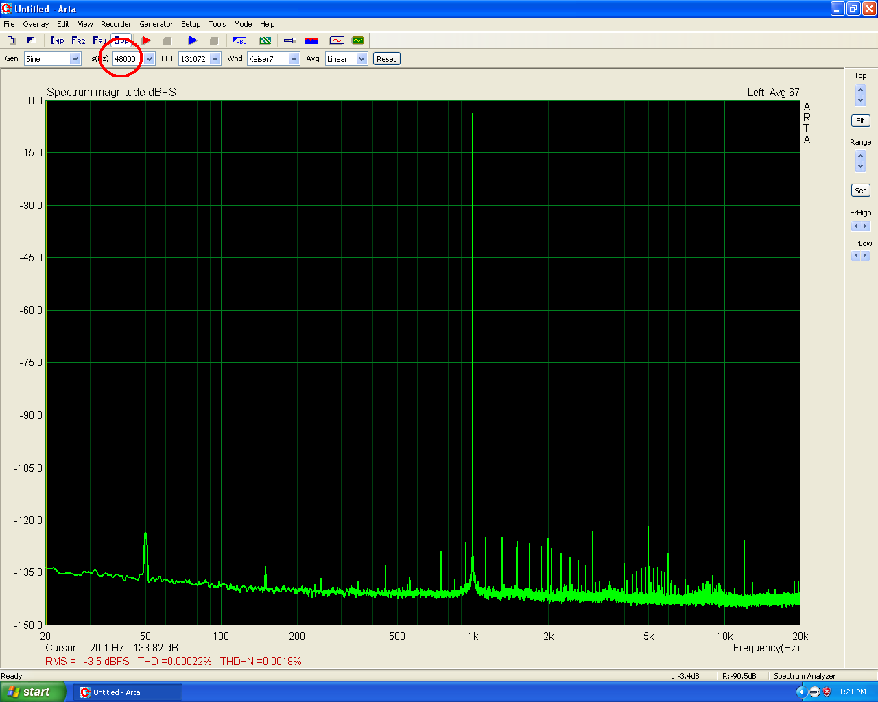

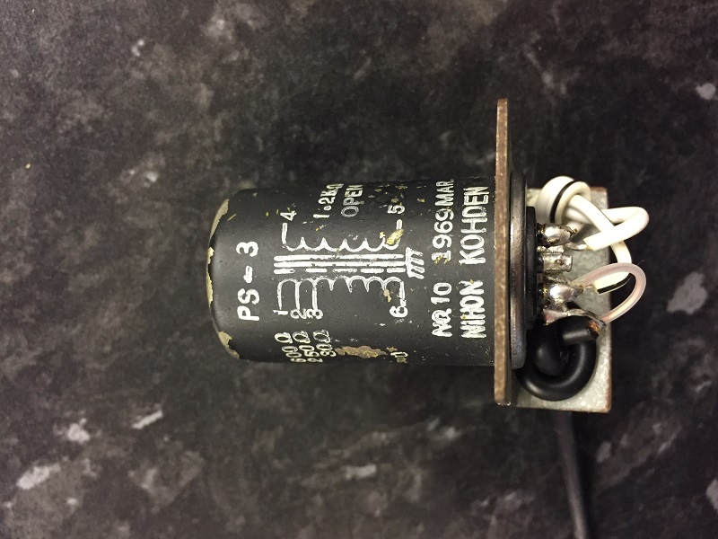

I've just dug out the transformer in question and wanted to correct the record on the impedance of the windings, which are not quite what I thought.
The primary is 1.2k ohms and I am using the 30 ohm secondary tap to go to the line input of the sound card - which is an impedance step down ratio of 40 to 1.
I see on the can that it was made by Nihon Kohden and appears to date to 1969. :cool: Anyone recognise what equipment it is out of ? It sure works well in this application.
It looks from the diagram that it has a Faraday shield between primary and secondary as well - although I'm not using that as I don't have the screw on the bottom of the case earthed, but I could easily do so.

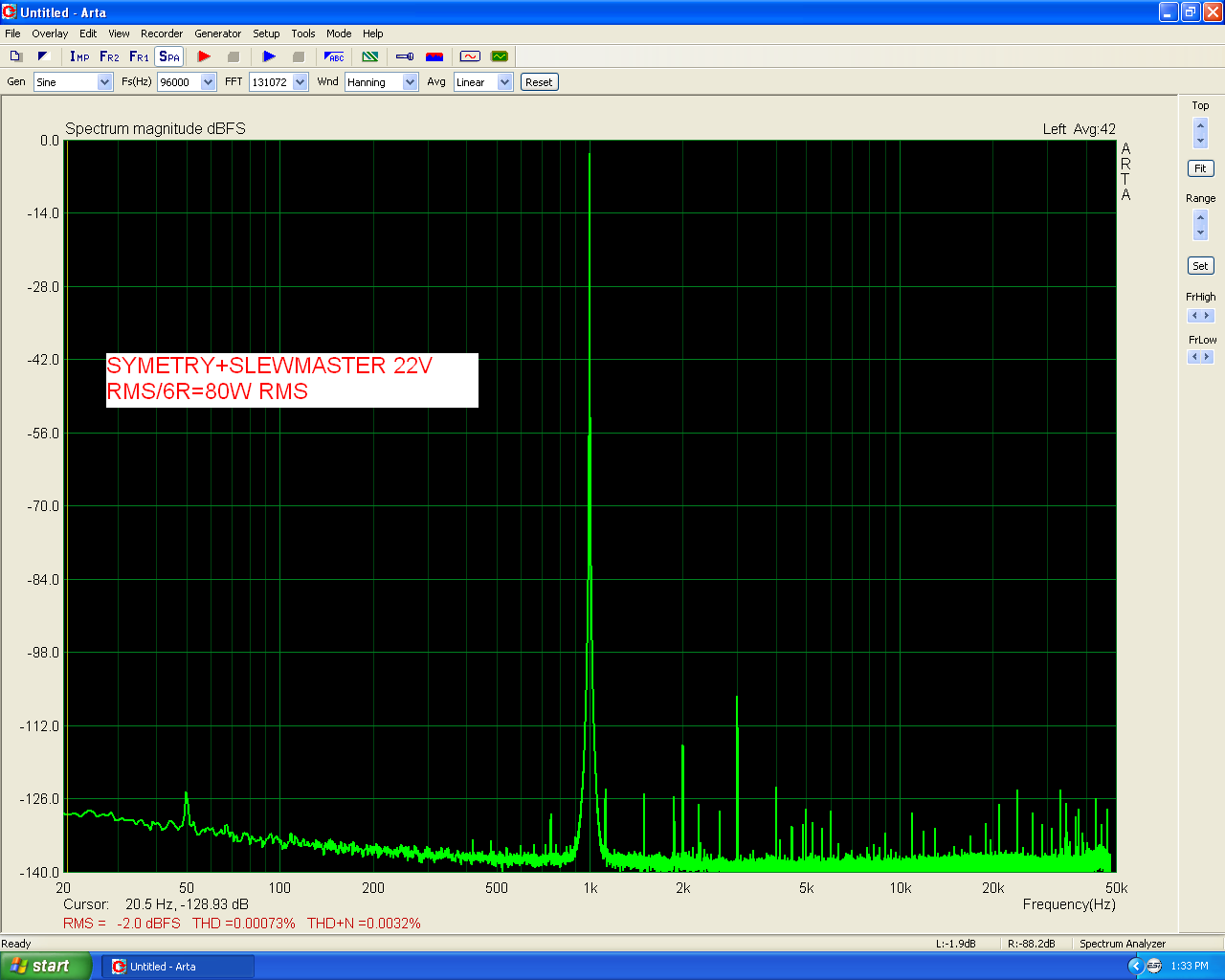

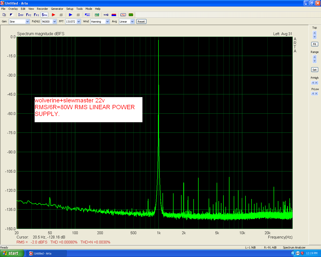

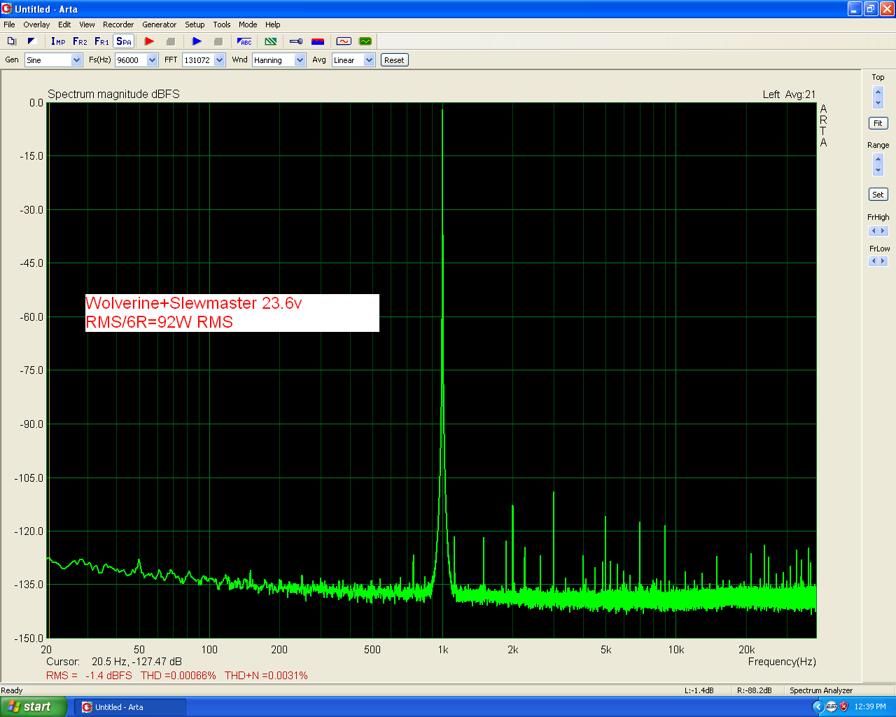

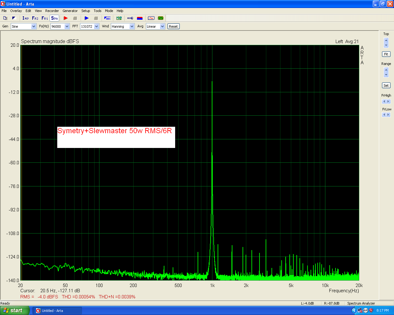

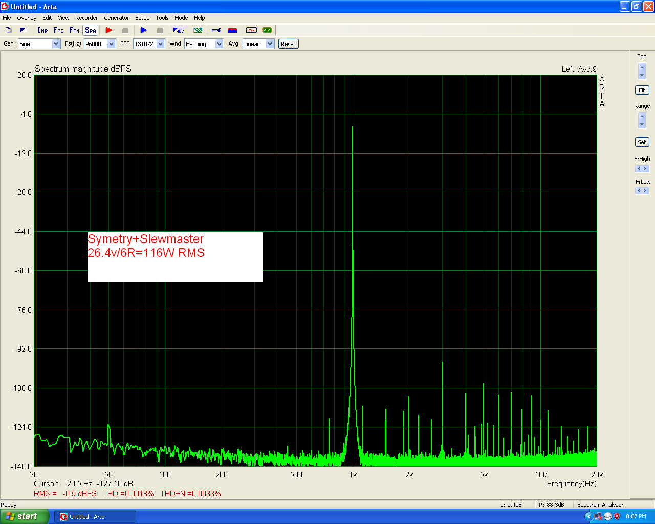

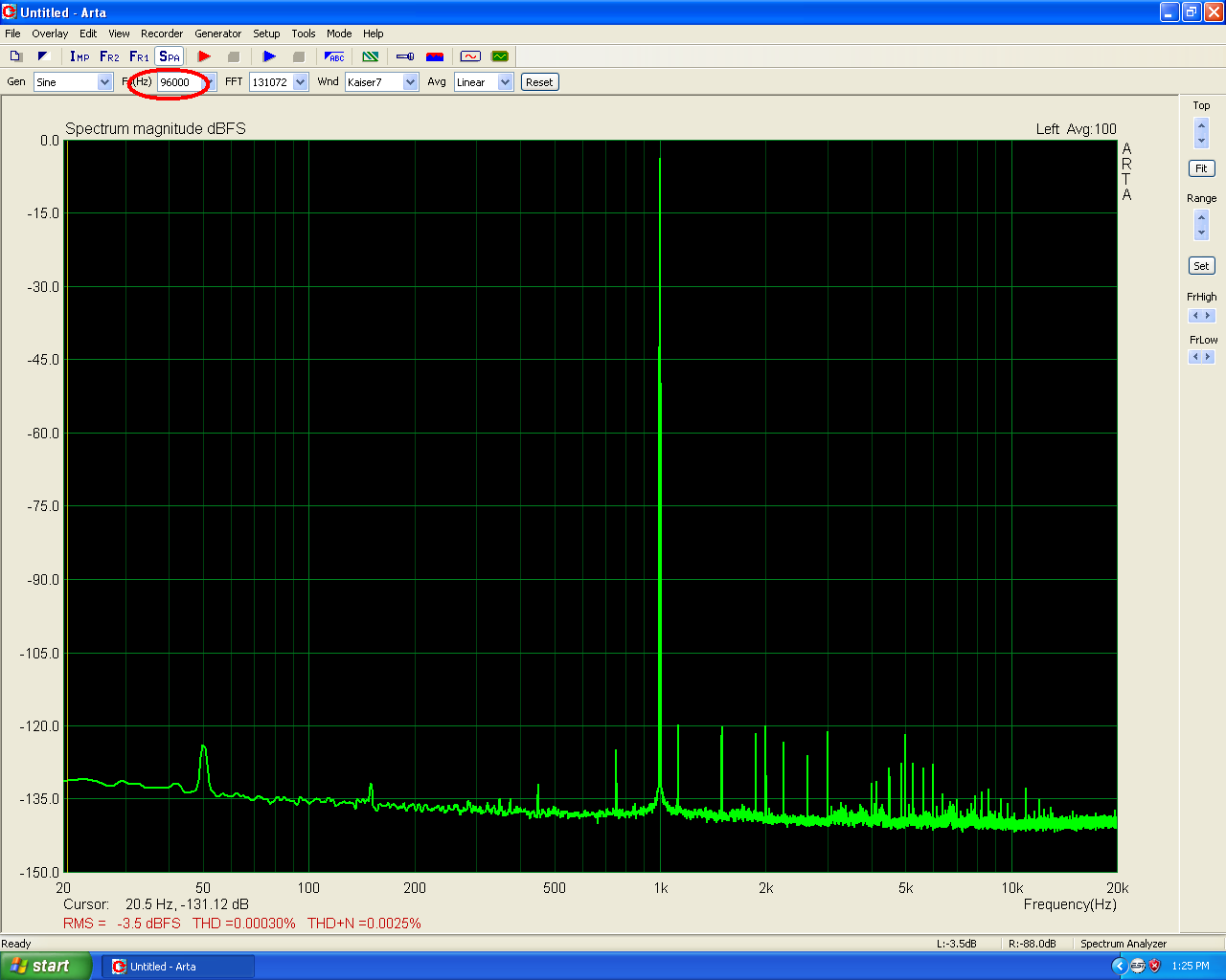

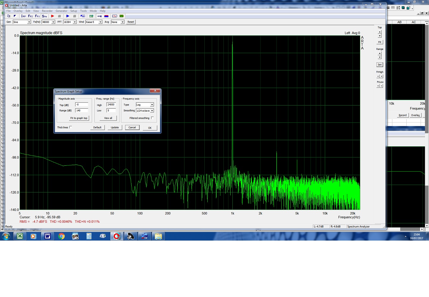

Some real measurements using Esi Julia pci.
1,2,3 Symetry+Slewmaster amplifier
4,5 Wolverine+Slewmaster amplifier.

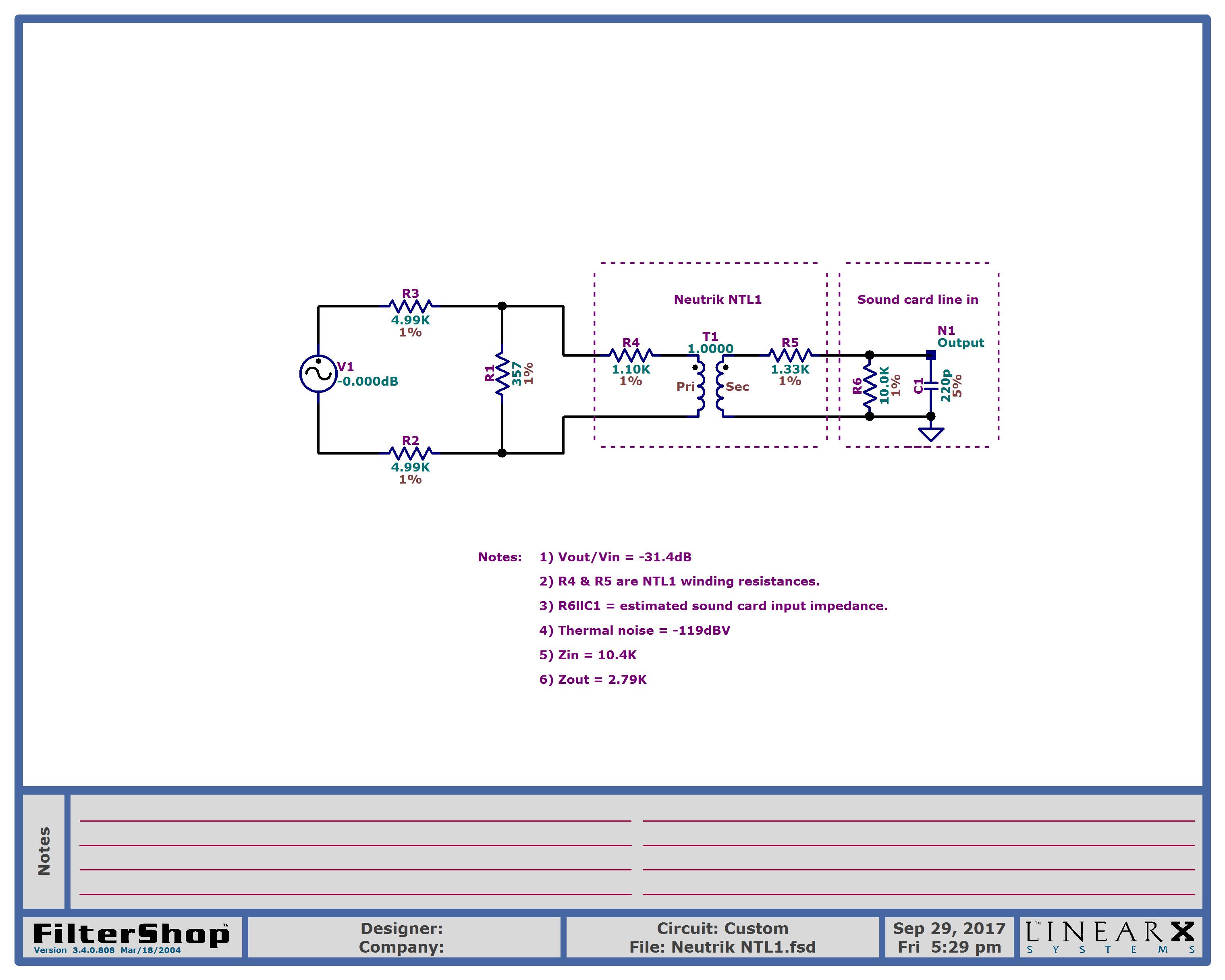

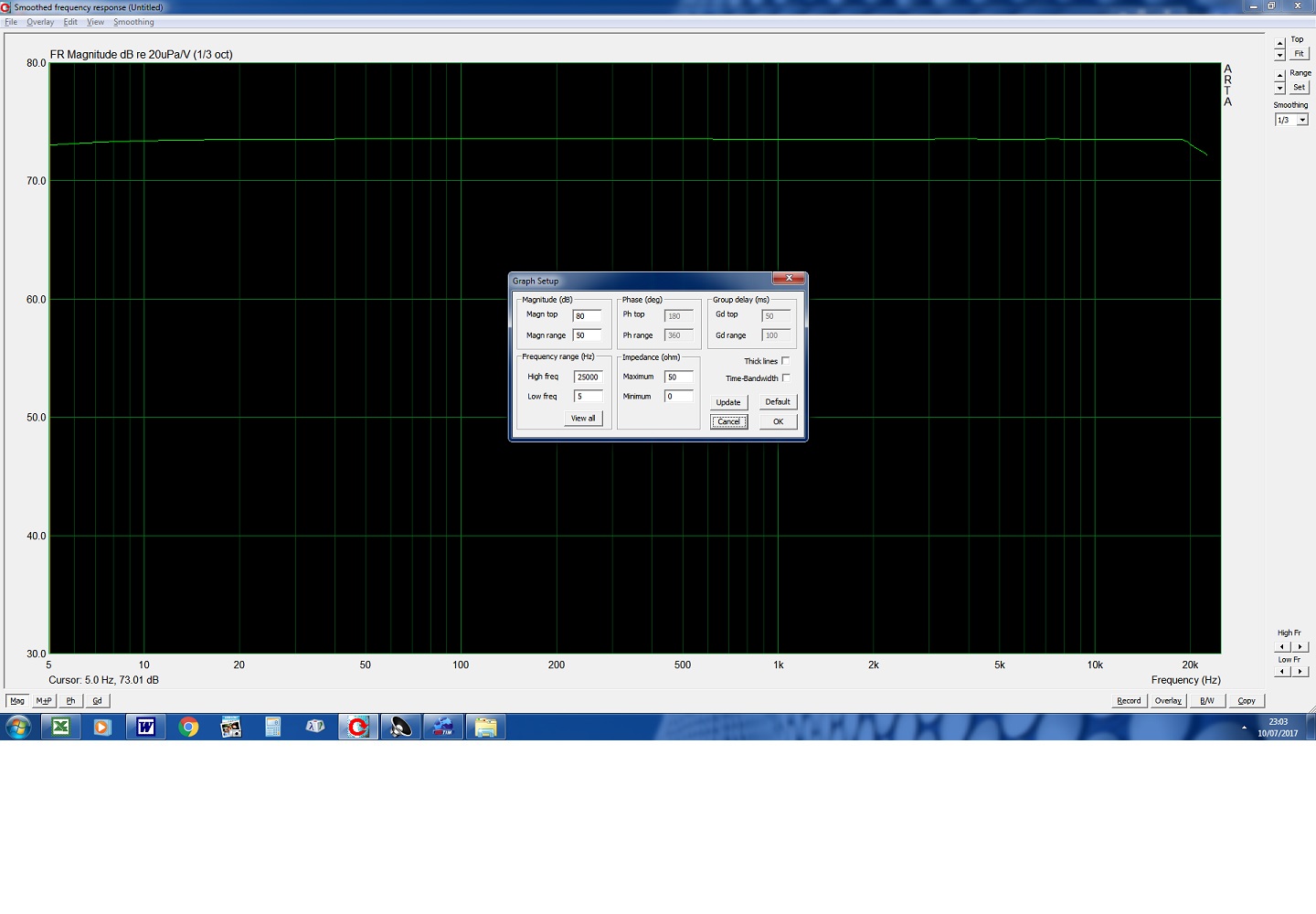

Hi rich08,
Of the list of Neutrix transformers that Aczern cited, I think the NTL1 would be my best choice simply because its rated maximum input level at 50Hz /1% THD being +19dBu.
At 20Hz, the THD at levels common to computer sound card inputs should therefore be very low. Since the turns ratio is 1:1, an input attenuator will be necessary if testing of high power audio amplifiers is required.
I haven’t actually tried this transformer but simulations on the circuit shown attached shows good performance. Hope this helps.
Peter
