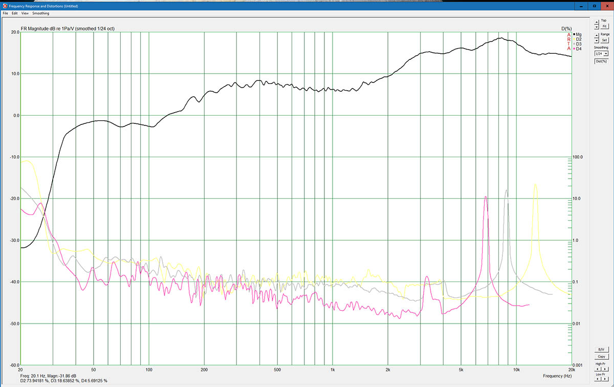

You may have answered this question before, but this is my present problem:
I tried different microphones, measured different tweeters, even tried different sound cards. The three 'chimneys' always appear at the high frequency end of the graph. In STEPS, they are not there.
Can you please help me out? Thanks ahead.

Please try callback measurement off soundcard IR. Then send me both pir files.
It looks like some kind of pulsive interference exist.

I got these strange THD bumps in upper mid- and range, too, even with ASIO drivers. They went away after clean setup of Windows.
Unfortunately I cannot tell if it was due Windows version change from 7 to 10 or because of too much accumulated garbage in sound driver stack due various soundcards I have tried previously, or something else.
Also, I stopped ever using WDM because it tends to give very unstable measurement results (at least in my setup), which is recognizable as extremely smeared impulse response.
Currently no problems. Thanks for continuous development, Ivo!

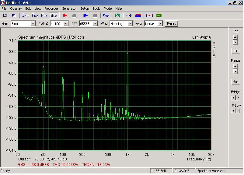

Hello,
I' ve been using ARTA for speakers measurements and I'm grateful for this tool! Lately, I tried to use it for audio equipment too but I stumbled on a problem that seems to be related to the latest posts. At the pic you can see low frequency peaks that from first sight look like ground loop or psu ripple noise. But it isn't. This "noise" cannot be detected by audacity or my 94db/W/m speakers. It's only there in ARTA. ARTA limp works perfectly.
I use an asus essense stx ii audio card with official asio drivers and windows XP. All windows sounds are dissampled and no windows settings can be done with regard to sound. Only audio device in this computer is asus/asio. Do you think this phenomenon could be happening because of software incompatibility?
Regards
Kostas

What measurement is this? Loop from imput to output of soundcard? or Any gear in between?
Considering the low levels involved, if you measured some gear, i would say its psu is really bad...🙄

It is surely a hardware problem (soundcard noise of ground loop induced mains signal). I need more information:
- did you made measurements with loopback connection of soundcard output with soundcard input channel.
- does input is configured as mic. or line input (maybe it is mic input).
Best regards,
Ivo

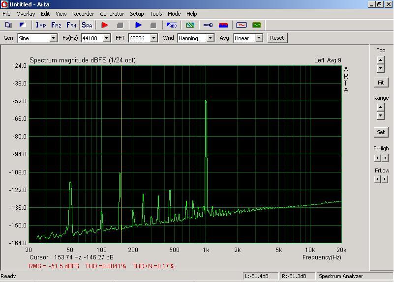

Thanks for replies!
My initial thought was also hardware problem. The sound card has been severely modified. I'm checking on this too and by no means I would like you to put any effort troubleshooting it. The output signal is very low level - 2 ohm I/V resistor directly from PCM 1792 7,8mA pp output. Input is line level. The above pic is with a 6x preamp in the loop. Measurements are not calibrated. Below I attach a DAC out/ line level input loop measurment. Nothing impressive, just DIY fun. But I have a strong feeling that this is not actual noise. If this could reach my speakers it would move the furnitures. And audacity loop recording at idle -no signal- is a DC flat line. Not so with ARTA.

Hi, MagicBus
if you put preamp in loopback, the you have to decouple preamplifier Input / output ground, as I do in ARTA box. Practically, do not connect ground on input channel.
ARTA can't make hum.
Best,
Ivo
Best,
Ivo
Yes, I've tried this and much more workaround for ground loops. I keep that it can't be software related and from there on I'll fix it. Thank you very much!
