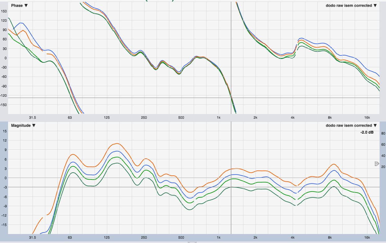

fwiw, I've come to believe it's not worth spending much on a mic for any kind of home audio work.
Here's some mic comparison measurements to help explain why.
(Just took these from a speaker i'm currently working on.)
Bottom dark green trace is an Isemcon 7150 with its supplied calibration file.
The light green is same mic without the calibration curve.
The blue trace is an ECM8000 without calibration.
Orange trace is another ECM8000 without calibration.
(i bumped them apart and used 1/6th smoothing for easier comparison)
There's just not enough difference between those traces to matter ime/imo.
About a year ago, i was able to compare my Isemcon 7150 to a matched pair of Earthworks M30's via transfer functions, at a measurement workshop.
There were simply no differences worth bothering over.
I should add the Behringer ECM8000's have had 15-20 years of use, often on a boom out in the sun and wind. Seems like they hold up fine.
I got the Isemcon about 6 years ago because it has a very high SPL capability that helps with PA builds, and i wanted a better mic to compare my cheapies to.
Was happy by the comparisons back then (and now).
So I can't see the need for spending money on a reference mic, unless you have some business need or something....or just plain want to..
And imho, knowing what we are measuring to begin with, and the limitations inherent in the measurement.... makes far more difference to the quality of our tuning than how good our mic may or may not be.
Just my 2c....
Just my 2c....
