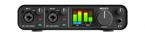

What about the MOTU M2 Desktop 2x2 USB Type-C Audio/MIDI Interface?
Is anyone using it or the MOTU M4 with ARTA and VituixCAD?
You would have to use the other high-ohm input on the front panel for your Dual Channel use (..1st if for mic., 2nd is for dual-channel input).
I do believe that the inputs and outputs are Balanced though - so there shouldn't be a miss-match.

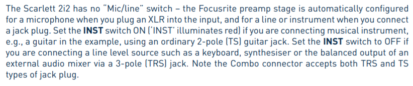

Do you use an XLR-connector on the cable, interface-side, and is the wiring OK? The 2i2 only takes mic input at the XLR sockets, the 6,3mm jack is line level only.
Yes, cabel is XLR-male to XLR-female, the input switch is set at "LINE", should it be "INST" instead?
I ran a measurement today with my Scarlett 18i20 with the output volume set to give a reading of about 70dB (at 1m) and REW set to output the sweep at -12dBFS, I have the mic gain turned all the way up and get readings of somewhere around -25dB back into REW. It needs to be at this level to leave headroom to record at a louder SPL, with it set like that I can measure up to 95 dB SPL. The levels do not need to be up at -12 to -6dB for REW to measure correctly. You will get a warning if the recording level is too low.
Reading it again it makes sense. Acoustic noisefloor under normal conditions will be around 30-40dB (flat). So the mic inputs don't have to be much more sensitive and with recording you'll need headroom up til 110dB or more. Measuring at 60dB isn't the best either, it only leaves you about 20-30dB S/N ratio, so measuring distortion or acoustic slopes becomes unreliable. Speakers should easily do 90dB on 1m. So turn up the volume.
