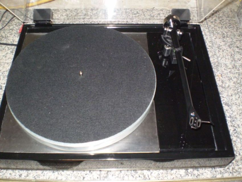

Well I made my armboard. I used a piece of 10mm black acryllic and I drilled 3 holes and tapped them to accept 10-24 thread. Then I used 3 x 10-24 x 1" bolts and cut them down to 3/4 "threaded rod. Then I secured them with Loctite red. I had to drill out the existing holes in the subchassis to accept this larger threaded rod. I thought about using a helicoil or time-sert but they are generally longer then 10mm and I didn't want the bolts protruding through the top of the arm board. I have secured the board on with locknuts and just have to be careful with how tight I torque them up. I can get it atleast as tight if not tighter than the original wood screws. When I'm setting it up for good I may consider a layer of silicone caulking between the two surfaces.

I just finished the armboard and did a test fitting. The Loctite didn't hold the studs very well. Two of three unscrewed so it now it's time for industrial epoxy. We'll see if it holds.

Well, it looks great, I must say. Sad to hear you're having problems with those studs; I'm surprised that the loctite didn't hold them in - it sure used to hold my motorcycle together! Maybe it doesn't work so well on acrylic. Or is there a chance there is some oil or other dirt on the acrylic or on the studs?

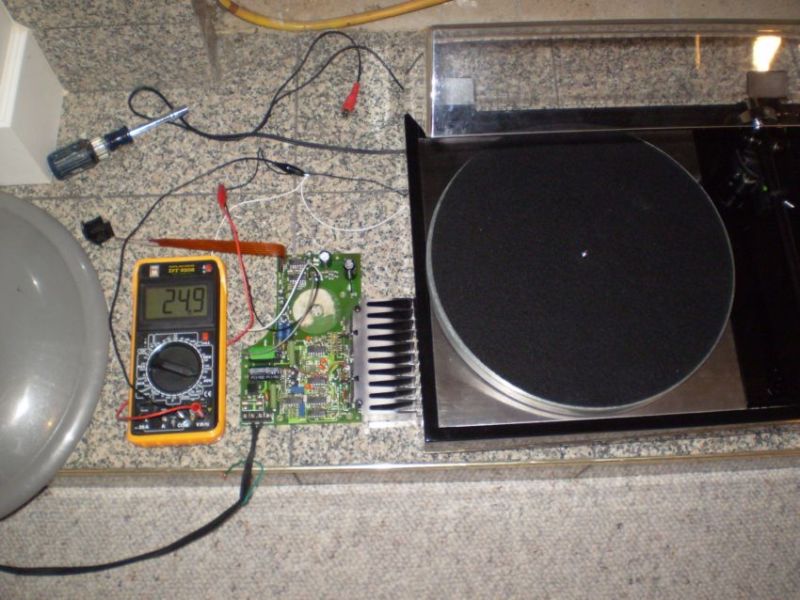

Here is the first test run. Axis motor removed from ps and installed on Ariston. Speed control is steady with ps in quiet mode running at 24.9 VAC. If you purposely slow the platter down it quickly jumps up to almost 80 VAC and then slowly settles back to 24.9 VAC. I tried this same power supply on my LP-12 but it wouldn't maintain speed. Everytime it switched to quiet mode the speed slowed just enough to cause the servo to fire back up to high voltage. Possibly the windings on the LP-12 motor draw too much current for the Axis power supply or possibly the Axis motor is designed to maintain higher torque at the lower voltage. Either way it means my LP-12 stays with its Valhalla or else I build a "Lingo" type supply and project Ariston is one step closer to completion.

The Ariston is now functional. I have the power supply jury rigged to the motor and I have a Rega RB250 arm with OL1 counterweight and VTA adjuster attached to the acryllic armboard. The cartridge is an AudioTechnica ATF3/OCC moving coil. I have been listening through a modified Musical Fidelity XPLS which is a good MMpreamp and a decent MC preamp. So far things sound pretty good. Presentation is quite a bit different than my LP-12/Ittok/AT-160ML MM cartidge. Bit brighter and more air and space.
