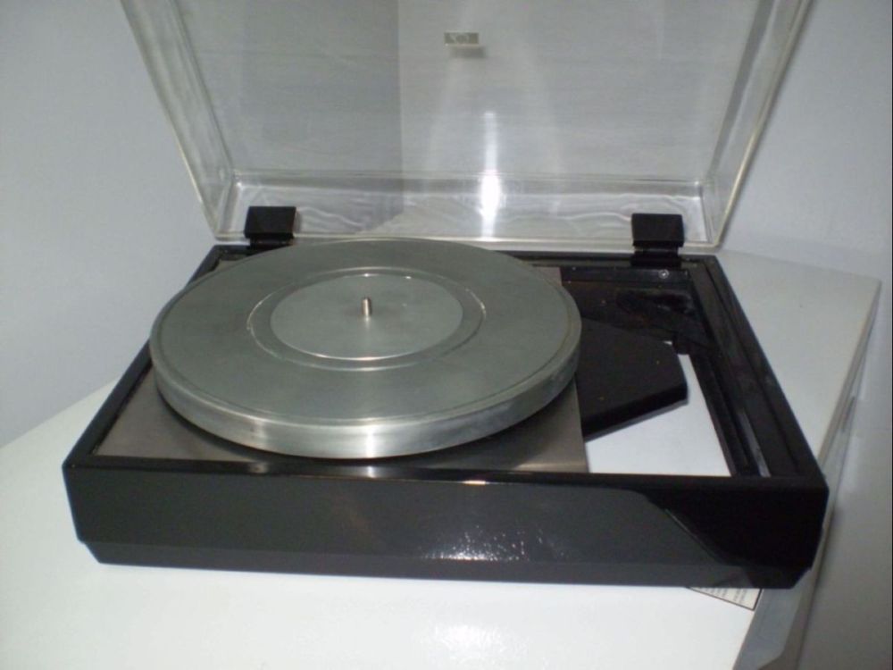

Well I got some work done on my Ariston this weekend. The top plate was machined to fit the Linn subchassis. The Ariston platter was machined to fit on the Linn subplatter. I put it together to see how things fit together. Now I need to get an arm board or else make one. I'd like to try the plexiglass/acrylic which someone else on the forum made.
Hi tkwou;
Looks good, I see your o-ring record supports are nowhere in evidence 🙂
Your plinth looks interesting; I don't recall you mentioning it. Is it wrapped with something?
May I ask where you had the platter machined, was it in Vancouver somewhere? Were you satisfied with the work done?
With regard to the armboard, black acrylic would look nice. Is there a feeling that acrylic is an improvement on (painted) MDF or some other sort of fibreboard?
Your postings are keeping my spirits up and ready for tackling my own when I get home!

Hi Bozini
The plinth is original Ariston but I refinished it in piano black to give it a more modern look. The platter and top plate machining took less than a hour of shop time. I had it done in North Vancouver. Fits just like a Linn now. The Linn springs are similar to the Ariston's they just have a higher spring rate so the resonant frequency will be a bit higher but I thinks the Linn subchassis and arm board are heavier so this lowers the resonant frequency, so overall there might not be that much change.
