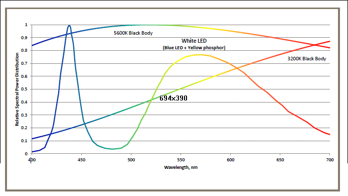

If that is the case, then either the wavelengths of the LEDs don't match the eye, and/or the Q is a bad mismatch. Don't most modern white LEDs use a phosphor to great broad spectrum? They aren't actually RGB, are they?
Indeed, most white LEDs have a blue LED die and phosphor to convert some of that light to longer wavelengths. Apparently this is far more efficient than combining RGB LEDs to white. The phosphors used for LEDs are related to those used for fluorescent lamps and hence have the same disadvantages.
Source: this article on white LEDs by Mike Wood, from it also comes the attached spectrum of a cool white LED.

I am not too sure about this statement "Indeed, most white LEDs have a blue LED die and phosphor to convert some of that light to longer wavelengths. Apparently this is far more efficient than combining RGB LEDs to white"
The problem with mixing Red and Green/Blue led's together is that they are constructed of different semiconductor materials, so they require a diffrent drive voltage/currents. Yes you can put them in series and deal with this but this is not the way one operates an RGB type led, they are driven separately.
To rationalize, my thinking, a blue/green led is made using of similar semiconductor materials, GaN, where as a red is InGaP. The phospher has some degree of quantum loss, so how can it be more efficient than the plain source itself? using Royal blue leds'/phosher is just an easier way to make uniform light from a mono-chromatic source.

I quote from the article that is my source: "Today it’s typical that a white LED will be at least two to three times as efficacious as a mix of colored LED s in producing white light. This means that with pastel colors, even with a piece of gel for subtractive color in front of those white LED s, they are likely still more efficacious than an additive mix of colored LED s."
This article is a year old, so white LEDs may have progressed even further since then.

This is not the reason why a blue LED with phosphor is more efficacious than a combination of R, G and B LEDs.
The simple fact is that a blue LED + phosphor converts energy to an approximation of white light more efficiently than a blue LED plus R & G LEDs.
Blue LEDs are very efficient. Phosphors are very efficient. R & G LEDs are not.
