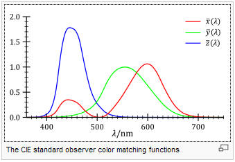

Just for run, look at the red response curve of the eye. Notice anything odd? Can you guess what it does?

That's because the bands overlap, red & green quite a bit. If they didn't there would be gaps. There is a huge library of research on this going back decades.
Do you mean violet that means stimulation of both red and blue sensors?
I don't buy it. But I agree it is the way to fool imagination.
Yes, violet - how do we see it? And why is it often confused with purple?Do you mean violet that means stimulation of both red and blue sensors?

Since there are no real yellow sensors in the eye, we must see it as green and red sensors both lit up.
